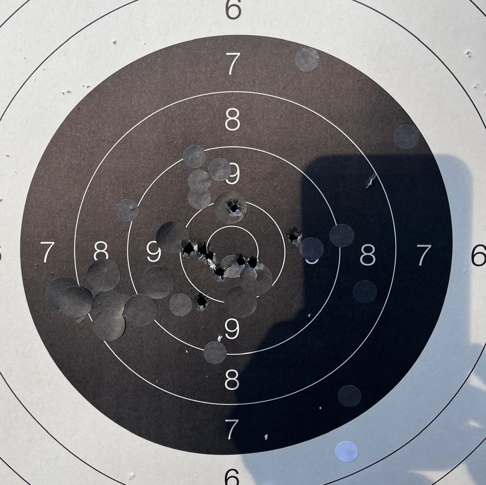

We did more tuning today before range. 290m/s (951.4 fps)setting, and new scope zeroed. Hits accurately. Well as good as flimsy table and crappy sandbag allows to.
50 meters first grouping.
Gun feels amazing, shooter is just bad.

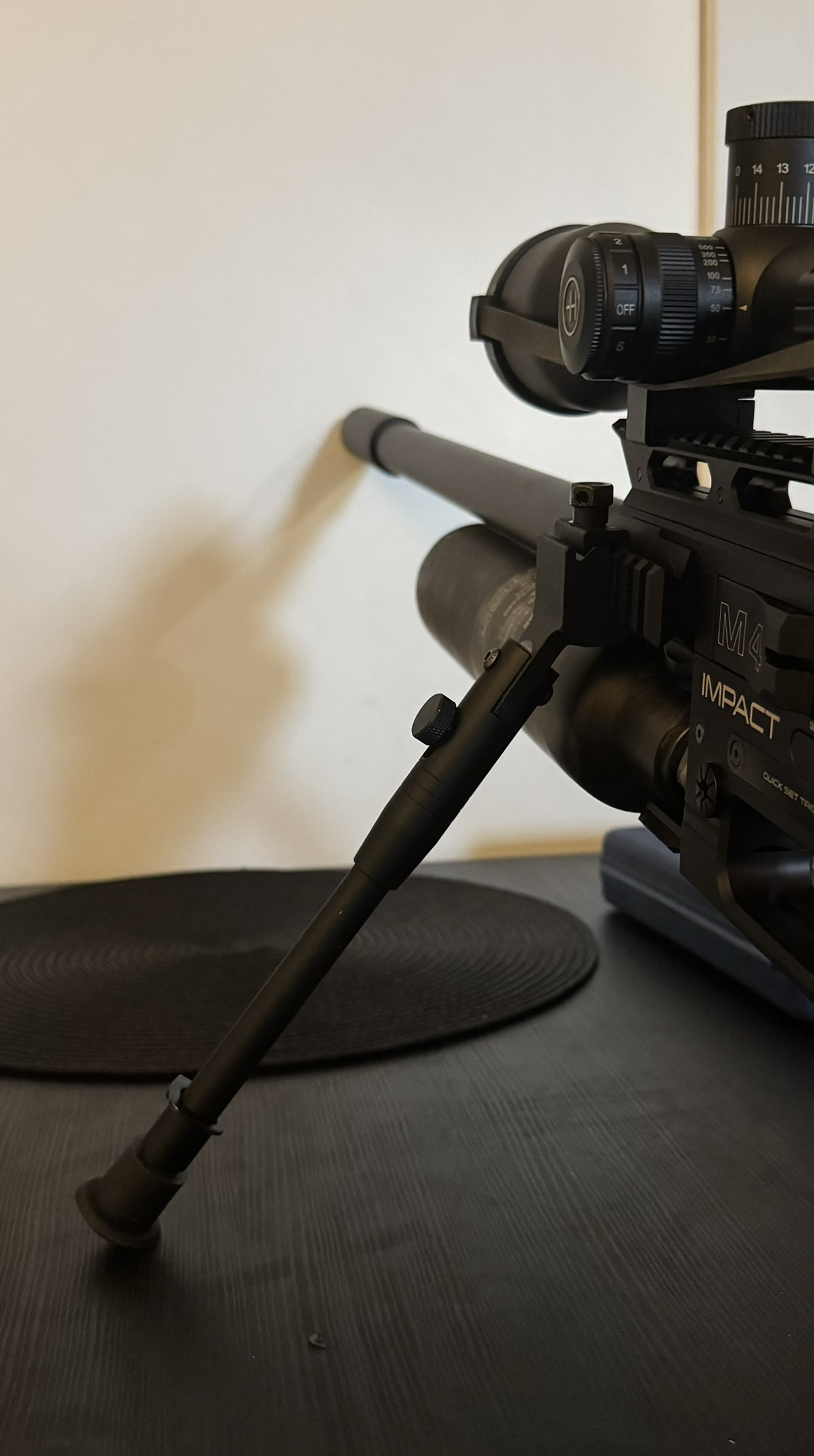

Been annoyed to hell and back since I would like to have top mount bipod, and if its under rail attachment, then 45 degrees lean on legs, but all of the options adding weight and unwanted moving parts.. Then I had an idea.. I had my sons backyard blaster Gamo HPA MI IGT and started to wonder.. They are amazing! Even cheapo but quite good giving that topmount bipod features a bit and even they a bit flimsy compared to 500e legs, they actually great. Good shooting height.
Reactions: coastal drifter
Pretty cool. If you're going to use it as a bench gun the extra weight of the extended top rail is actually an advantage. I too don't want a lot of extra weight.
Good looking setup Sir. Sidemount bipod adds that direct line of support towards the scope rail, and thats what I am after to. Also option to move them bit backwards to add space for pocket fx chrono. I have not yet field tested how the shift of CG is going to chance stability and accuracy.
