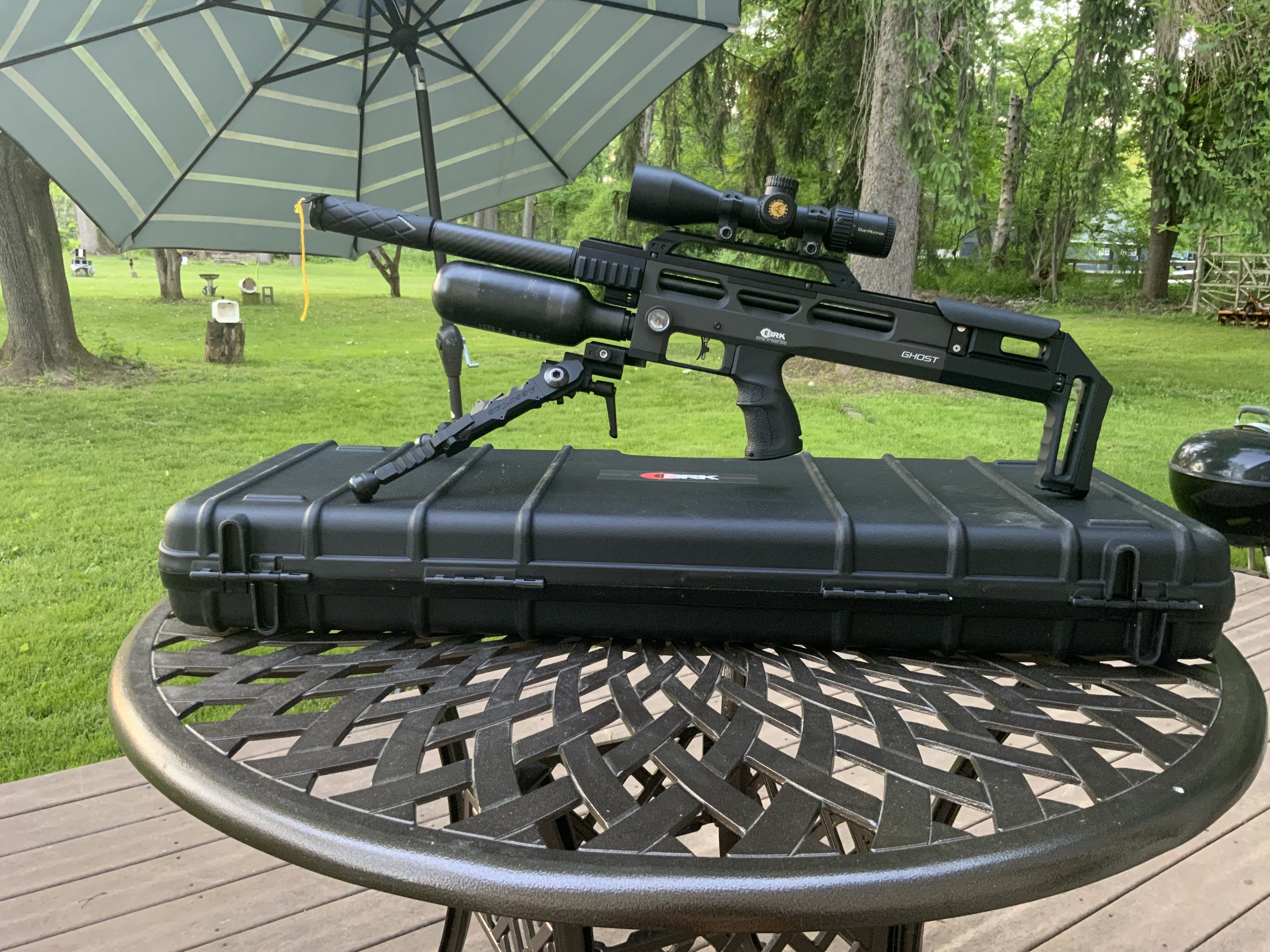

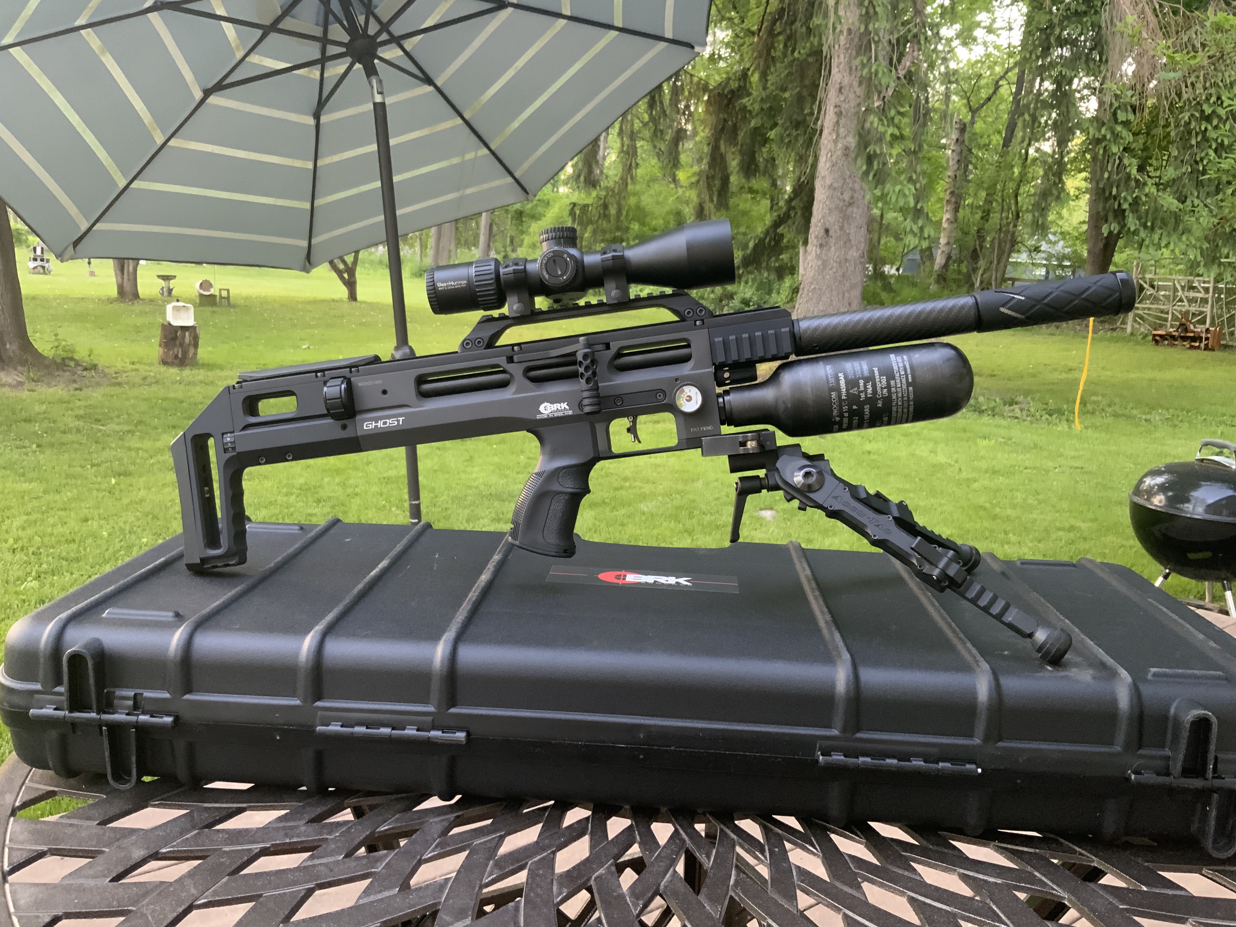

I have the Ghost HP in .30 and it is a completely different animal. Considering if I would swap out the Krait standard for a Ghost compact would be a tuff choice, but in the respect of being a compact and my targeted use for it, I would probably go with the Krait in this instance. Krait does not make a .30, so there is nothing to compare to. My Ghost is a mid size pest killer!
