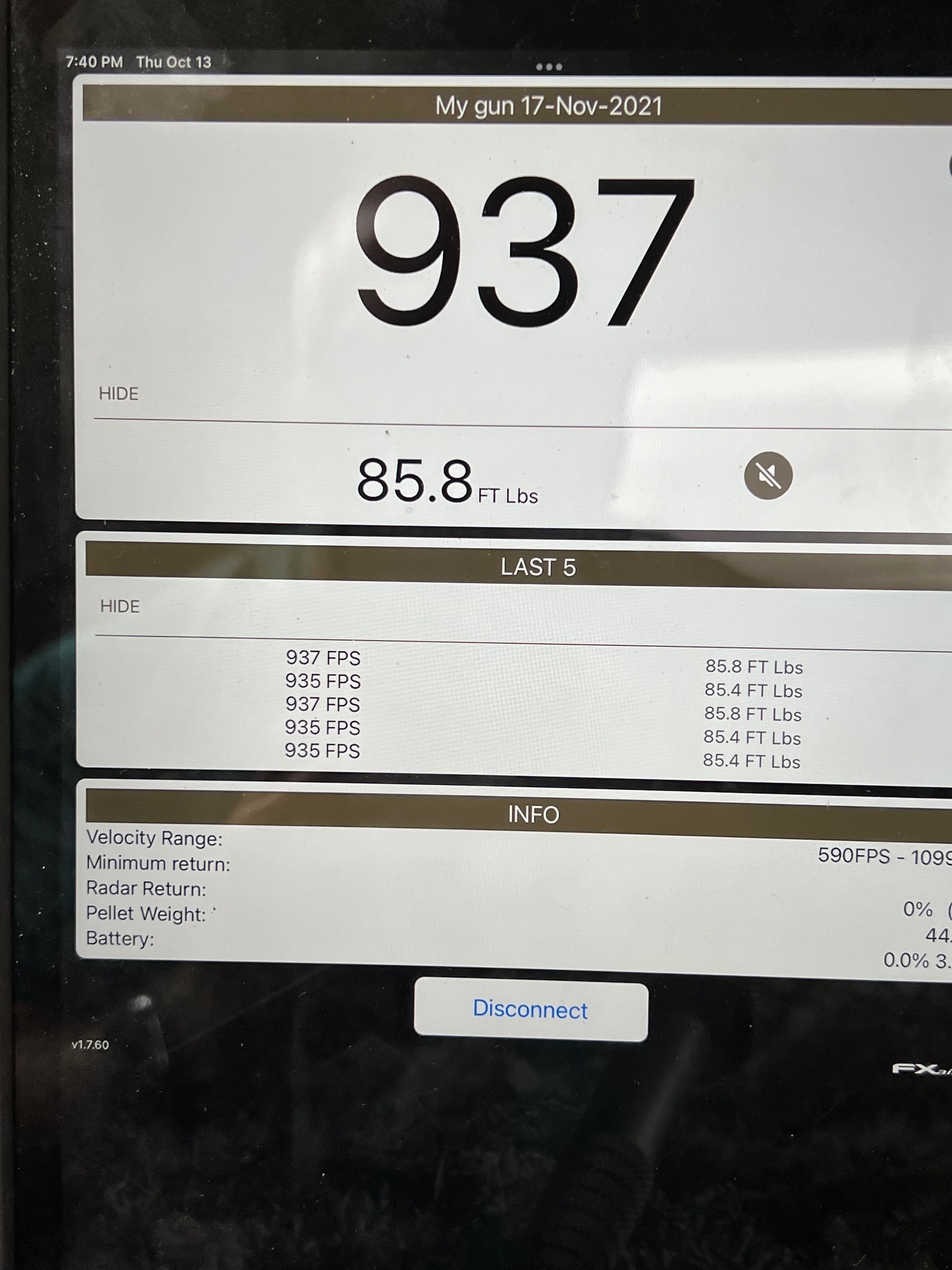

600mm barrel, 11g hammer weight, stock STX liner. Regs at 150/115psi. FX 34g pellets on PW7 at 905fps, and 25.4g Atomic pellets on PW5 at 915fps. Best groups are with the 34g pellets.

Compact here all stock internals. Can’t remember exactly where the first reg is. It’s 135-140 bar. Second reg is around 100 bar. I only really shoot 25.39 pellets. I don’t mess with the power wheel. I put it on seven and tune the internal adjuster to find the sweet spot for an extremely low speed spread for the given reg pressure. For the above given setup that is right around 900 fps with 25.39 pellets.
