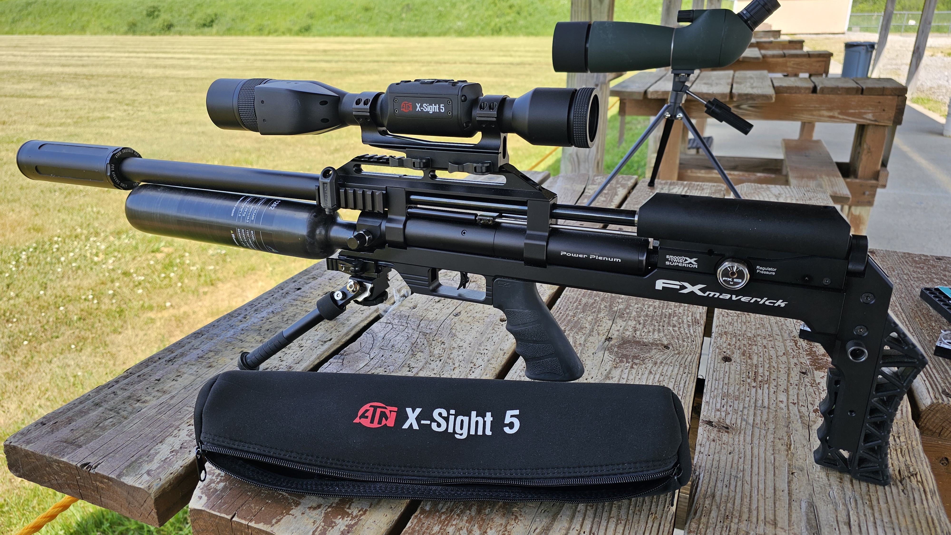

I also wanted a shorter barrel, but with the power the 600mm delivers as a decent compromise. The only difference is I bought an aftermarket bottle off of Amazon for $150 and bought the valve from FX-USA (R.I.P.) 😥 for around $50. That saved me a few coins. The only difference is I have a .30cal. I get around through just over 4 magazines with 13 rounds per magazine at 90fpe from 260bar to 150bar, shooting 44.5gr FX Hybrids at 940fps.

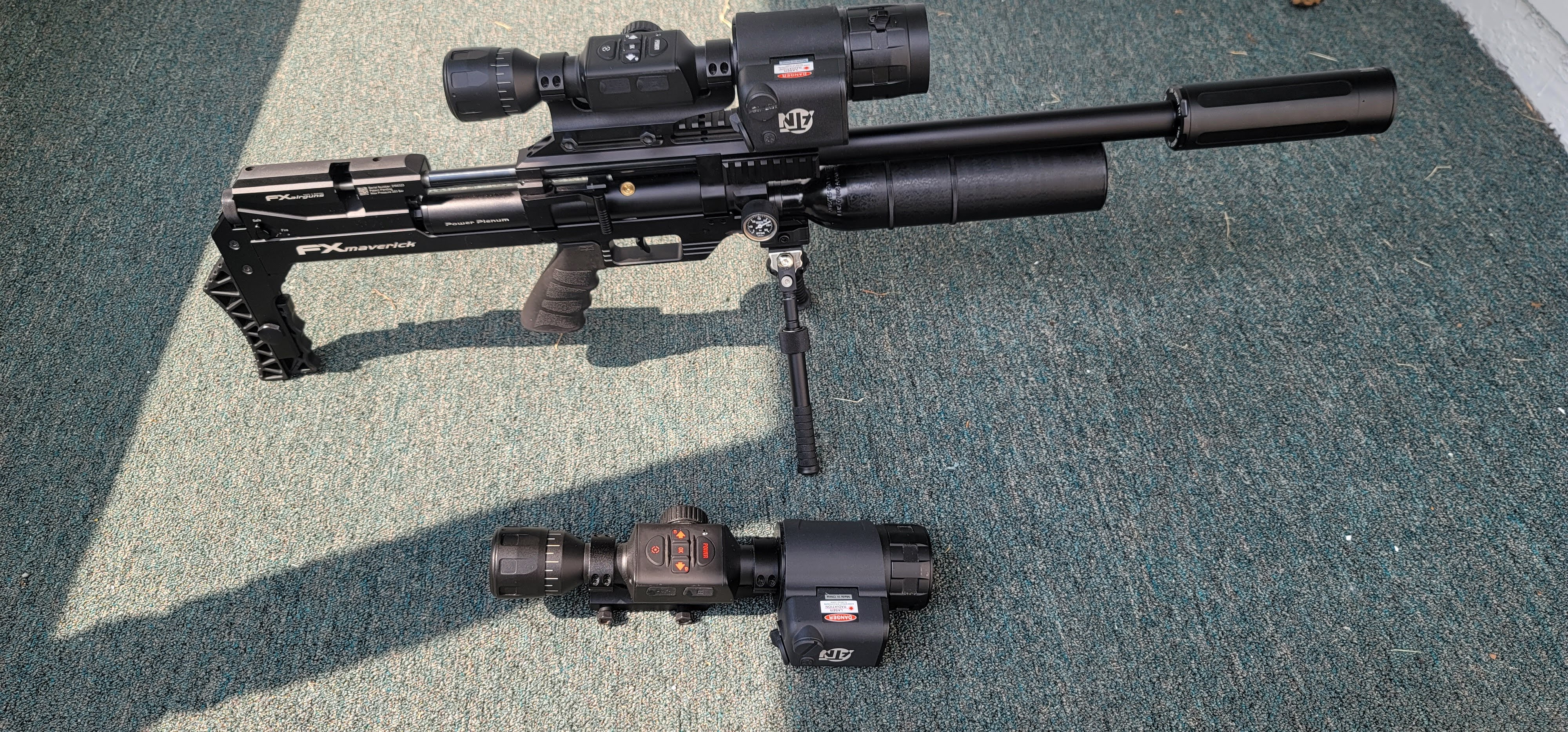

Thank you, I do not pretend to be an expert on them only because I've made enough mistakes of my own to learn, and fixing others mistakes, like one of the used Mav's I bought that the guy totally hosed and got going thanks to Bigragu assistance. That said, my .25 VP is a tack driver, doesn't matter what pellets 33.95 or Slug, 26gr RMR, good enough out to 125+ yards. The .22 Compact is good enough at the same distances with 22gr RMR/FX slugs or 18.13 pellets. Image is a cork at 100 yards. Technically 3 shots, first knocked it down but no hole, second was a miss third well slightly off center.
I can give you my awesome tune depending on what you decide. YMMV on the outcomes but will get you going.
Oh yeah shot count, you'll be bored before you run out of air. I lose track around 60 on both of mine.
Scopes are Arkens, love them even with old eyes. Top is showing it with a TriggerCam, but I swap between guns.
