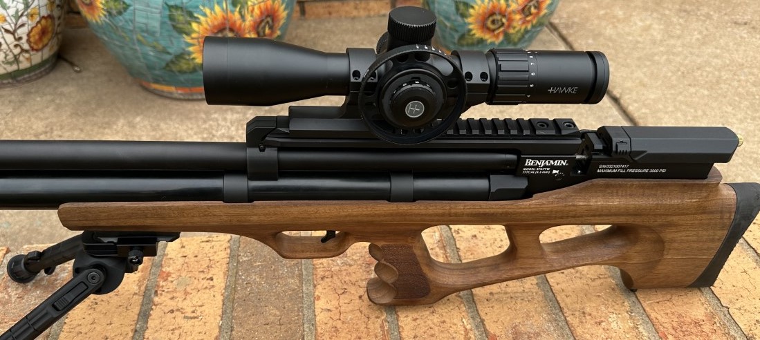

I have a Benjamin Akela in .177. It has a transfer port dial on the outside of the gun that is very easy to go from full power to decreased power probably about 150 fps difference. This gun is very accurate and very backyard friendly. It looks more like a Wildcat of course than the Mav, but is a really nice bull pup in walnut.
Reactions: DHart and L.Leon
