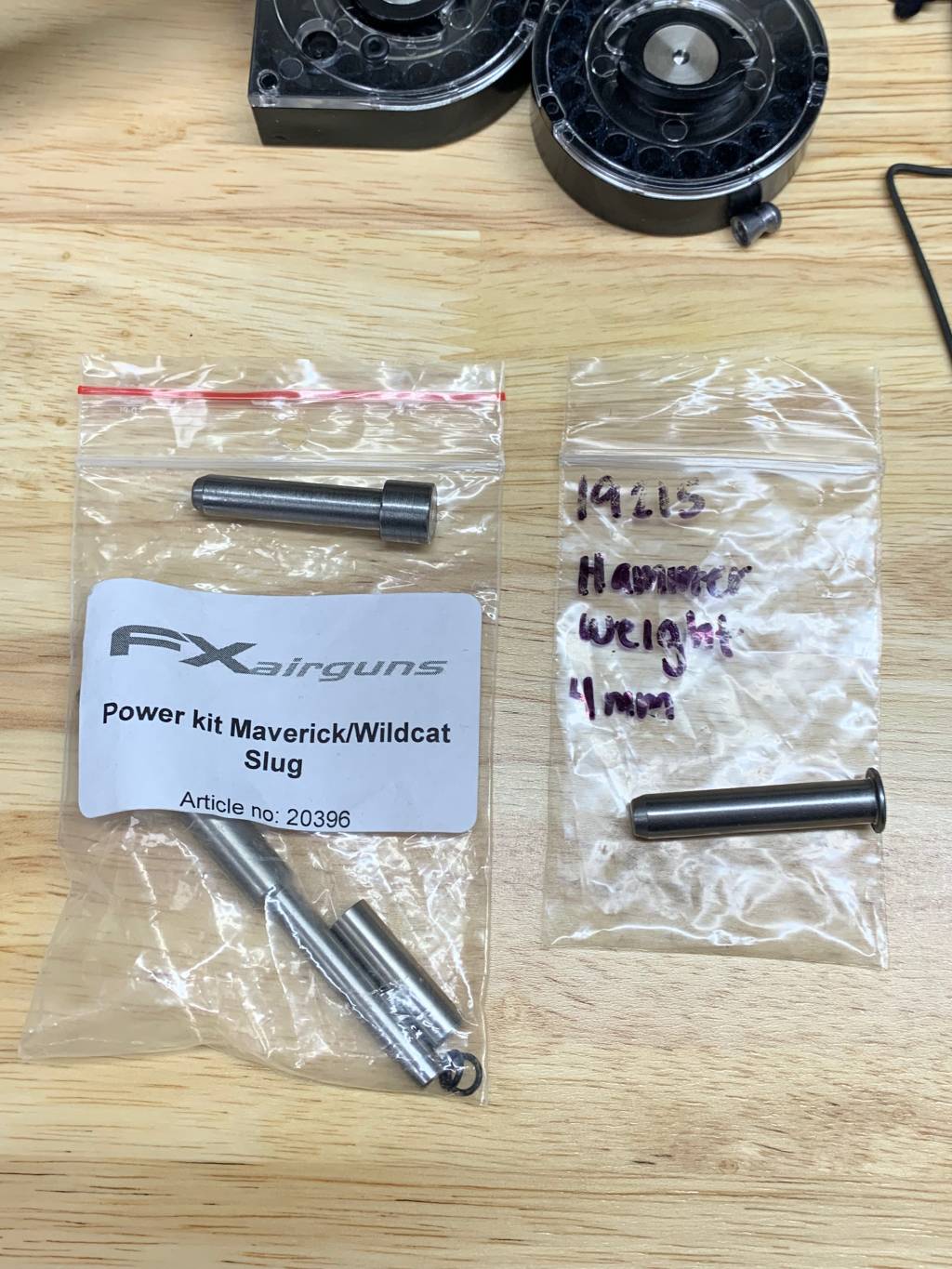

Call FX and order the medium weight hammer and then bump your second reg up another 20 bars, you can thank me later.
I already have the medium hammer weight in it. I thought it was the .25cal hammer weight. The one on the right is the stock version and the one on the left is the one that came with the slug power kit. The 4mm came from FX.
