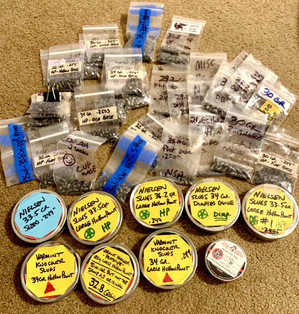

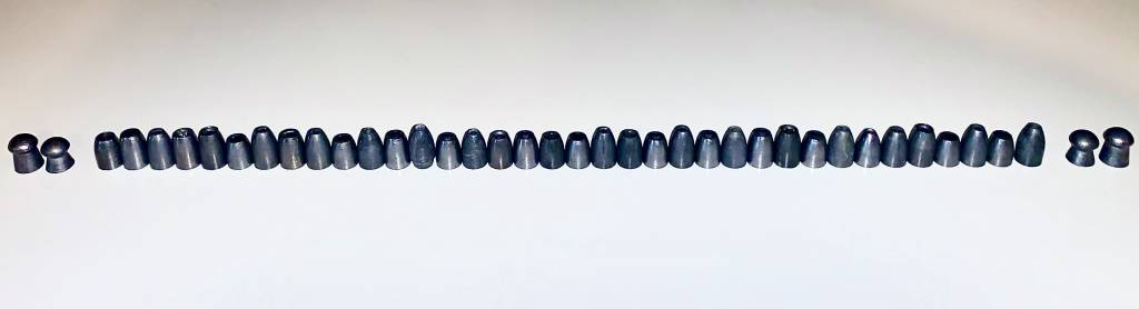

Slugs can be very accurate, have probably double the BC of the Hades, have far better energy retention and the soft lead - large hollow points creates devastating expansion on game animals. The Hades is pretty accurate inside 50yds but beyond that, they’re not the most accurate option available. Slugs are accurate at 30yds and 150yds, so you’re covered at any distance. I’ve shot a lot of slugs and don’t see any pass throughs, even on little birds, they just explode! Once you shoot a couple of birds or digger squirrels with a slug and see the damage they cause, you’ll be sold. Accuracy has gotten better and better with all of the different slugs available and the prices are now very reasonable, thats a big part of why so many people are using them for hunting or long range shooting these days. Give them a try, you’ll love the performance!
Below are just some of the many .25 cal. slugs I’ve tested over the past few years in the various FX slug liners and LW polygonal barrels.

Those slugs lined up is a wicked picture!
