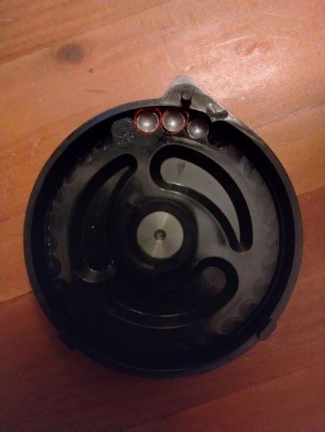

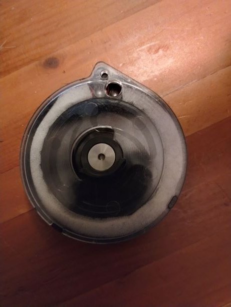

Proof of I was being serious in suggestions but I was thinking only in length lol if side to side wiggly find an insert to affix with adhesion or use nail polish to take up the gap. haha
If you take the time to cut a gasket out of a pellet tin piece of packing foam and lay it in the recess of the lid it eleminates all of the rattle but would cause drag in cycling which is why i was suggesting the cereal box type of a homade gasket on the top.
