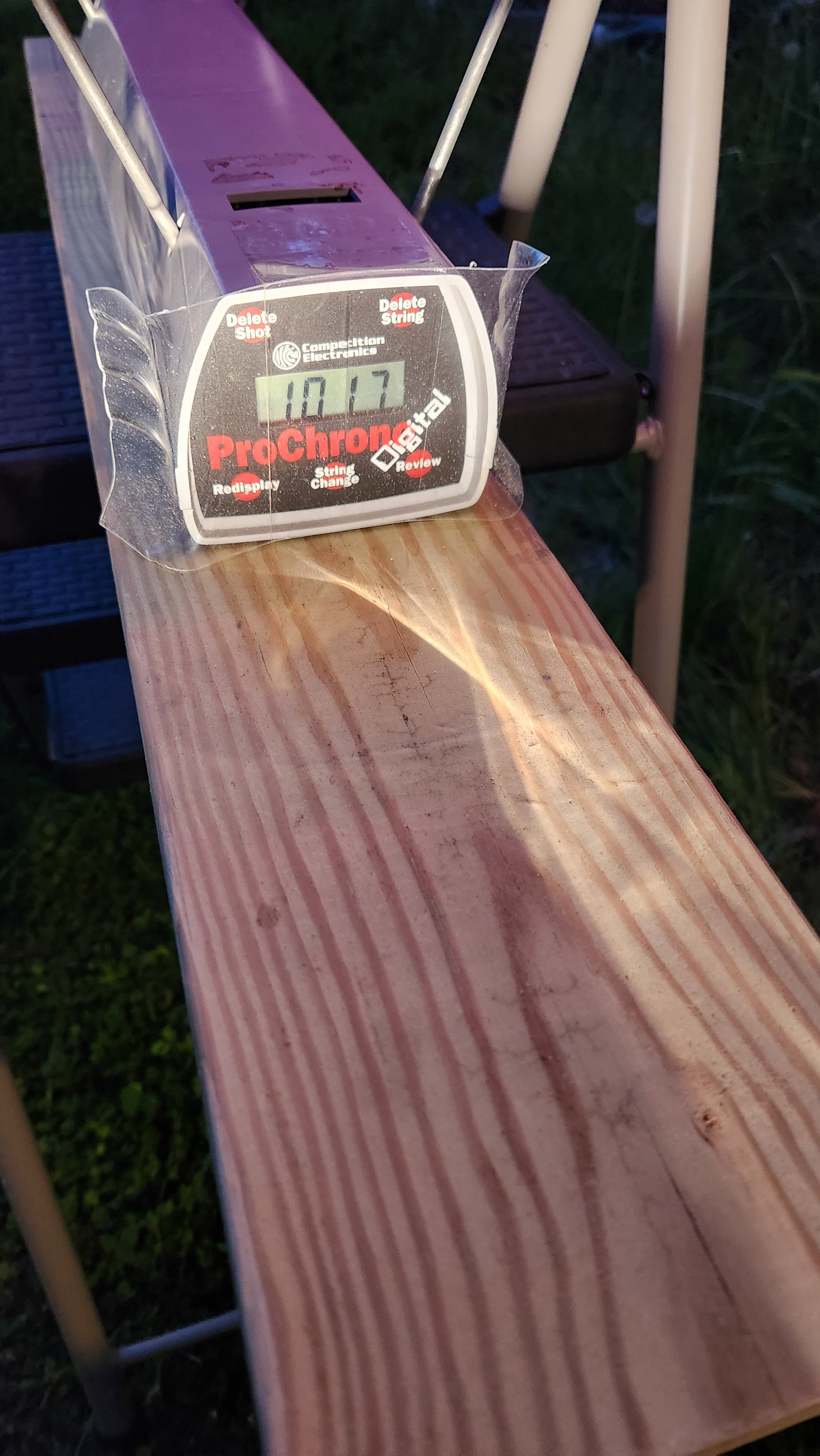

I delt with this too, .25cal Maverick. Stock weight was 11g. I ordered the HumaAir power kit [hammers and pin probe] and their spring; tried all manner of combos and ended up with the 14gram hammer without the little spring washer and the Huma spring. 175bar with final reg at 145-ish bar. Port is set to dual side and the pin probe. 1017fps 30.86gr H&Npellets power wheel 7. 33.5gr NSA slugs are 983fps on these settings. 71 ft•lbs
