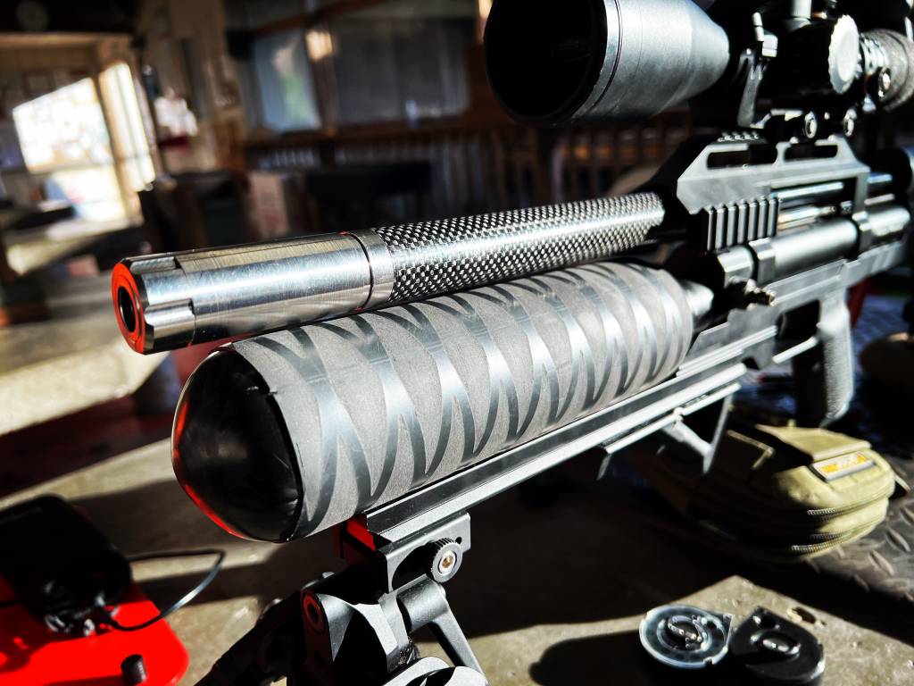

First, I made a crazy carbon fiber shroud with titanium end caps (aluminum would also work for this though). Thread link with the details - https://www.airgunnation.com/topic/anyone-interest-in-heat-anodized-titanium-parts-fx-maverick/#post-1190170

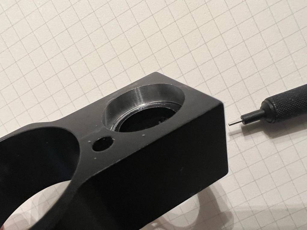

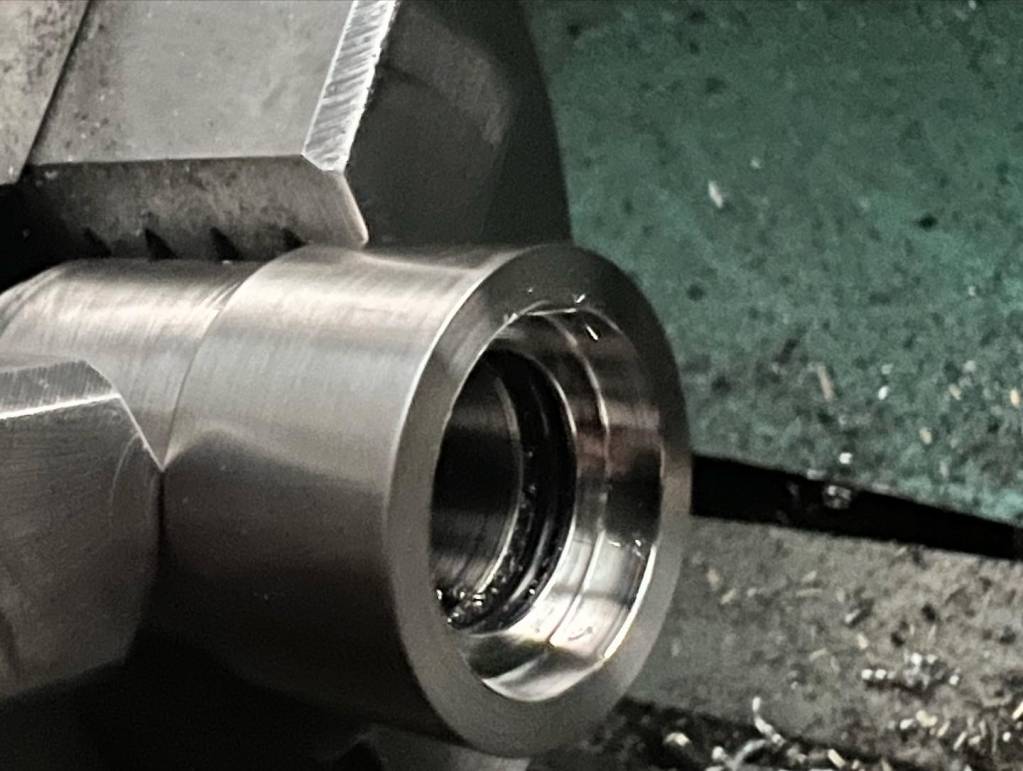

Then, I counterbored the front support housing to ~19mm as well as the rear end cap that had already machined (too lazy to make a new one)..

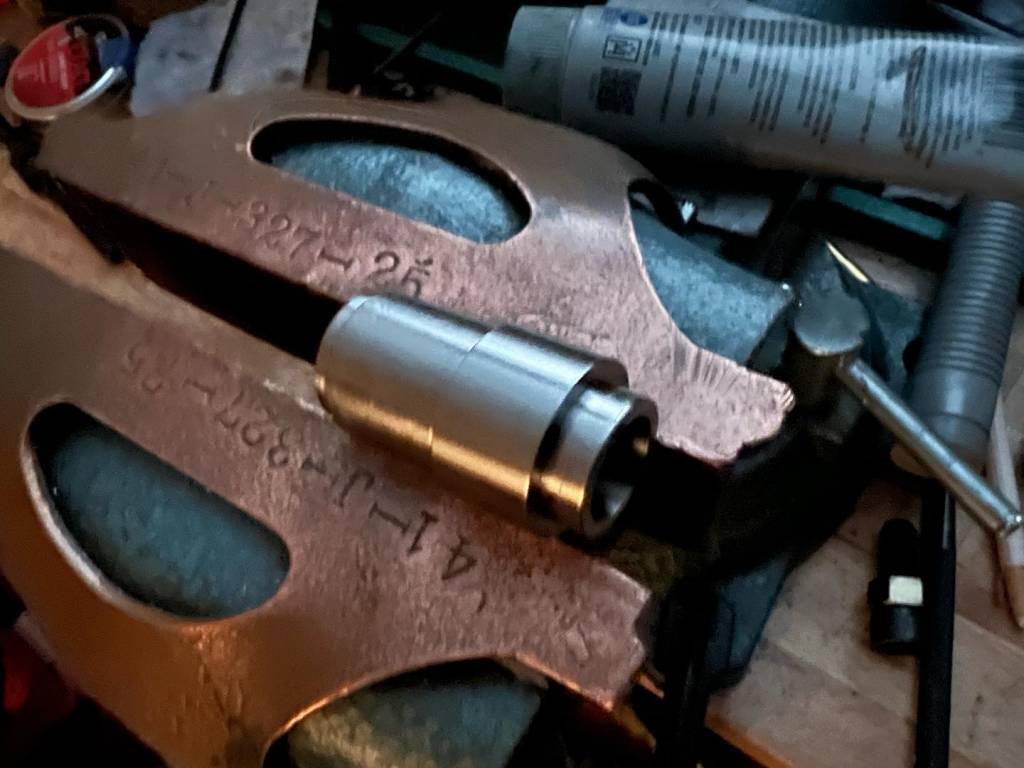

Then I made a bushing with a perfect 14mm press fit for the barrel bore and press fit for both the end cap and barrel support housing counterbores..
So when I thread the shroud on to the barrel, it tensions down just enough to make the barrel rock solid to the rifle. They literally become one solid piece when everything is connected. Here's a short video clip that I uploaded earlier to IG..

Last little mod is this titanium shroud extension. It's a pretty solid hunk of metal, but there's no POI shifts with or without it 😎
