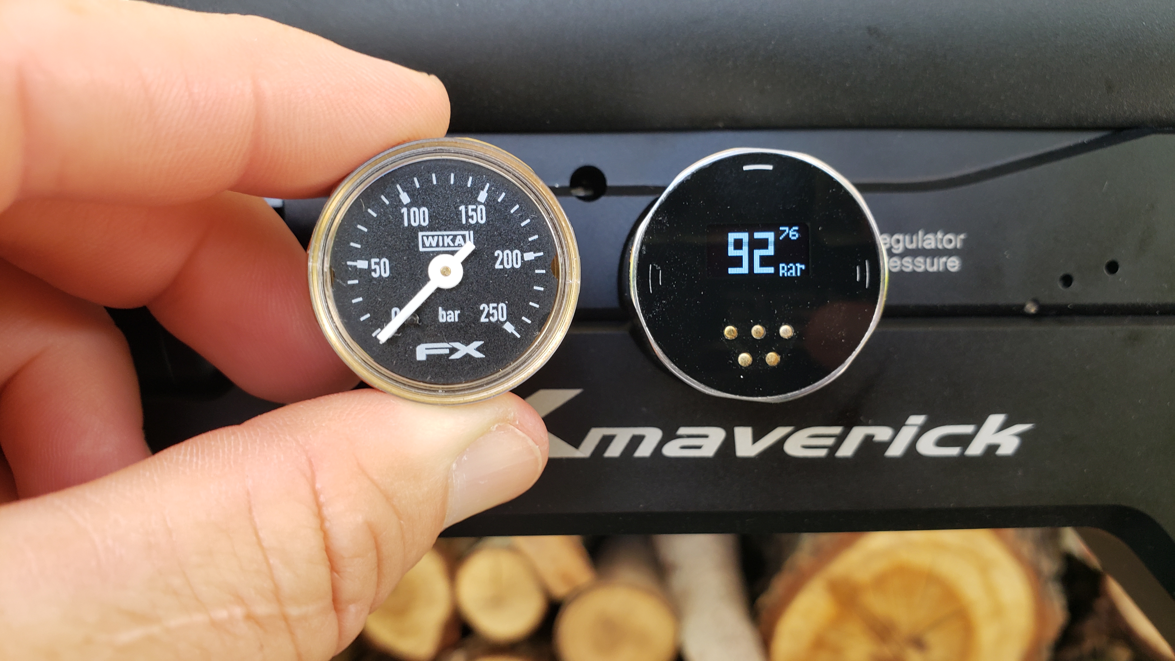

The below is something I REALLY wish I had when I began this endeavor, so I made one for you guys. It's a step-by-step on how to easily adjust the dual regulators in the new Maverick and it leaves no steps out, making following the process easy. While it looks complicated and cumbersome, it's actually fun, fast, and easy in person. I'll demo this in full in the upcoming Vlog.

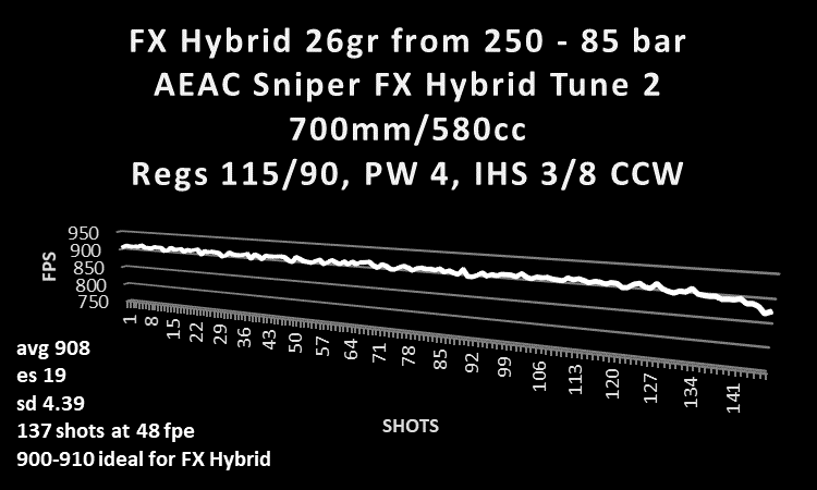

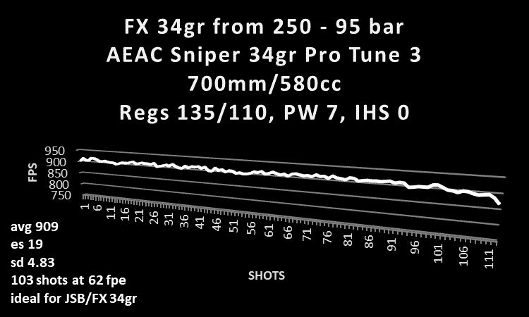

Following along! I just got my .22 VP and swapped the aluminum bottle for the 580cc CF bottle. I was having a hard time getting it tuned above 900 FPS and then discovered, as you did, that sometimes less is more! It's shooting the 18.13 grain JSB's at 988 FPS on PW #7 and 945 FPS at PW #5. I'd really like to be able to sling some 25 grain slugs at over 1000 FPS, but will probably need the Slug Kit with the heavier hammer to achieve those numbers. Thanks for the great pictures and info, I'm looking forward to the video!
You're very welcome. My guess is that you won't need the accessory hammer kit to hit the numbers you spoke of. This gun is capable of an awful lot as is.
Best, Steve
I thought my Maverick sniper was accurate so much so that after I shot it I didn't want to change any of the settings until I saw your video it gave me the courage to lower the reg pressure and try groups there. damn I happy I did. thank you for all your information
Great to hear! Yeah, it's really quite easy if you approach it from lower reg and hammer spring settings and gradually work your way up from there. Best, Steve
