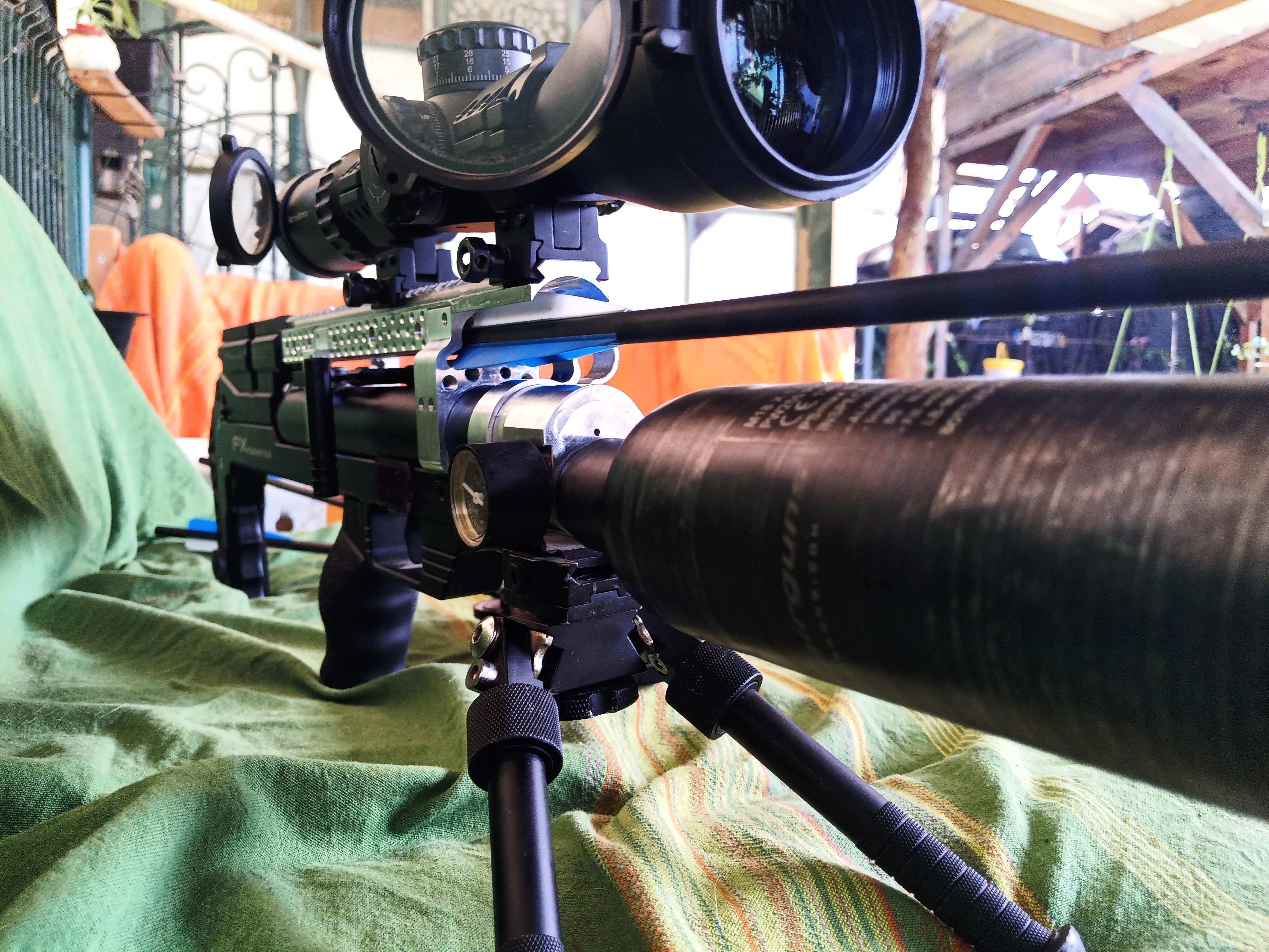

I already have a bunch of to do things to this rifle but i want to read/see what would you do / have done in respect to modding. This was my first platform but it is inevitably the one i always want to tinker, improve and make it how i wanted it to be.

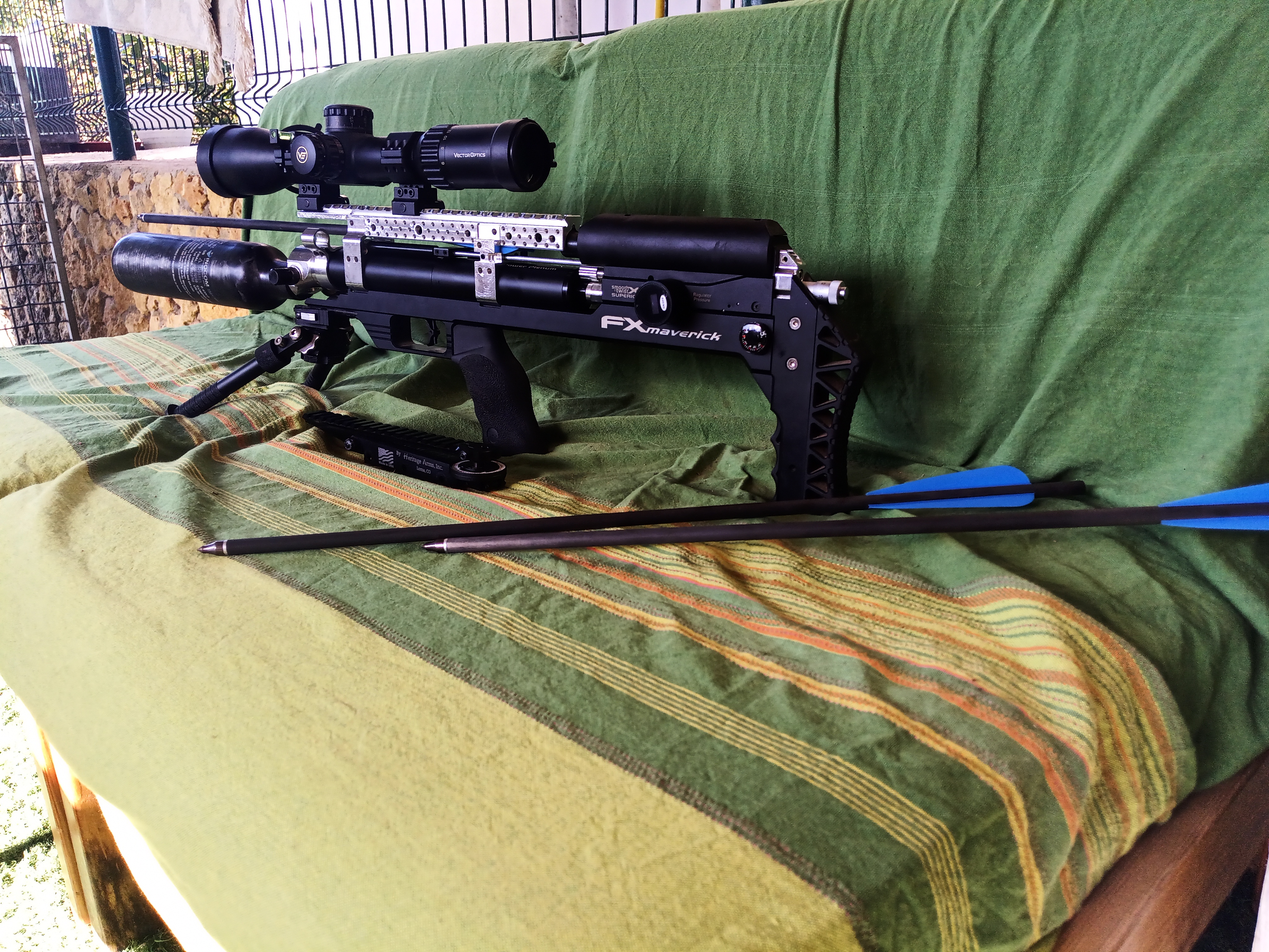

I have drawed about 5 different rails for this one. Some had elevation and wind adjustment, some had a very low profile, i couldn't settle with one so i had the idea of making a modular one with screwed patterns to deploy add-ons has i feel needed later.
This one consists in beeing able to shoot arrows, being lightweight, as low as possible to use adjustable bases comfortably and able to switch lever from right to left.
Something i want to do is also an adjustable seating depth with markings. Had it almost figured out but lost work due to a flashdrive corruption.
Stiffening cocking system is on the list, a periscope, a long bipod and possibly self leveling one.

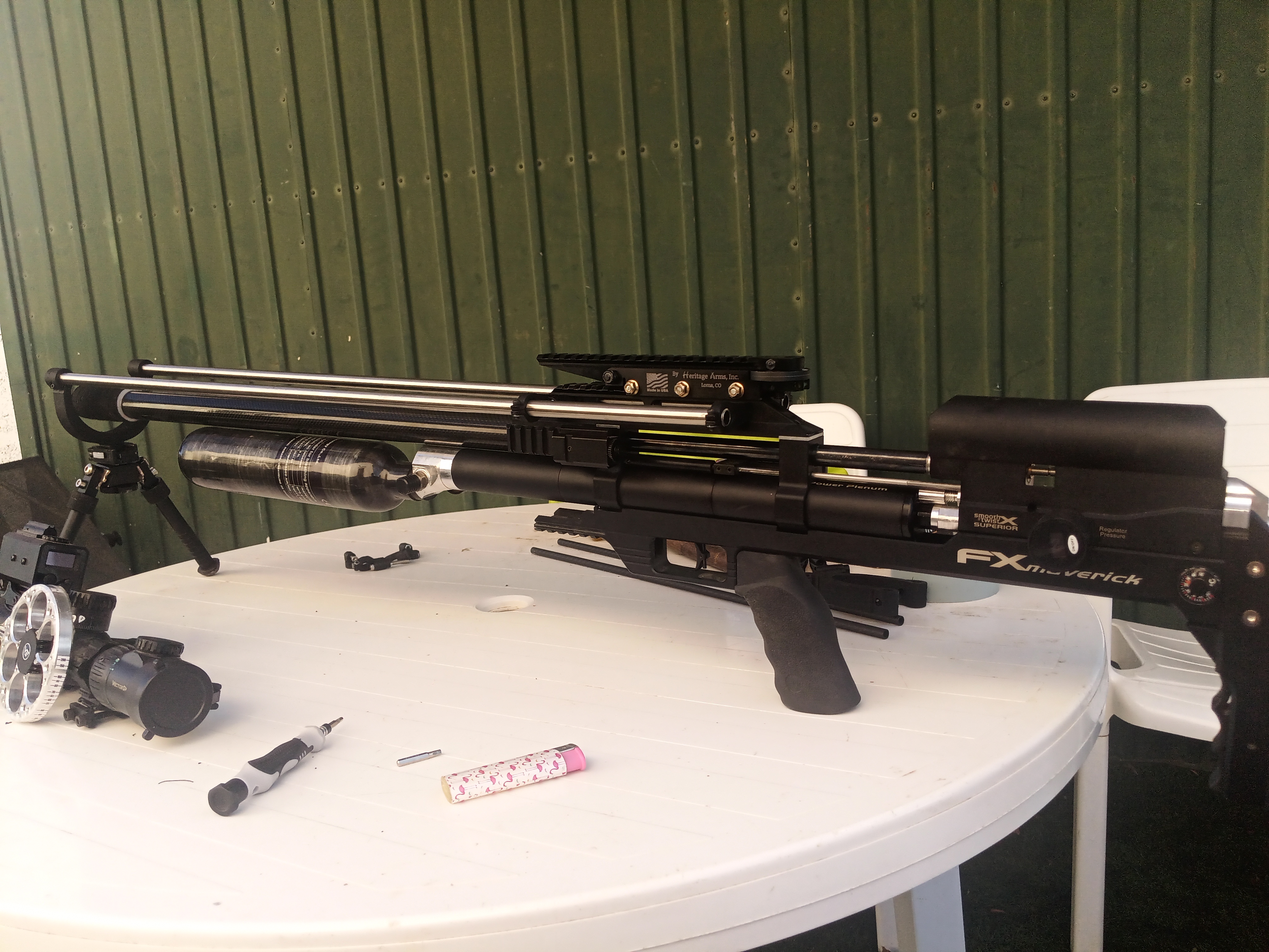

This was a 3d printed prototype for my elr shooting needs. It has been assembled in many ways and have many internal mods but i want to know about yours!
Anyway i want to know your ideas about how you would mod this excellent platform that proved to be so reliable to me and turned out to be dependable and versatile altogether.

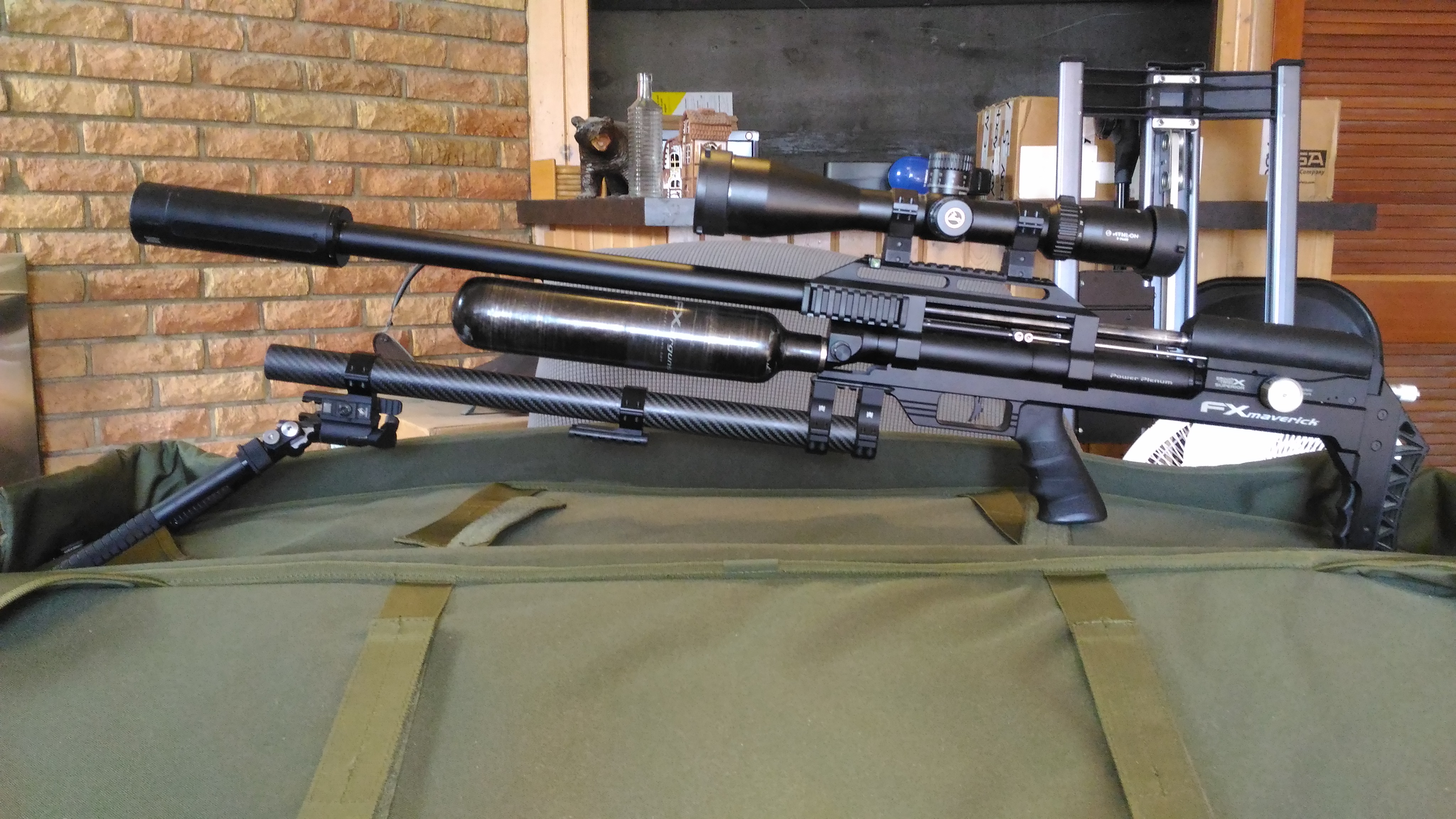

My simple bipod extension might not be worth mentioning compared to the innovative stuff you have done, but here it is. A lot of times my maverick goes hunting or target shooting in wooded or rocky areas where the bipod isn't used as a support. Instead, the extension tube rests on tree branches or logs or rock ledges or fence posts, etc. when taking a shot. It protects the bottle tank and barrel from underneath too. I call it a bash bar.
stovepipe
stovepipe
That's exactly what i want to see. I know there are plenty of good mods around this forum from posts that i have seen here but there isn't actually one place where i can find them nor a thread/forum that i know of. Thanks for the reply. It's those kind of simple ideas that just make whatever you want to do work that i seek.
