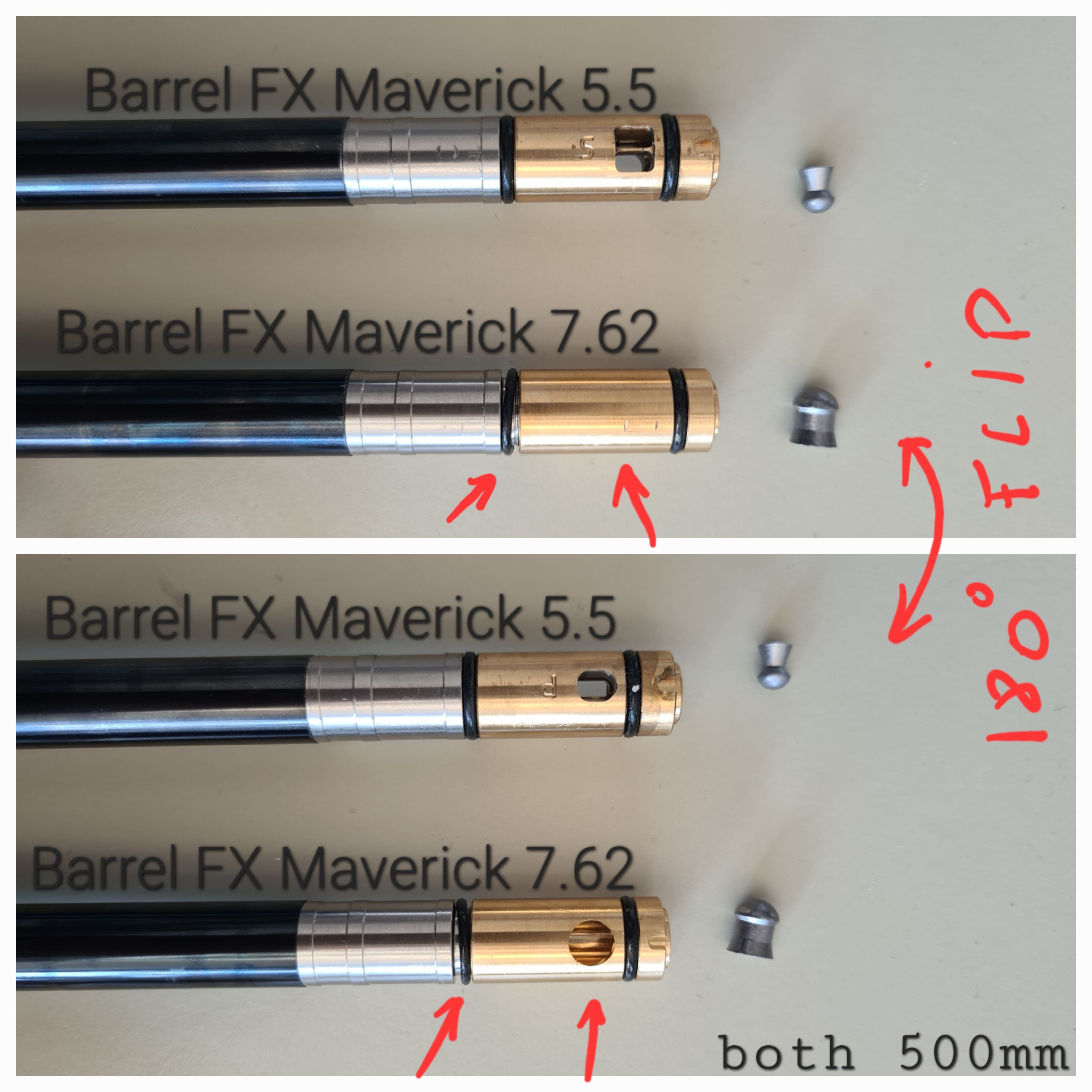

The 2 barrels I have :

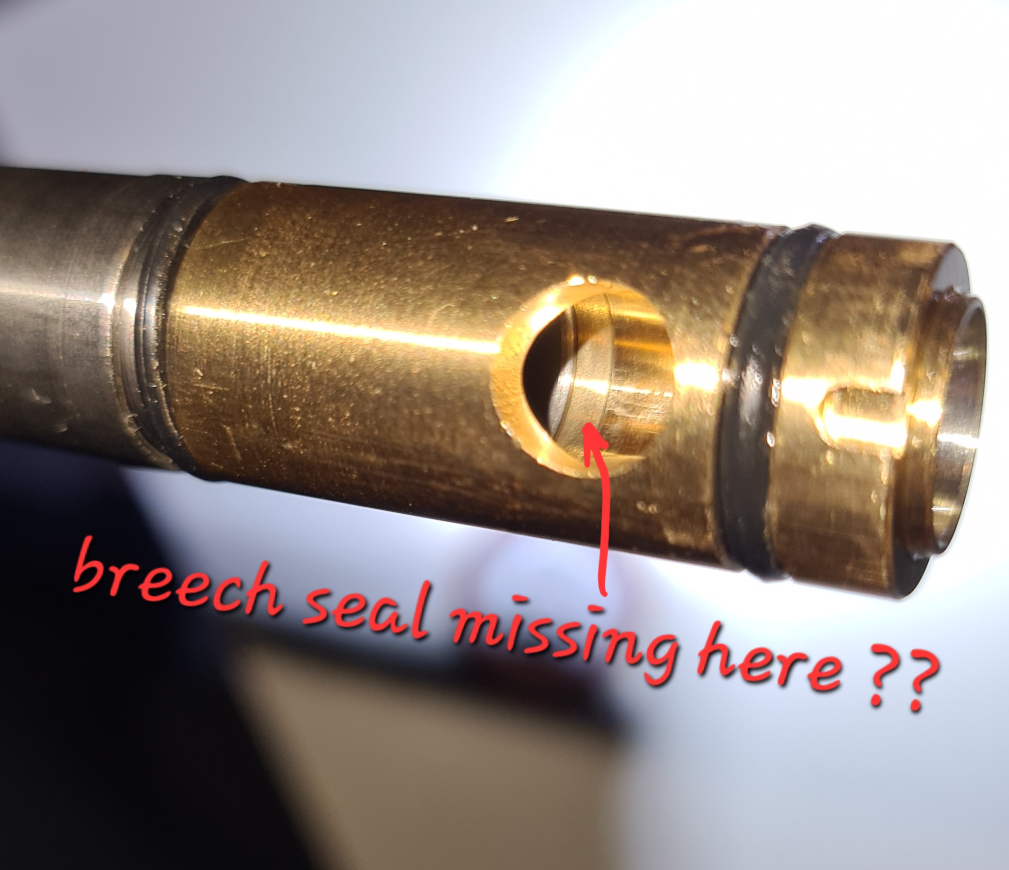

.22 (5.5mm) cal (barrel of origin) has 2 positions (2 rectangle holes et round hole)
.30 (7.62mm) cal has only one (round hole)
1) Is it normal ? Or some holes are missing on .30?
2) I noticed that 1 of the 2 O-ring on .30 cal I get is flying in the middle of nowhere... Is it normal ?
3) Could you help me on what am I doing wrong - well to reach more than 500fps with .30 cal ?

The .30 cal has only one round hole. Normal. You don't need a dual transfer port. I would leave everything stock for now.
Did you set the regs or did they come that way? They are fine as set for the .30 caliber.
The one ring that is loose in the groove, is normal also. I had the same question, and called FX. The one o ring has more play in the groove.

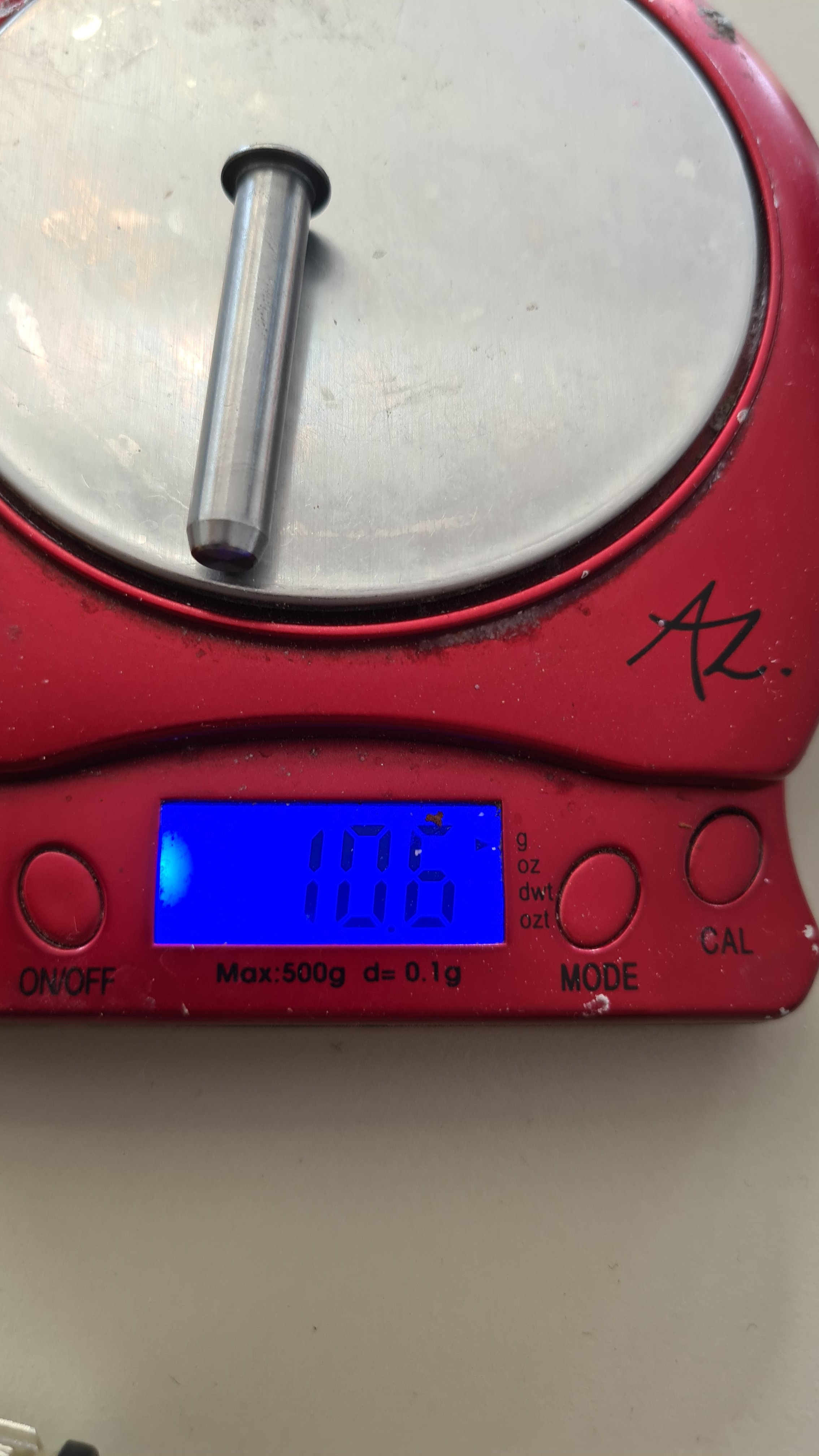

and apparently, my hammer is 10.6grams... wich is not the 7g I normally should find in the .22cal...
weird, but better for me finally !

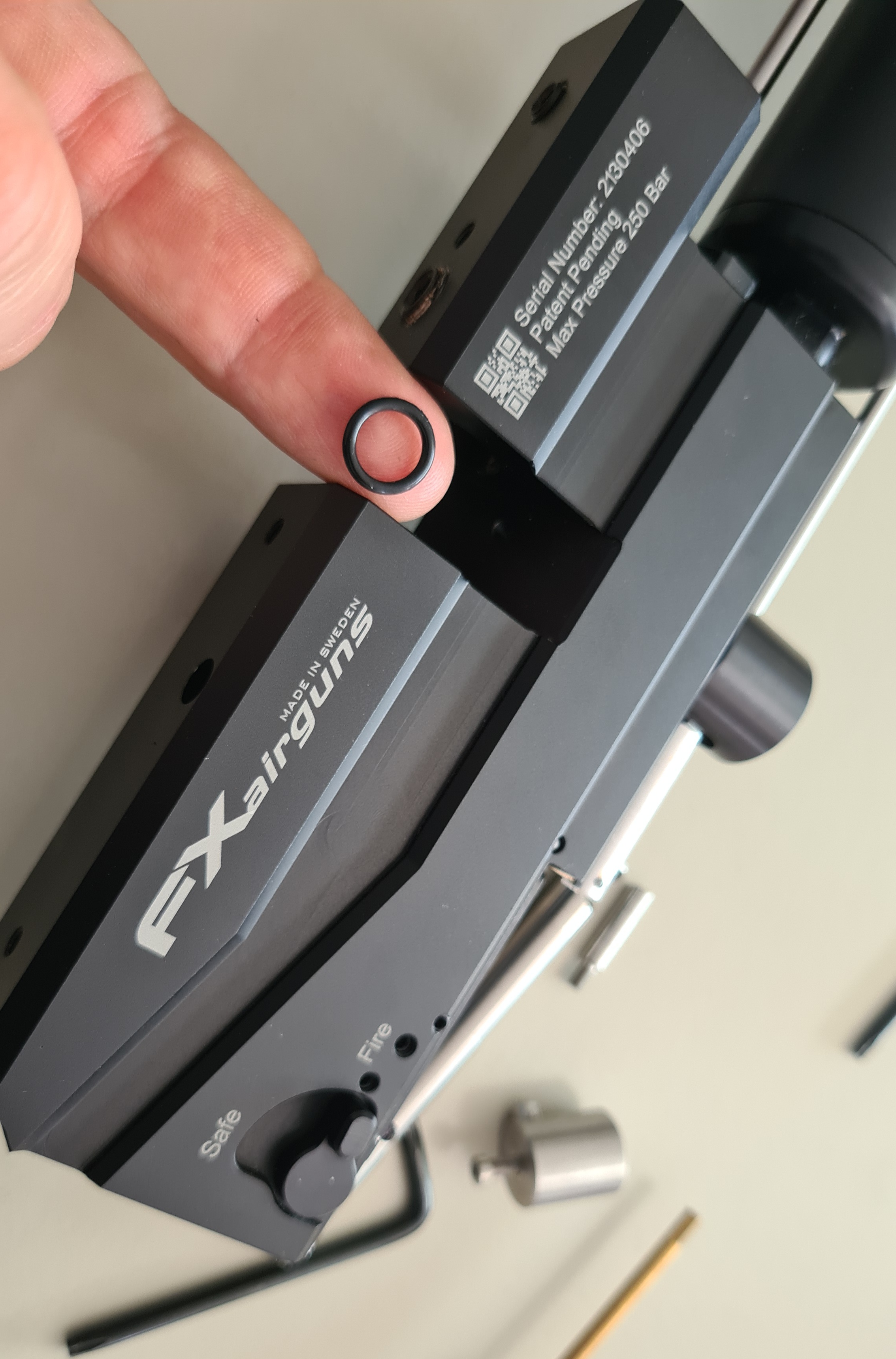

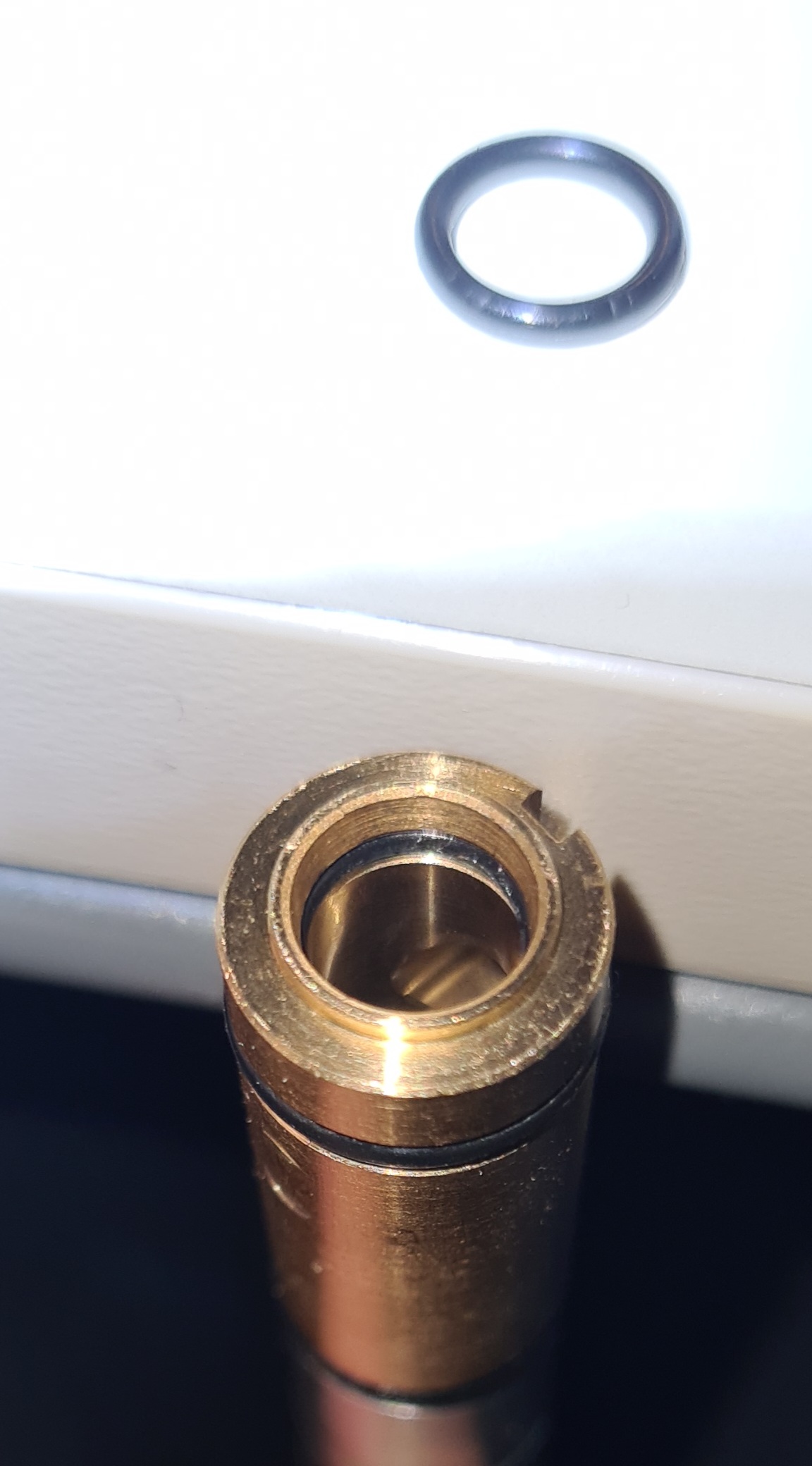

guys,
disassembling to check your suggestions I found an o-ring that came out !!
and I found exactly where you see my finger. Just by removing pellet probe.
Does anyone know where it's going?
Could it be the breech seal ??
Likely the breech seal. Definitely needs to be replaced.

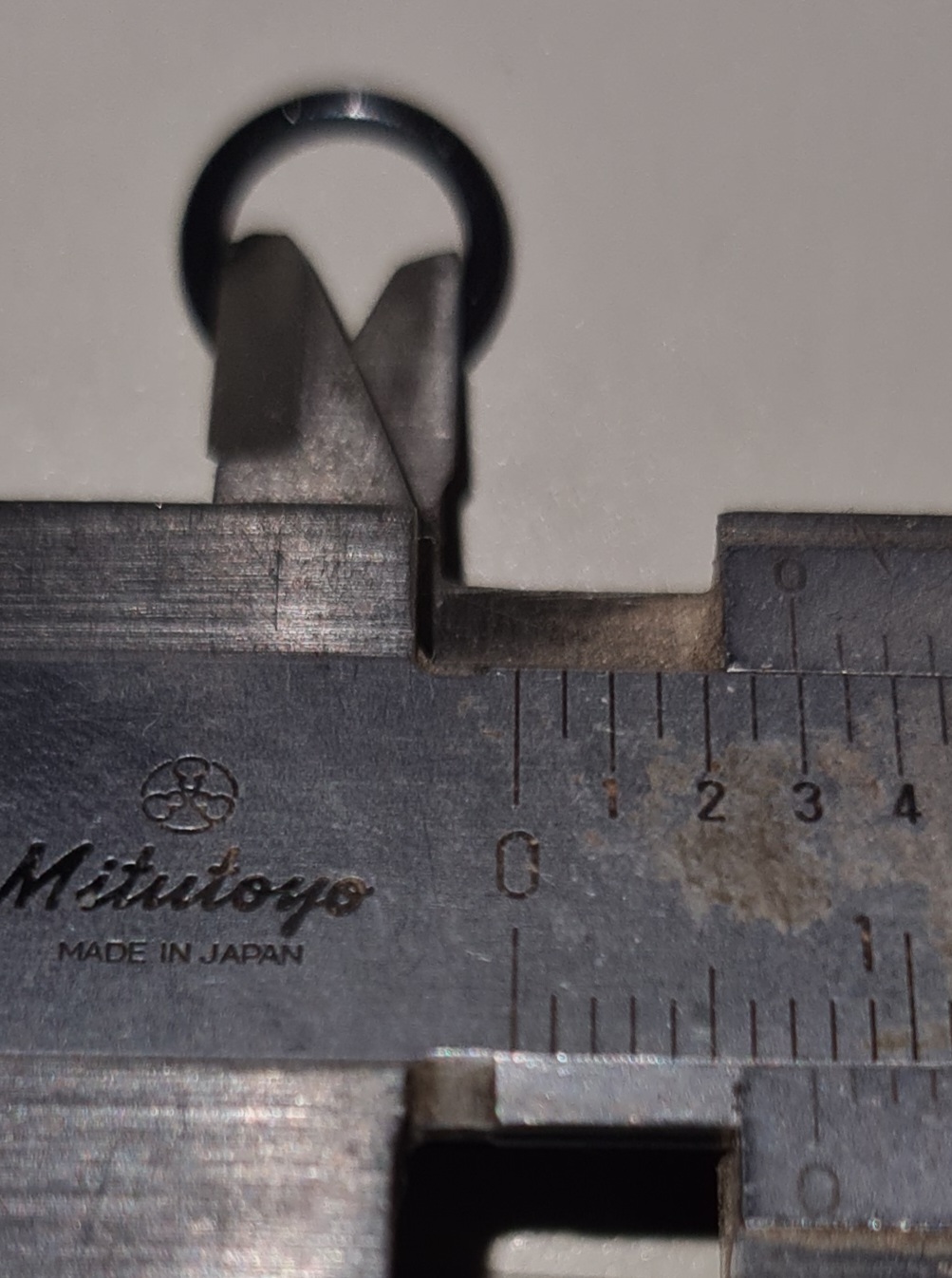

For .30cal, breech seal is 7.5x1.5 NBR 70
The outer seal (around brass inlet) is 10x2 NBR 70, so you should be able to distinguish the size differences easily.

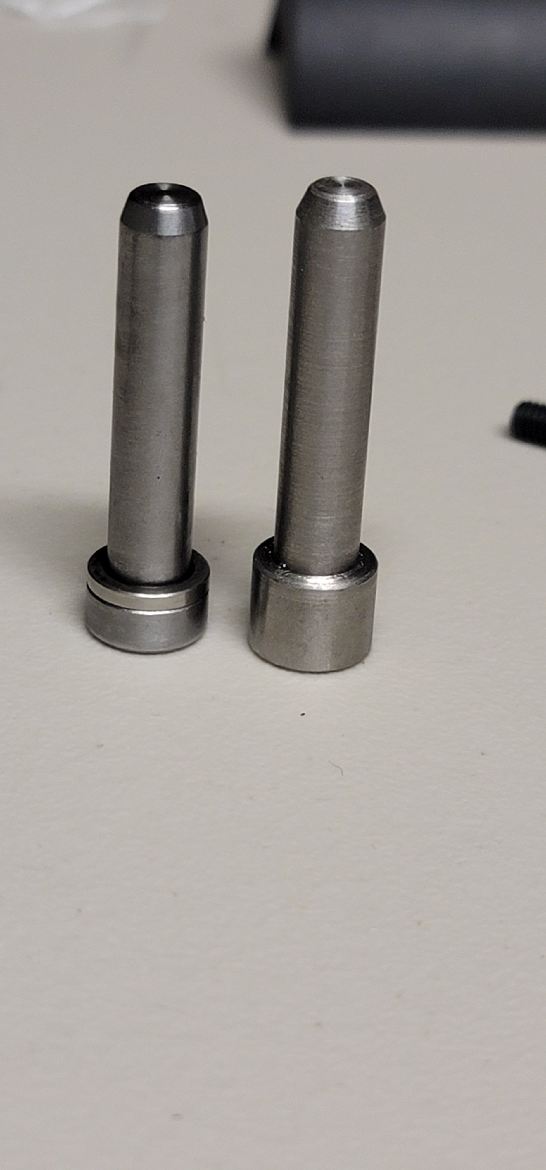

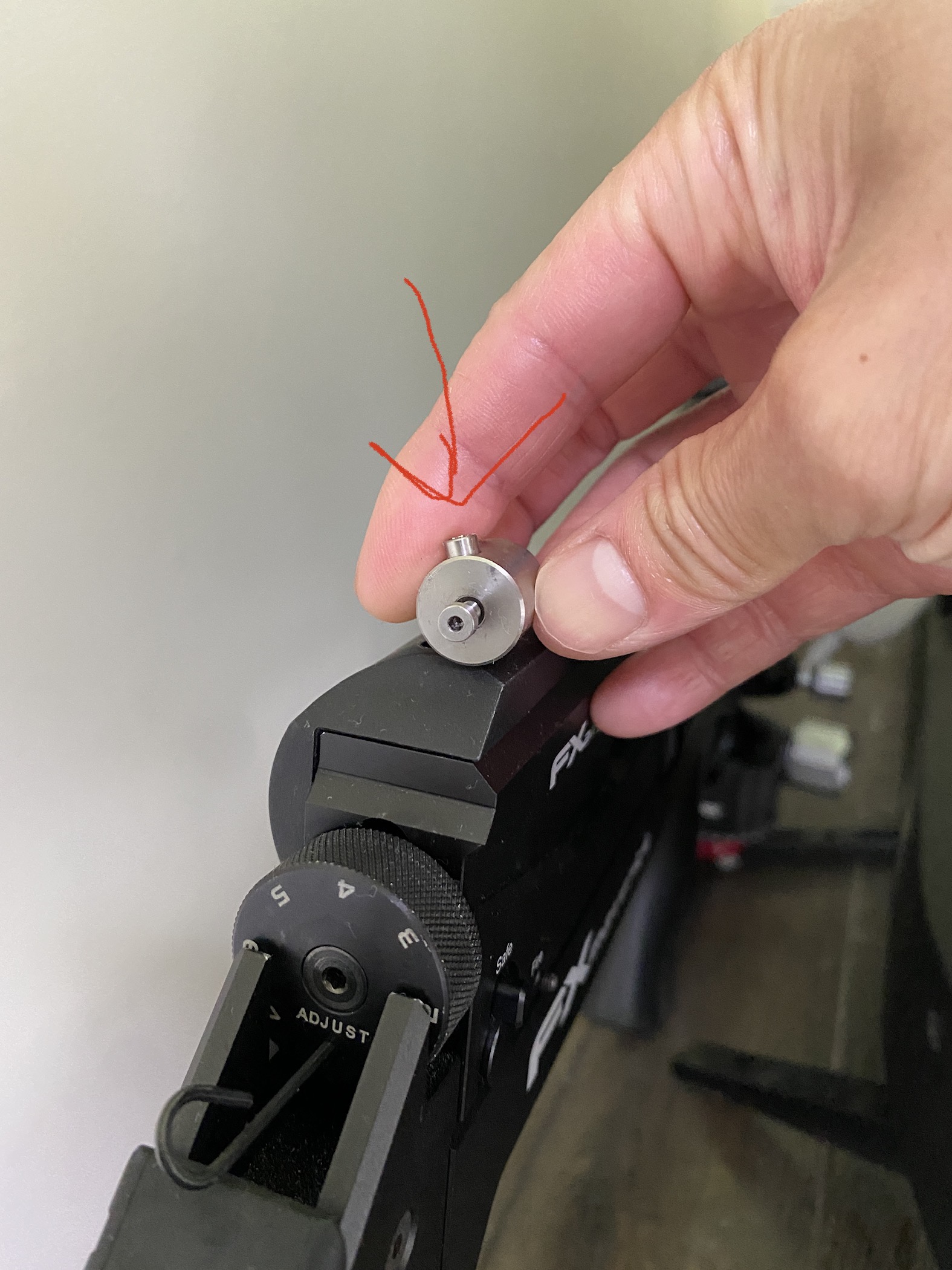

For .30 caliber, the factory rifle comes with the 13 gr hammer weight and a 52mm hammer spring.
For .22 caliber, the factory rifle comes with the weight you showed (the new .22cal weight) and a 56 mm spring.
So when converting over, if you just get the weight, you will likely struggle to lower the hammer tension enough to have a proper velocity variation on a lower (44.8gr pellet) tune.
I would recommend also picking up the 52mm hammer spring if you have not already placed your order with FX USA. It is the same hammer spring as the Impact Power Plenum, part 2604 according to FX Impact M3 schematic (C56 https://fxairguns.com/wp-content/uploads/2021/04/F10370-Impact-M3-1.pdf)
The regulator pressures suggested (155/125) are right on the money, and your hammer spring tension adjustment will be determined on your weight/spring combination.
As a suggestion/start point:
13gr weight and 56mm spring - tension screw bottomed out
13gr weight and 52mm spring - tension screw about 3.5mm turned out (If you do not have calipers, the screw uses M3x0.5 threads, which means every full rotation is 0.5mm. This means 3mm would be ~ 6 full turns from bottom.)
If you need to increase the speed, the regulator pressures will need to be increased. Keep them within 35-25 bar apart (30 bar apart sweet spot). The max adjustment of the hammer spring tension screw is about 6.4mm, but it is recommended to stop around 6.0mm for better velocity control.

And mine is of course like you said the 7.5x1.5 NBR 70 size in my .30cal barrel.

The breach seal IS in place and SEEM perfekt...

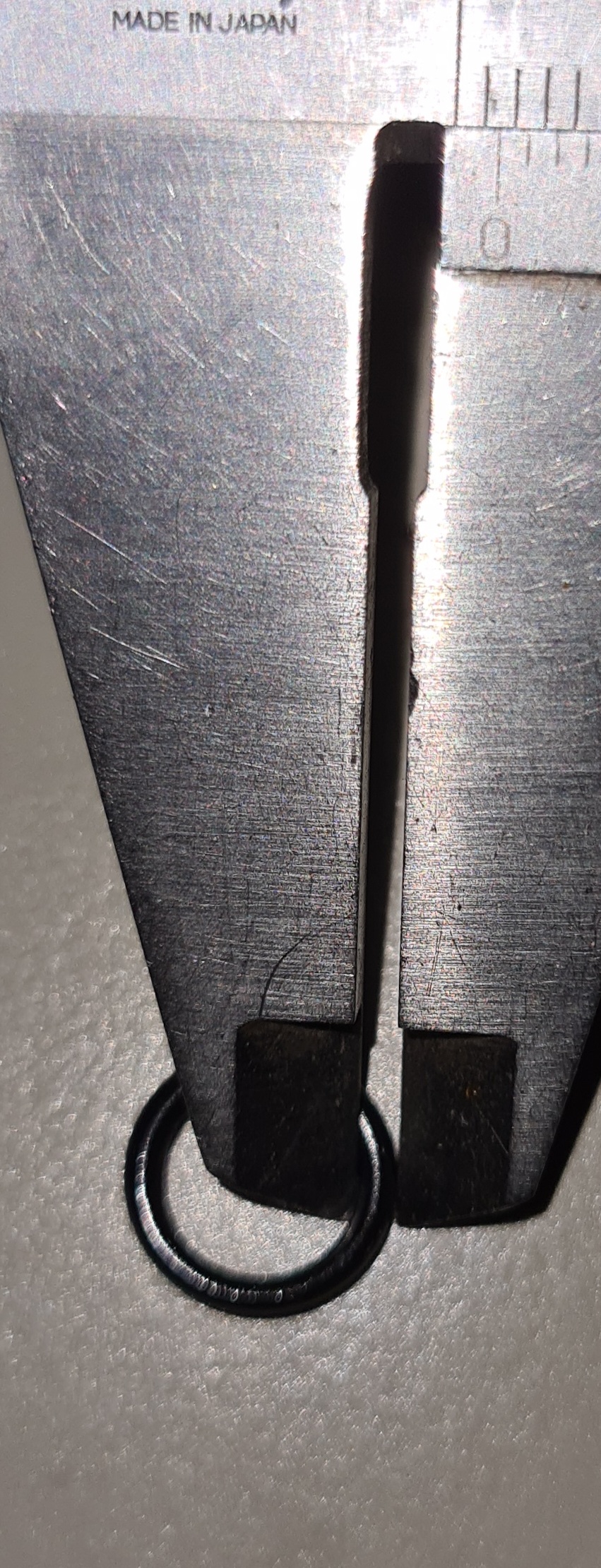

The O-ring I founded in the middle of nowhere (just over the pellet probe, over my finger like in my previous photo) is exactly the same o-ring than breech seal !!!
So I've 2 breech seal !!
In good shape...
Really don't know from where the second one came...
Could it be than there's 2 breech seal in the barrel ?
Perhaps here ?
Definitely the wrong hammer for the .30 cal. Your scale might be off or not sensitive enough. But the hammer you show is the 22 cal hammer. You need a heavier hammer.

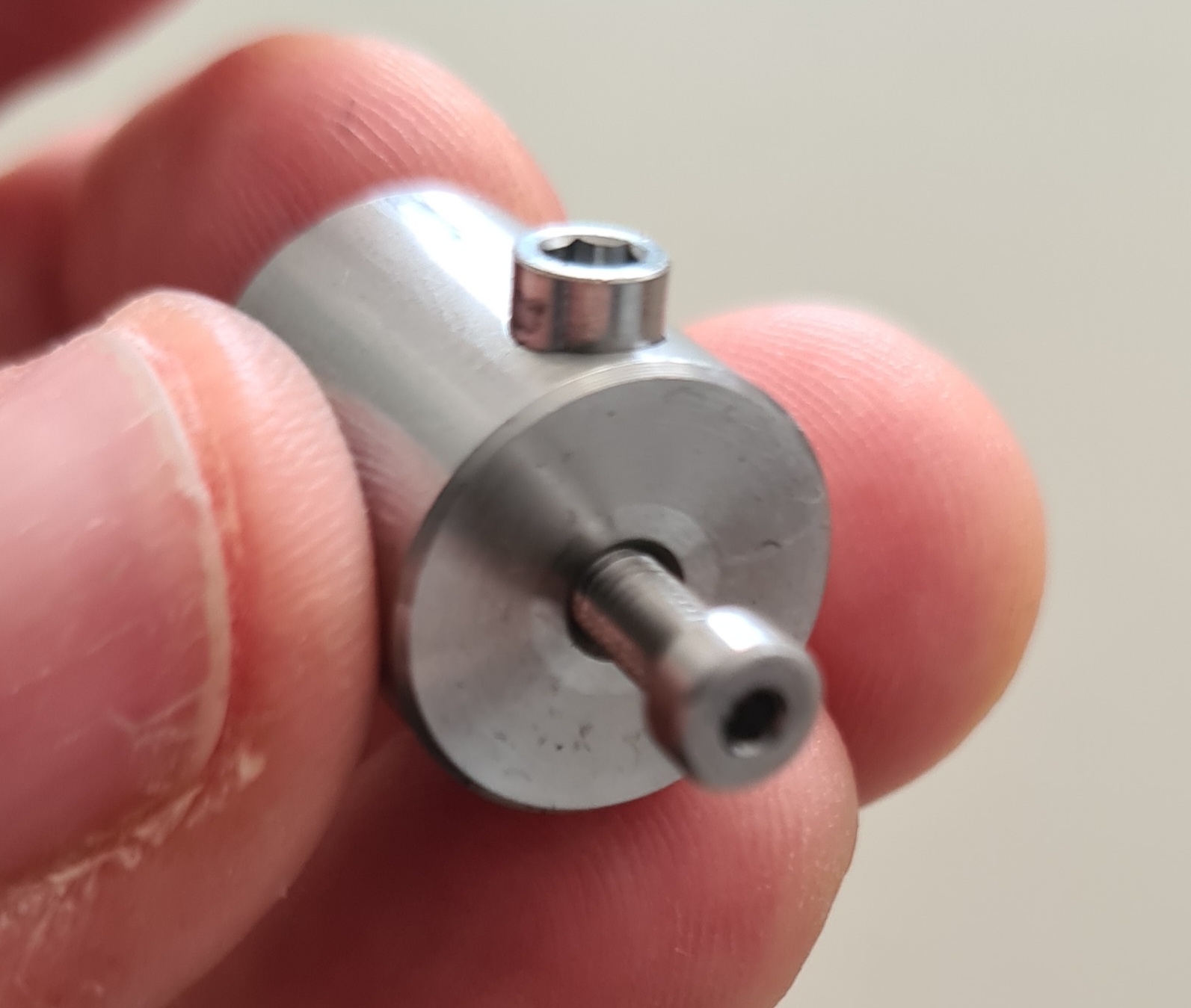

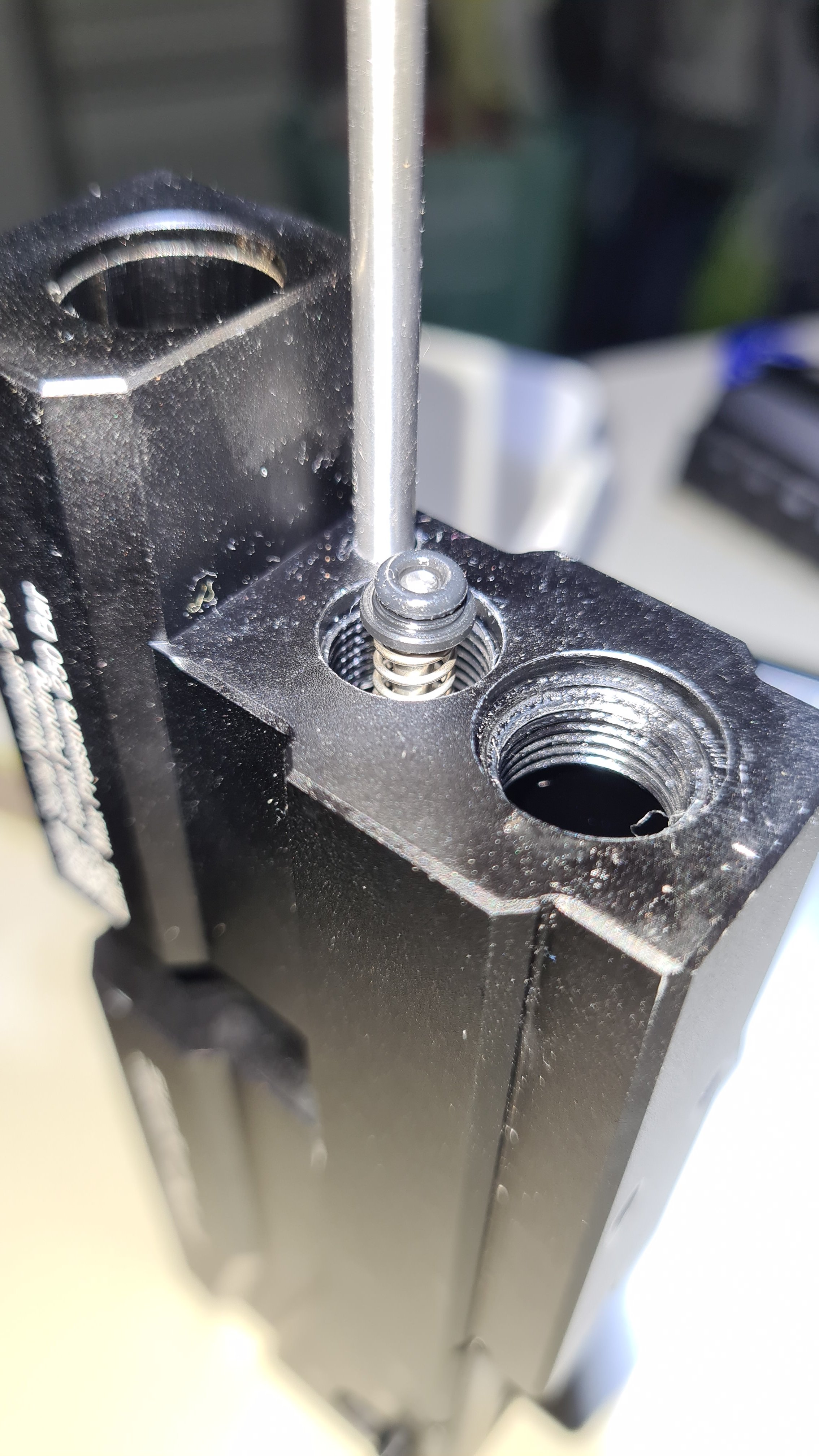

Ok guys, thanks to all.
My actual transfer port is impossible to remove (without flames and perhaps killing it and o-ring I don't actually have)
So I wait order with new transfer port and its new o-ring before taking any risk...
I also admit that my gauge not precise that a new one will help massively !

When I got my Maverick .30 it also shot low FPS. I discovered that the hammer spring adjusting screw needed to be adjusted out to 6mm height as Ernest Rowe explained in his high power tuning video. Hammer is heavier in the .30 and your .22 hammer needs to be changed to the same one or heavier as the .30 cal. Stock port is sufficient to reach 900+ FPS with pellets. Leaks from O-rings would be the only other cause is regs are working normally.
