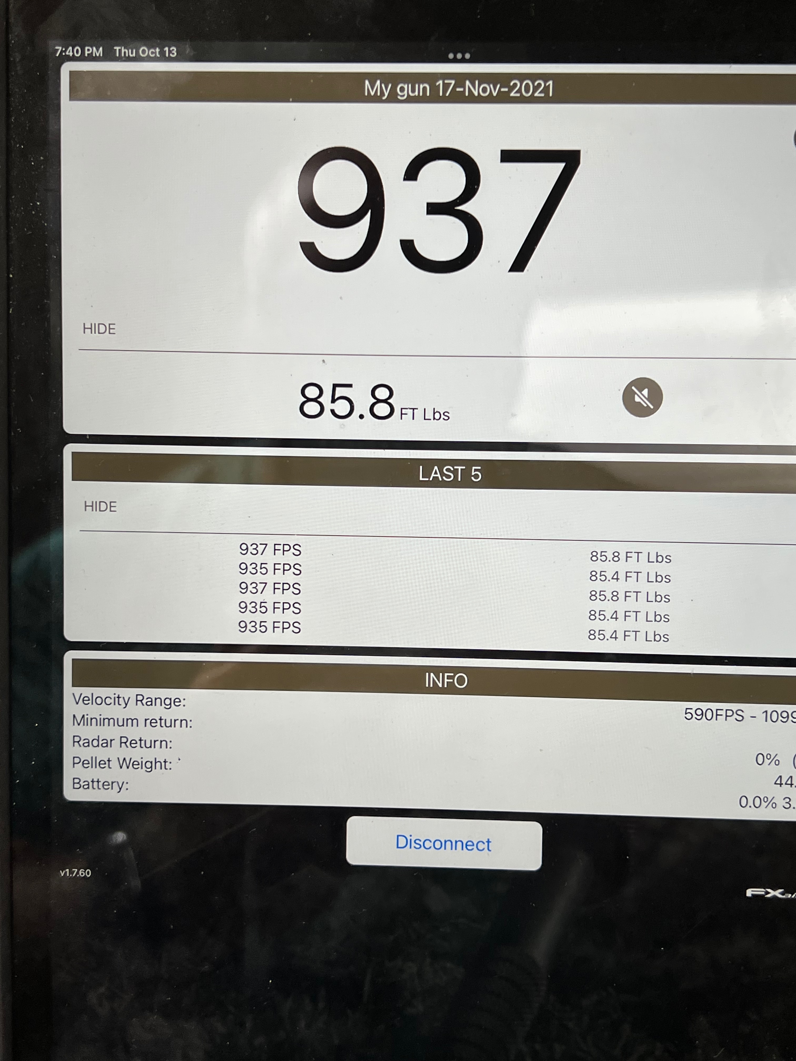

Here is my Maverick .25cal Sniper shooting 44 grain H&N Slugs.

If I can get my .30 cal maverick pushing 68 grains slugs over 970 FPS I'm sure the .25 can send them with the quickness.

Slug power kit, Tungsten hammer weight. You need the superior heavy liner for the 44 grain. Excellent results at 50 at 1/2 inch. Have yet to go to the 100 yard range with it. You can go to 180/150 with the regs and probably get close to 90 foot pounds with it, but it was so consistent, I didn't want to mess up the tune.
With my .30 Sniper I can easily get 105fpe with 54.5 slugs with a 14gr hammer, stock spring and transfer port and rear reg at 150bar. It can easily go higher I just was never looking for more than 100fpe.
If you used a pin probe with dual transfer port, tungsten hammer with power spring, and more reg pressure I think you could easily get the advertised FPE out of the .30. (116fpe). As you can see by other posts it will go even higher than that.
