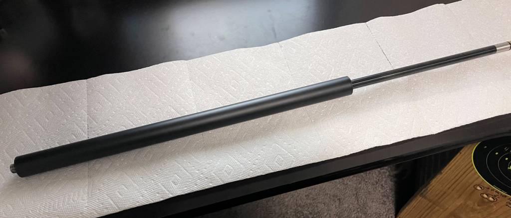

I'm preparing to install the carbon sleeve for my FX Maverick 0.25 cal. Am I to understand correctly that all I need to do is twist the shroud off? I believe, if I also understand correctly, there's a bit of loctite holding in. I've not been able to so far just twist it off - assuming it's because of some loctite in there. I've really not seen any videos for the FX Maverick showing how it comes off. Thanks.

Tracy,
You should be able to just unscrew it while mounted, no "Loctite" should have been applied. I would suggest by your photo, to put the assembly back in the breach and then try to unscrew the shroud from the sleeve screw. If the sleeve screw comes out attached within the shroud, that is a problem. Not likely though as the sleeve screw is usually very snug compared to the shroud. I hope this is encouraging considering your dilemma, but trust me, it will come off. When reassembling put a little silicone on the sleeve/barrel screw and just snug the shroud down, no cranking needed. Keep us posted.

I was finally able to finally get it off - took a rubber shim that I have for bicycle accessories that attaches to a handle bar to get the proper grip. It's a little tough to grab it as slippery as that tube is. Thank you much for offering advice.
