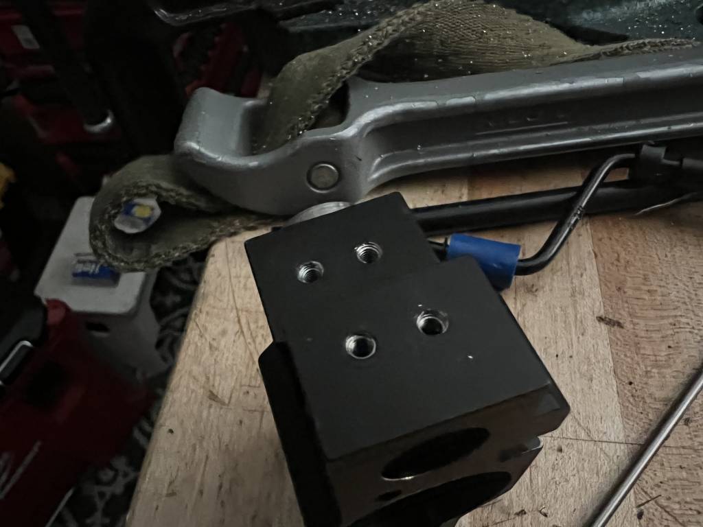

Now the big eye opener for me as I was trying to chuck the first support was that I noticed right away that FX bores them at inward angles! This makes it a little bit tricky to align / indicate, so I just used the longest M3 screws that I had on hand to setup my drill/mill.

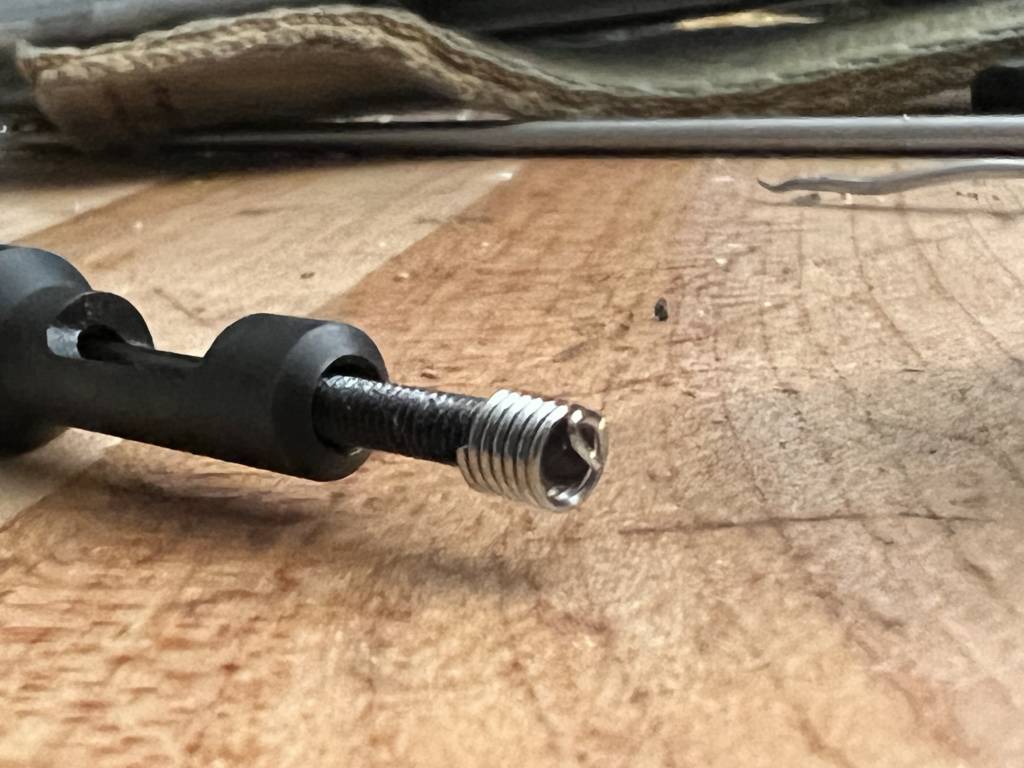

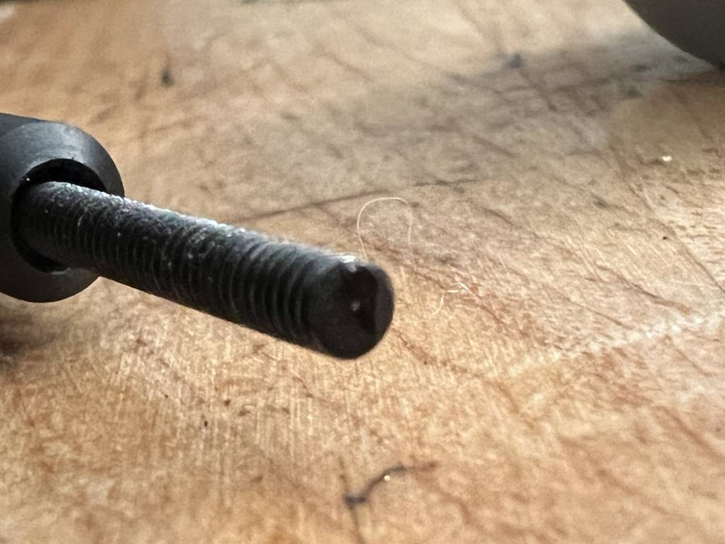

Installing the coils was pretty easy, but man are they tiny lol!

You also have to be VERY careful not to thread them in too deep - otherwise they will pop out the bottom and cause an interference issue with the barrel! I think some of the holes are actually shorter than 5mm, because I had a couple of the coils about 1/4 past flush and I wound up having to grind away the tail end of the inserts in the bore (I had already broken off the tangs).

Install the coils and break off the tang (and do not press down, just rotate them in so the tool actually contracts the coils to thread them in):
c7271f58-cd2e-416f-978f-6b5f2b112b75
Abd of course you have to break off the tang using a punch (I used a small drill as a punch).
