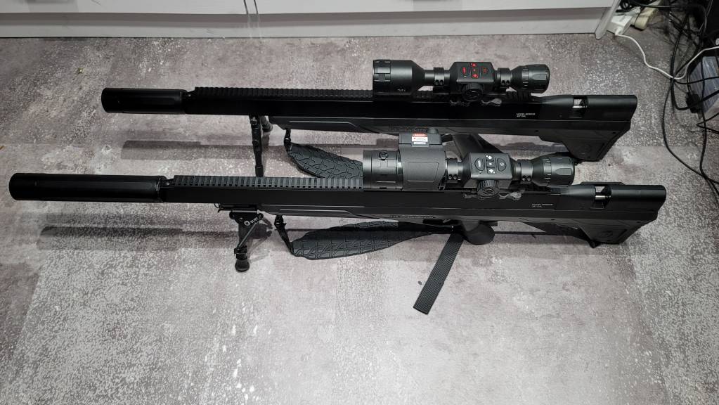

I have a Sumo on one and a DonnyFl FX stock version on the other. Honestly the standard FX he sells does well until you get past 40 foot pounds. The Emperor is overkill on a 22cal, even maxed out its overkill. I'm thinking about getting a Ronin on my 25cal Sniper version but it's shooting 77 foot pounds and its loud. The Sumo is quieter than the Fatboy. I think that's why they made an extension for it. I've had a Koi and its good, but a little less than the Sumo.
