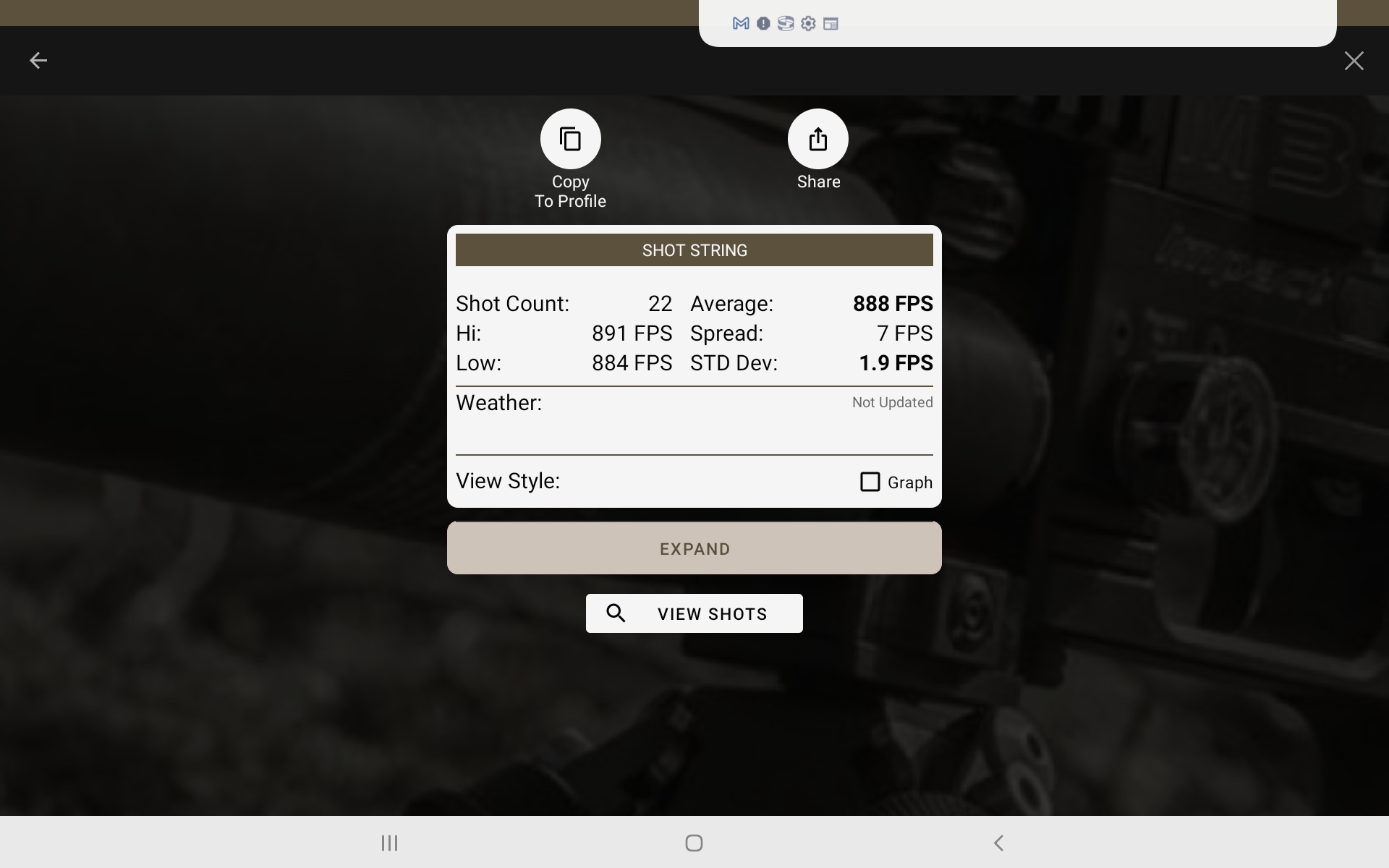

The best thing I did with my .22 vp Maverick is tune it well for 25.3gr AEA pellets and leave it alone. And a 300cc cf bottle for a handy 6lb 11oz . I'm also running the slug port and getting around 2 fps standard deviation. Here's a short string .

Reactions: MongooseV8
