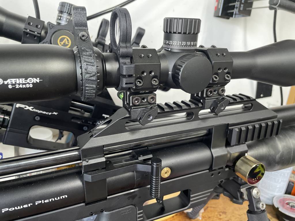

You can see my back ring is sitting up higher than the front and it also gives me the ability to dial up greatly. I like to zero at around 33 to 35 yards, for my setup, so all yardages have me dial up and not down.
