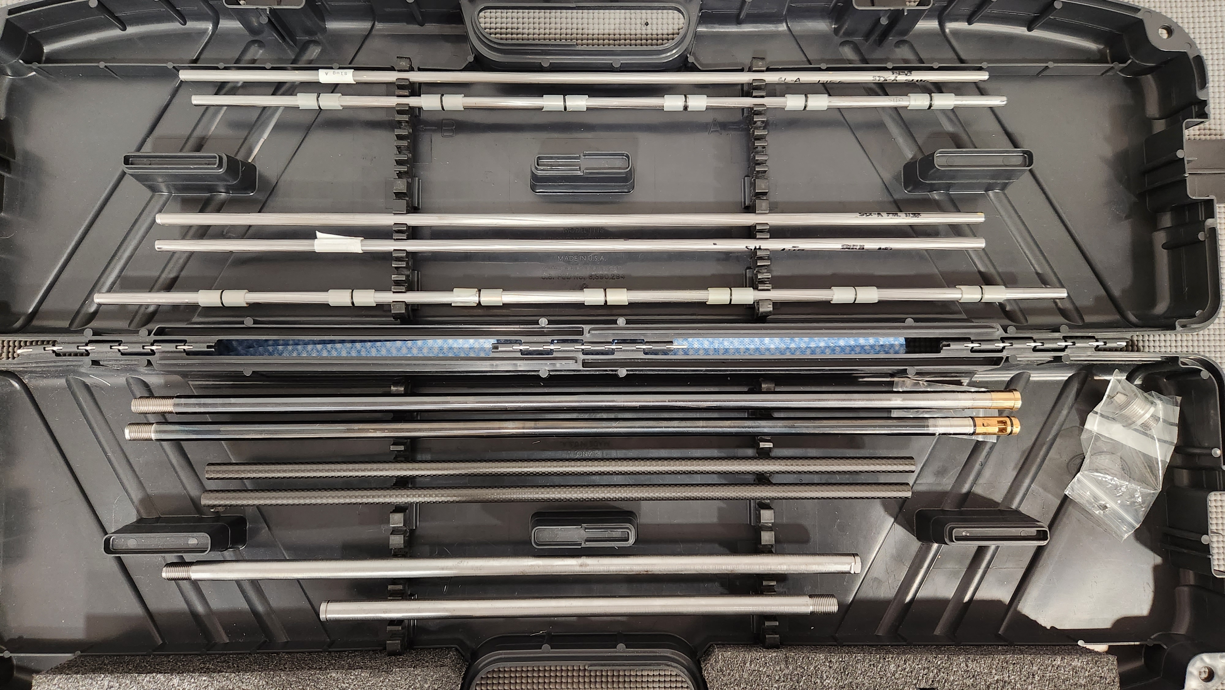

Better investment is getting a variety of liners.
I ended up with 5 so far

Every liner I measured myself the TR and engraved into liner. Just in case if I loose the sticker again :)
btw, I have 3 more liners but winterized with my guns.
