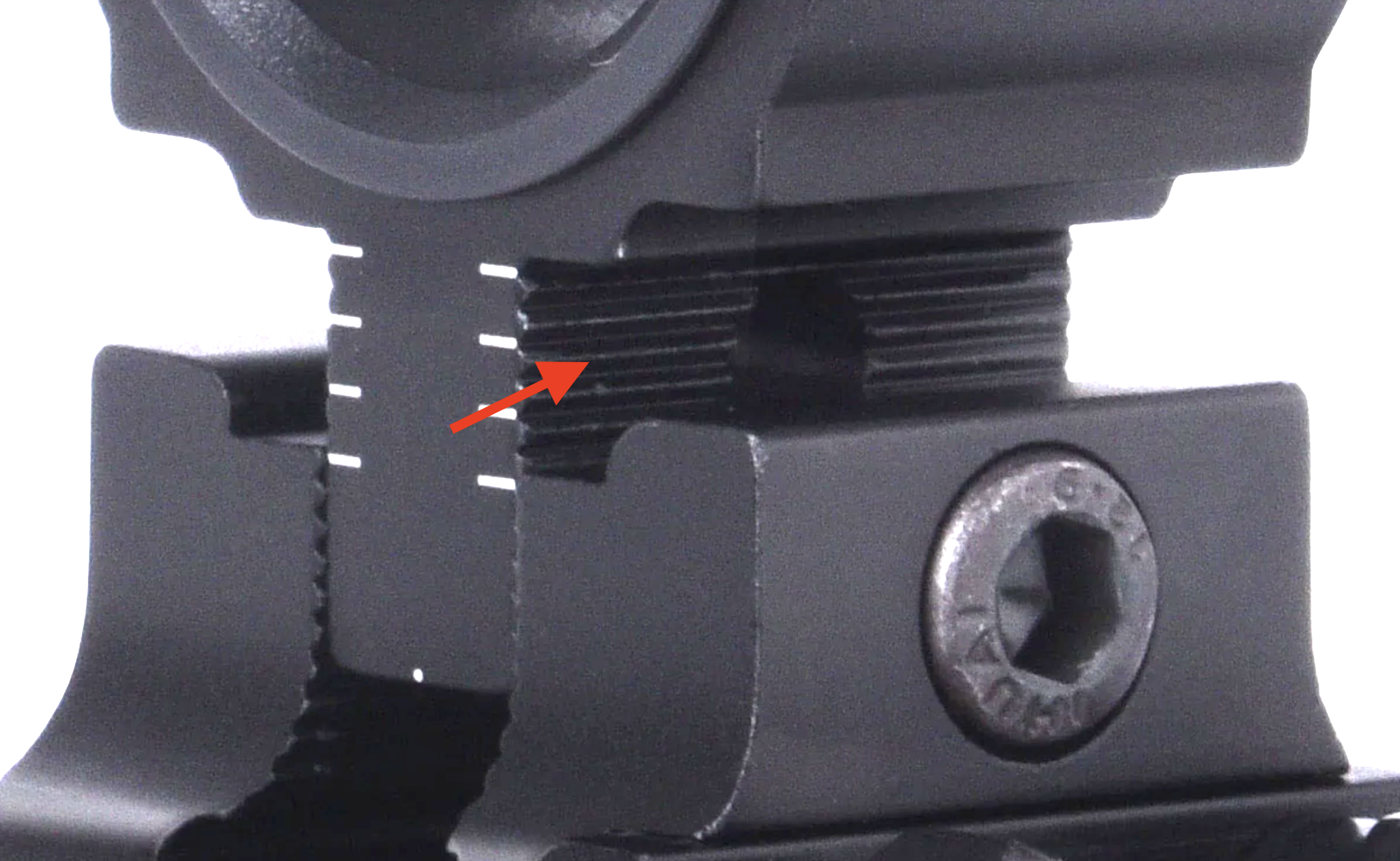

West Hunter adjustable rings have horizontal "ribs" (or notches) on the internal surface of the two moving parts between the base and the ring that allow height adjustment. This means that adjustments can only be made in discrete steps (around 1mm steps), and you must change the height of both rings at the same time to avoid cant and stressing out the scope tube. I.e. they do not allow you to change the angle of the ring vs the base like FX no-limits. They work very well for adjusting the overall height of a scope, but they would not work well when you need to change the angle of the scope vs base to compensate for the drop.

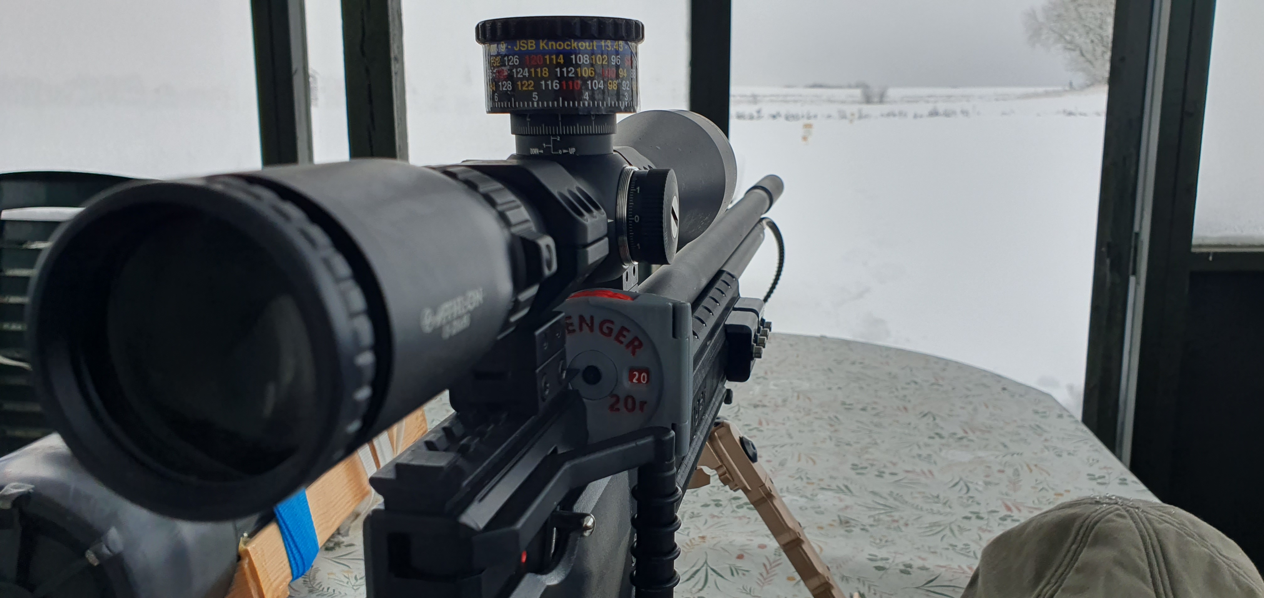

Hi There, I got three sets of FX No Limits mounts and they have been almost OK.
They have to be tightened very hard for the scope to stay in the position of the angle.
I read about many that have broken their mounts - probably because they have to be tightened very close to the "limit"
So the last three sets of choice have been Vector adjustable mounts.
They are sturdier and stay in the set 20 MOA position without the need of tightening so hard.
Here in Europe they are also just half the price of FX no limits so i will not buy another FX No Limits mount again.
I bet you will also will like the Vector mounts more when you compare:
(I get no support from Vector Optics at all - just to set things straight)
Best regards from Denmark
