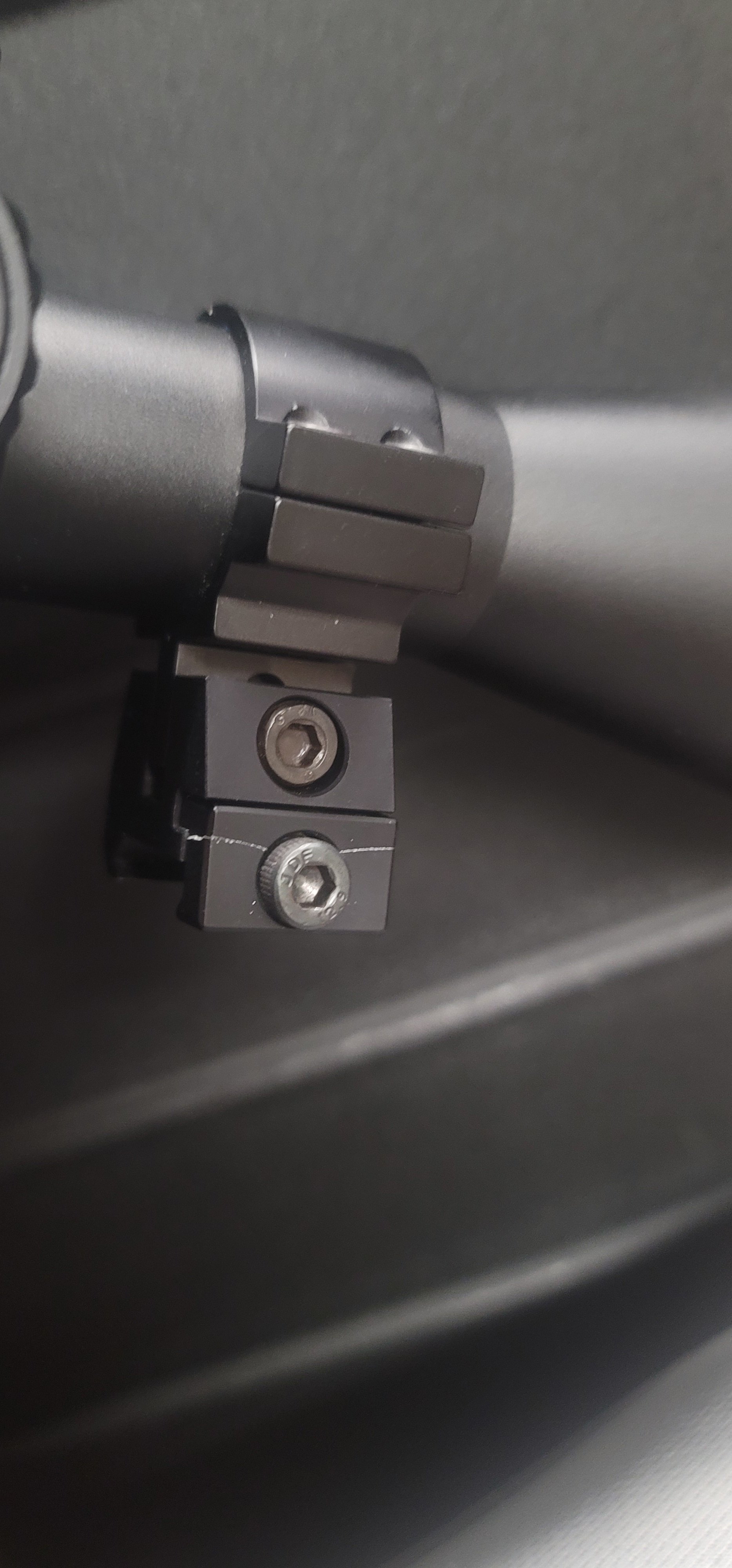

So I decided to add a scope on one of my airguns. Grabbed my spare fx no limit - and I'm starting to tighten them on the rail and this happens... is this the new norm? Do you know if they warranty this? I'm shocked for the price they just snapped. Didn't even add much pressure.

Crazy, I’ve never even broke 10 dollar rings. Glad I never pulled the trigger on these. I would have expected more. I don’t use torque wrenches either. Just take care. My guns are pcps not 308 centerfire. Don’t need to be cranked on at all.
While there might be better options available for more money.
I’ve owned two sets for a while now…no issues.
Glad to see FX stand behind the product.
I’m guessing they’re 1000’s of them in use now.
I would like to add, that it is possibly the loosen them too much and tighten them down while improperly seated. I’ve seen it happen with some of my pic rails.

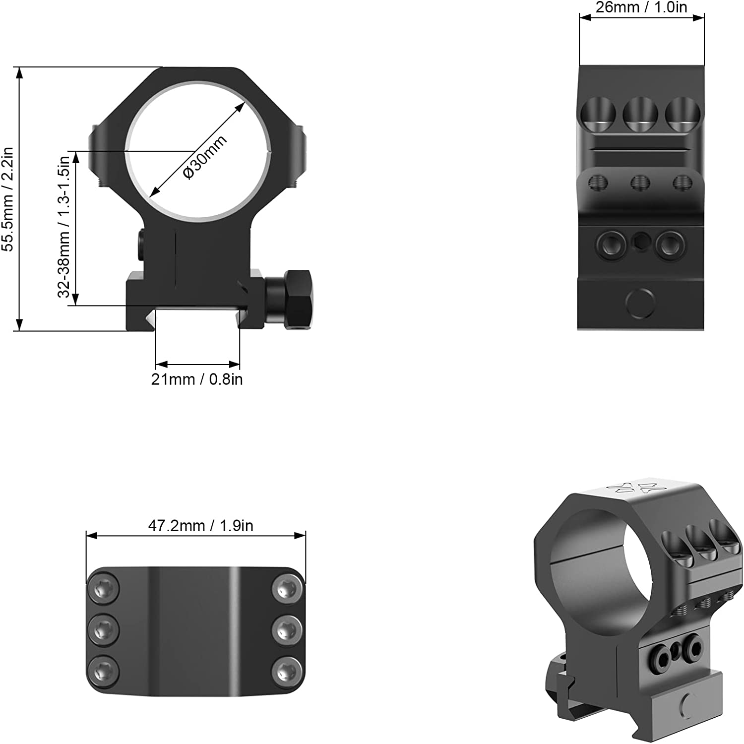

If you plan on multiple install / remove cycles, a plate that tiny under the screw needs to be made of steel.
Just needs to be wider. The big hole in the center at only 20mm wide just weakens it too much. Eagle and Vicoptics make them 26mm and slightly thicker.
I own 2 sets of fx, 2 sets of vicoptics and 1 set of eagle. I'll never buy anything but the vicoptics again because you get nothing extra for the additional $56 to $70.
I used to work in a metallurgy quality lab. We called it metal fatigue
I thought fatigue failure referred to a material failure associated with many, many loading/relaxing cycles at something under the material’s yield strength. For aluminum alloys, it can often be in the millions of cycles.
Here people are describing failures sometimes in the first loading cycle.
