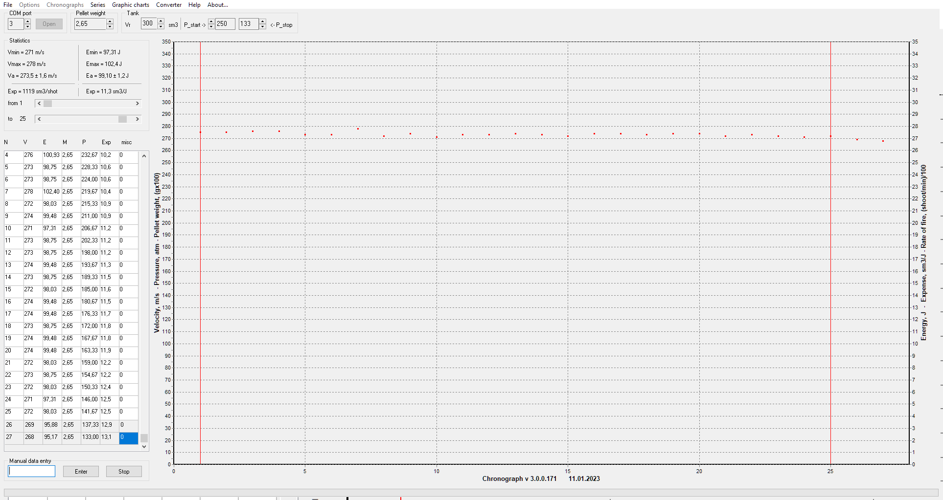

So, the very first thing I wanted to test is what speed and how many shots can this gun give me with it’s 300cc bottle and huge (156cc) plenum.
The result is 25 shots in 250-142 bar with 40gr slugs at the speed of 273 meters per second (896 fps). Average air consumption is 11,3 cubic centimeters of air per joule, that is a very good result as for me taking into account barrel length and projectile weight.
Here is the video prove and the table of calculations:
My first impression.
  • I didn’t expect FX Panthera to be able to shoot those heavy slugs at that velocity (it should be rather accurate according to my experience) out of the box.
  • I really didn’t think that it would be possible to make 25 rather consistent shots from 300cc bottle
  • Really happy to have opportunity to shoot 40gr long (12,5mm / 0,5 inch) .22 slugs out of the box with usual magazine
  • I didn’t think that it would be possible to shoot those speeds with usual tube-like probe. I had to use pin probe for that needs in all my previous airguns.

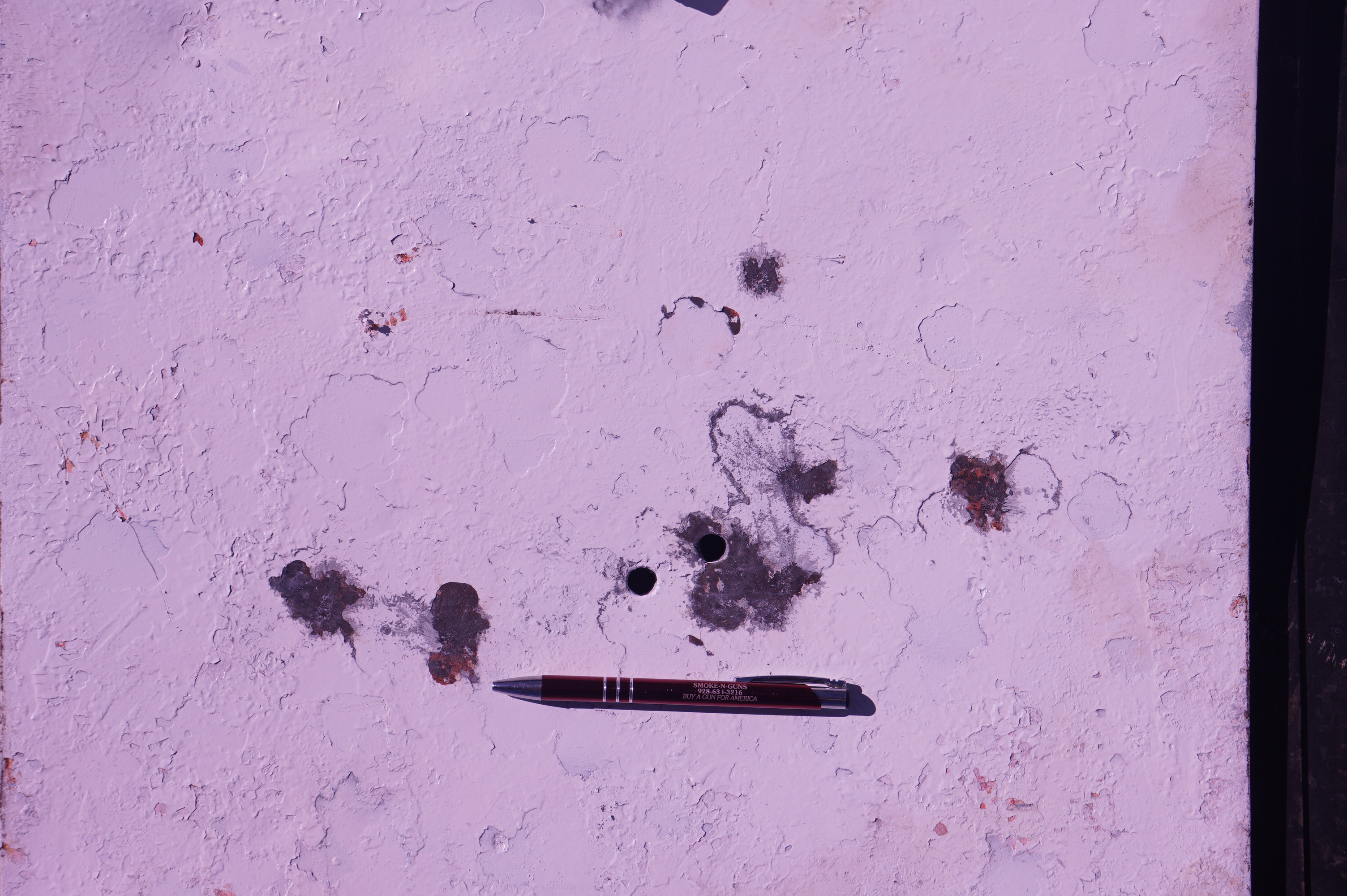

Not much text this time - everything is in the video. 100 yards, .22 40gr slugs, 60 shots (6 groups by 10 shots) one by one without stop, single shutter made video as a prove - 0,97 MOA! It is not a hype - it is a fact. Amazed with FX Panthera stability, never met something like that before!

Did you ever see 0.56 MOA and 0.29MOA 5 shot group to 107 yards in the open field one after another recorded in 4K 120fps video? FX Panthera showed me! Never got something like that before! .22 40gr 915 fps
I would never believe it if I didn't record it :)
VERY, VERY nice shooting. Outside is always a lot more difficult compared to inside ranges. Excellent work.
My panthera and also my Sinner .223 shoots six 5 shot groups within 0.6 moa average. I shoot both the 100m competitions with .22lr and airgun. After 5 matches i lead both competitions and with airgun i have this year for the first time more points than with my .22lr. I shot 4 airgun matches with my panthera and 1 with the Sinner. The 5 years before all with the Sinner.
I got to thinking about your accomplishment more and it dawned on me that I didn't ask what 22rf rifle you used, maybe more importantly, which level of match 22rf ammo you use, as well as was it tested in your gun in a jig at a test facility??
This article is the one I had some recollection of which clearly shows just how precise a 22rf can be with the right ammo.
Again this is not to take away from your awesome achievement but to back up my previous proclamation.
