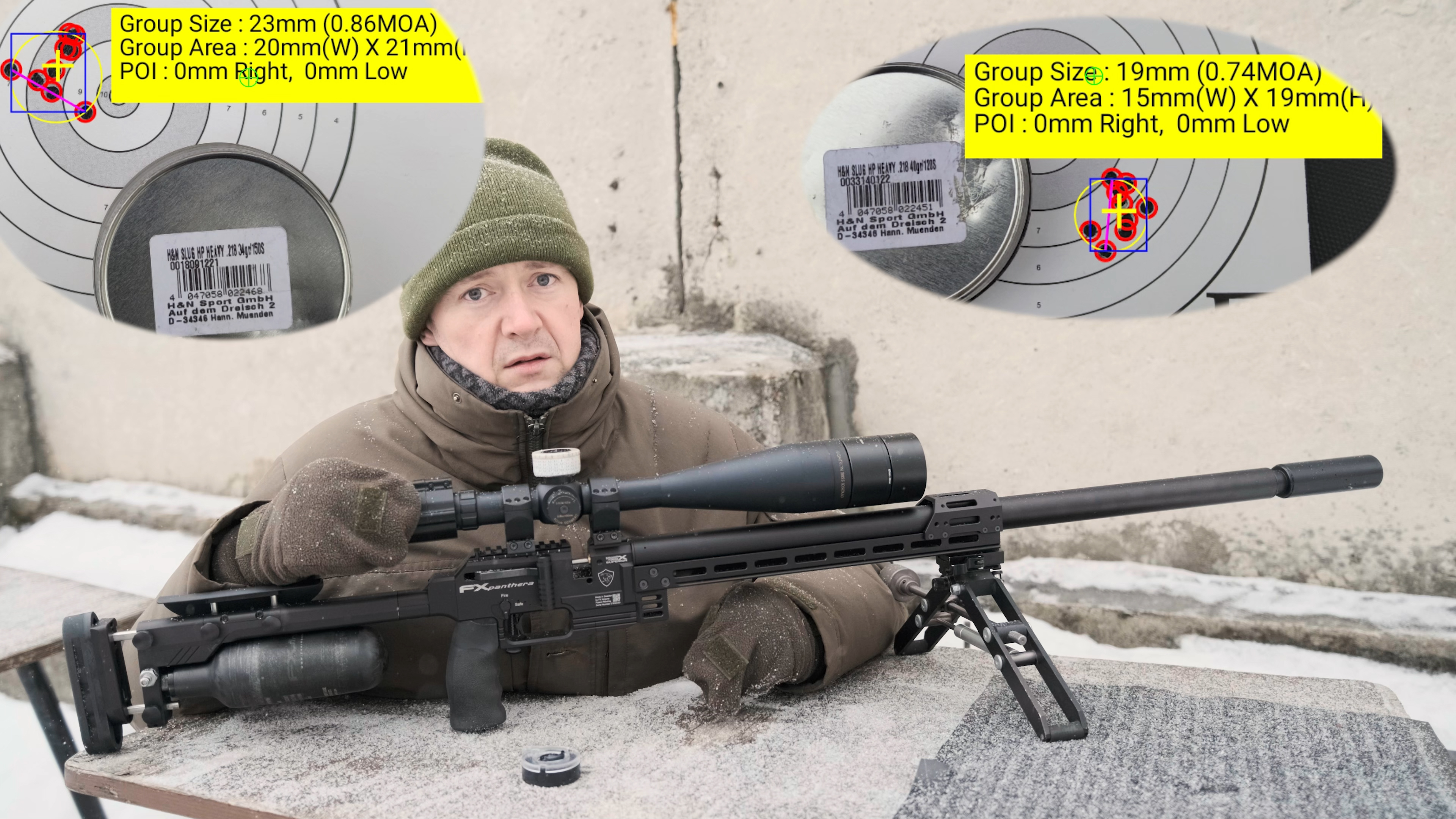

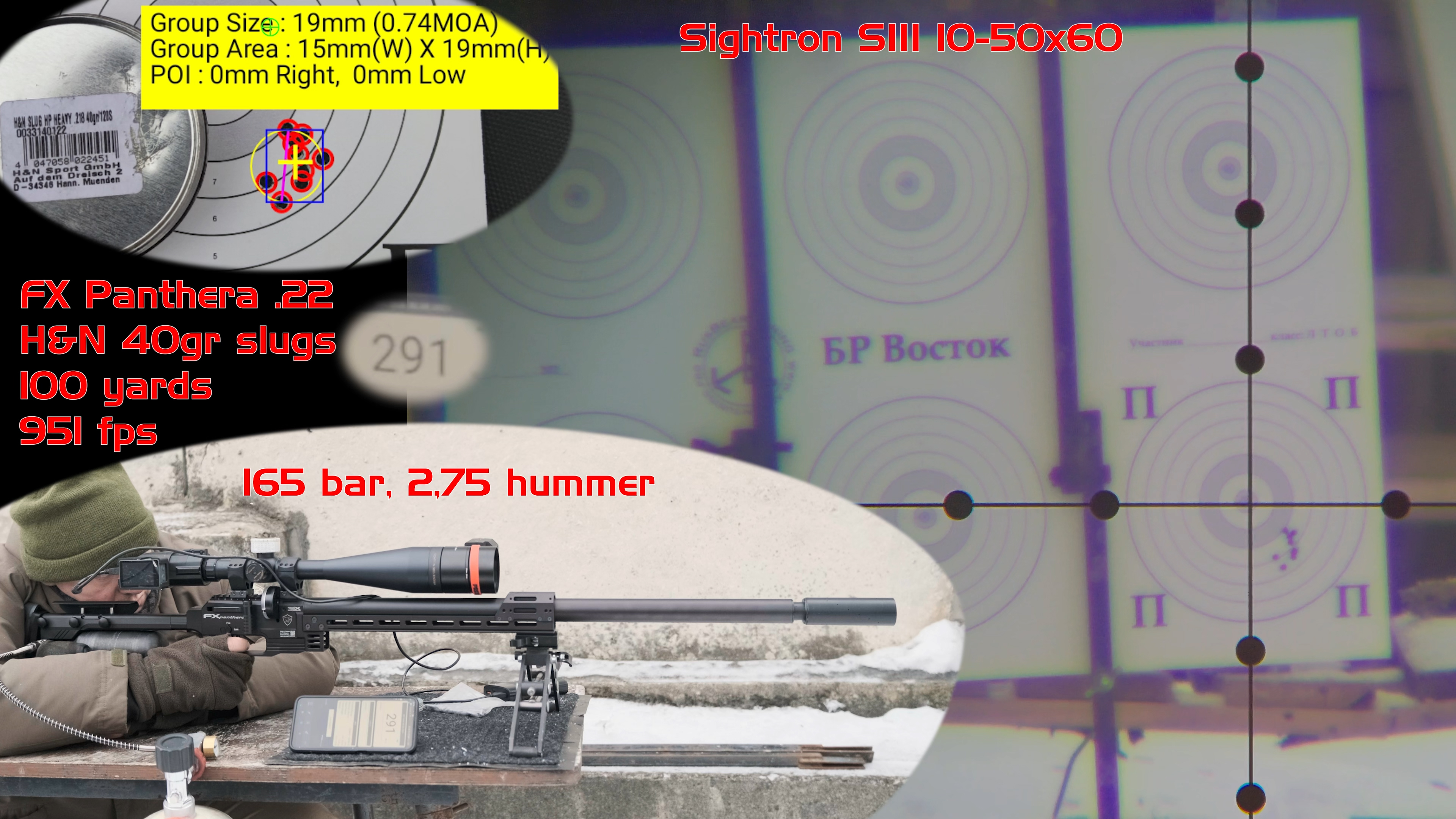

As a fact my first thoughtful try to shoot FX Panthera to 100 yards distance was this weekend and the results were excellent - video is coming soon. I can surely say that the regulator pressure is at the same level as it was several days ago, the same as the first shot speed. I didn't have tests for the POI change, so can't tell you something about it.
So, here is my brief report and shooting to 100 yards with 40 and 37 grain slugs. And yes, it was cold 21F.

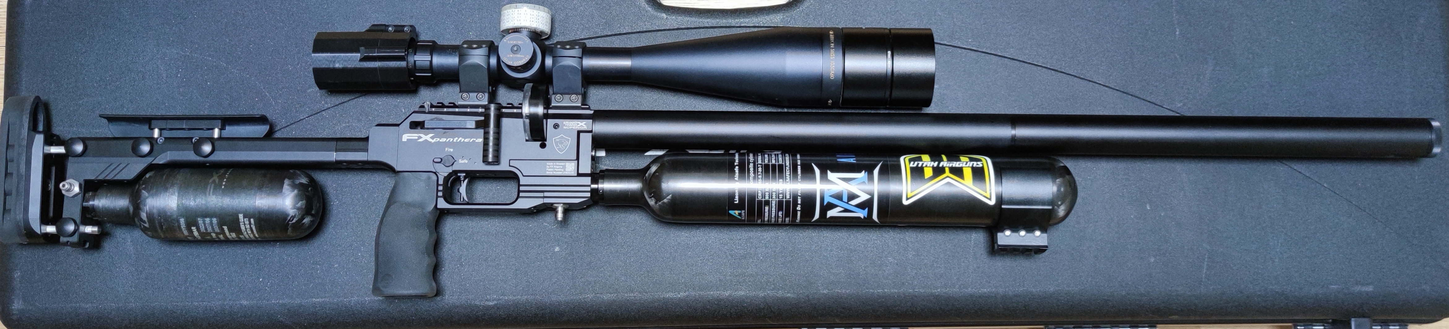

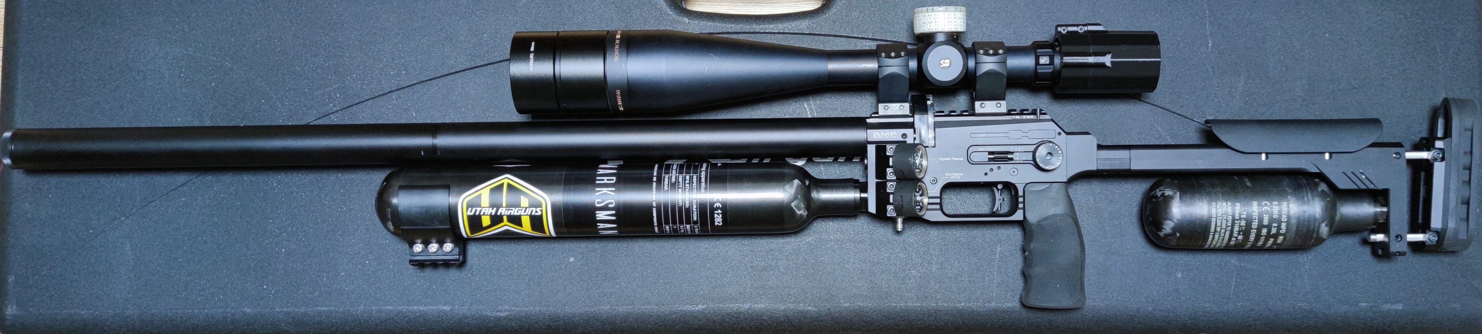

Hi, everybody! Let me introduce myself: Nikolay Boldov from Russia. Moscow, won Extreme Benchrest and American Field Target in 2019 (AZ, Extreme Benchrest) and 50 Yard Benchrest, One Gun Challenge in 2022 (AZ, Extreme Benchrest).
A few days ago, I’ve got my FX Panthera in .22 caliber. I consider this gun as a long range benchrest (150 yards) competition heavy slug (.22 40gr) shooter for my purposes.
My experience of slug shooting starts from 2017 when I began my experiments with 40gr slugs in .22 caliber, so I have a bit of experience in this topic.
I will try to describe my experiments, results, observations on this airgun in no-hype style with undoubtable (as much as possible) video proves here .

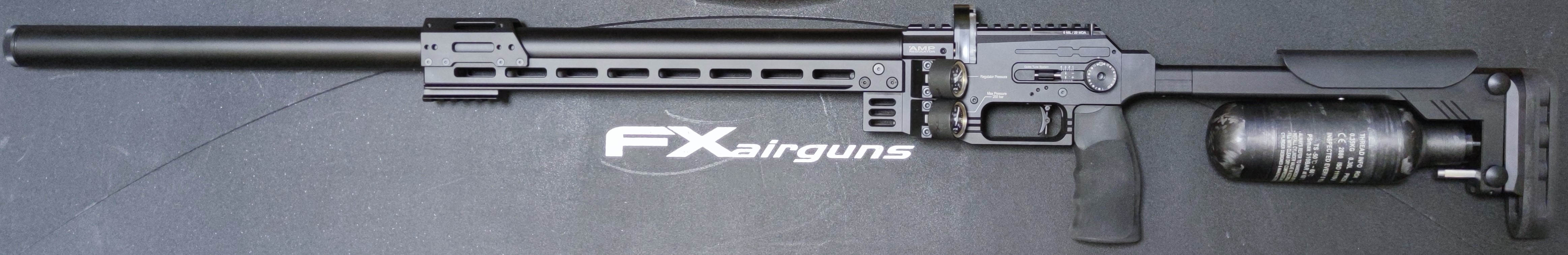

Part 1. First acquaintance with Panthera out of the box
I will not describe Panthera’s appearance and it's main features here (yet) as you can find it in other youtuber’s videos. I will share my tests and results here.
Note: I’ve made a mistake saying that tungsten hummer is installed in my Panthera in my first post in social media about this gun. No tungsten hummers yet – just regular one, so this version is straight out of the box, no modification was made.
So, the very first thing I wanted to test is what speed and how many shots can this gun give me with it’s 300cc bottle and huge (156cc) plenum.
The result is 25 shots in 250-142 bar with 40gr slugs at the speed of 273 meters per second (896 fps). Average air consumption is 11,3 cubic centimeters of air per joule, that is a very good result as for me taking into account barrel length and projectile weight.

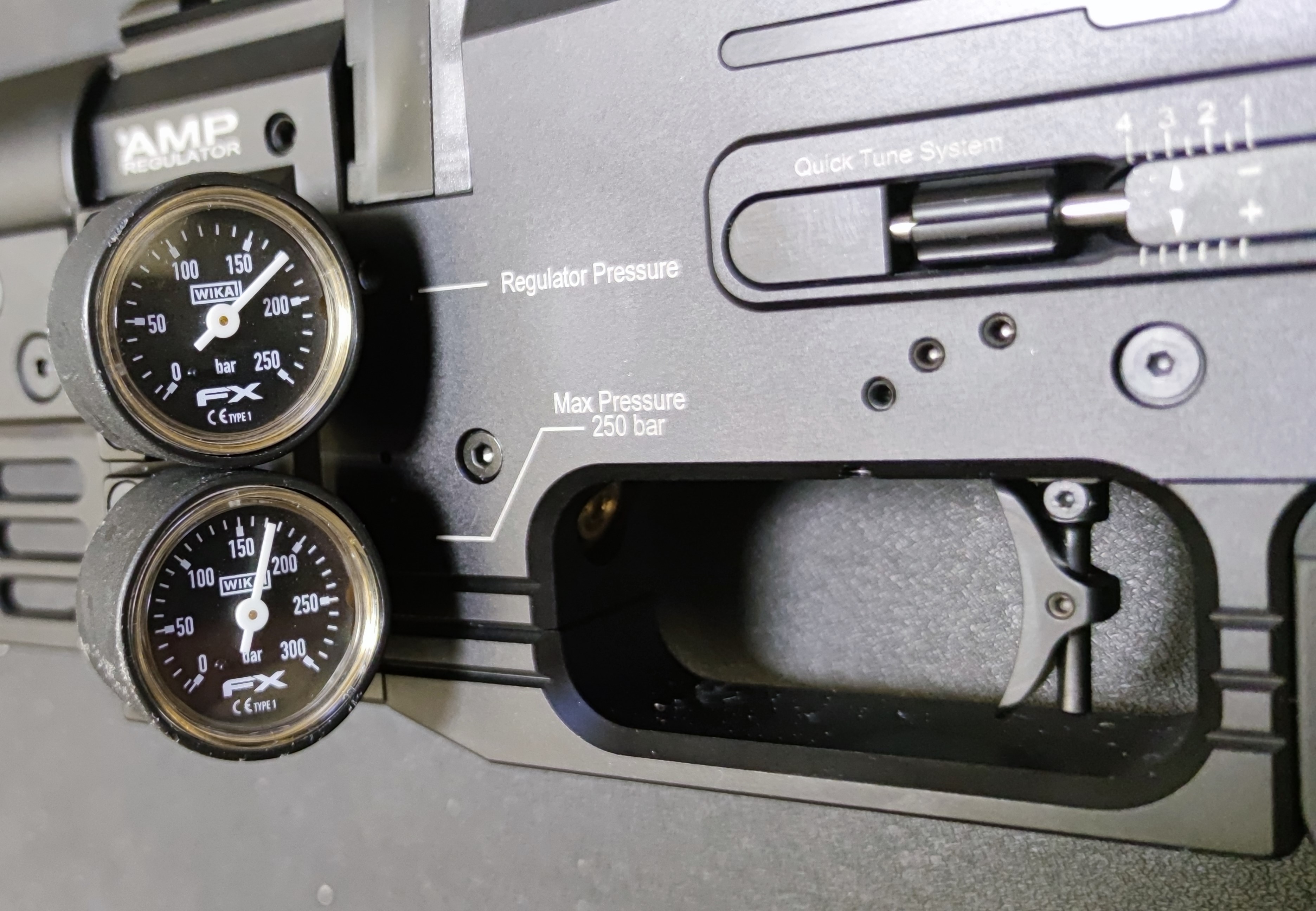

The next step I’ve taken to get acquainted with my FX Panthera in a better way is knowing it’s power parameters. My thoughts were the following. Panthera has a huge power plenum of 156cc and it is not an easy task to take it all out during shooting (at least this comes out of my previous experience with this type of airguns). And my thoughts were that using MAX hammer spring tension is not a bad idea, because on high pressures I usually use, the hammer can barely harm the valve. So, there is nothing bad in setting the hammer to maximum power level (that is a bit above 4 micro wheel settings) and testing the gun on different regulator adjustments.
I’ve made my tests on 120 – 200 bar with the step of 10 bar and made 4 shots on each to get average velocity of that setting. I’m not sure if using regulator on the pressures above 170 bar is “legal” so don’t try to repeat. 😊
Here is the chart of results that I’ve got (just to remind – 40gr .2185 slug)

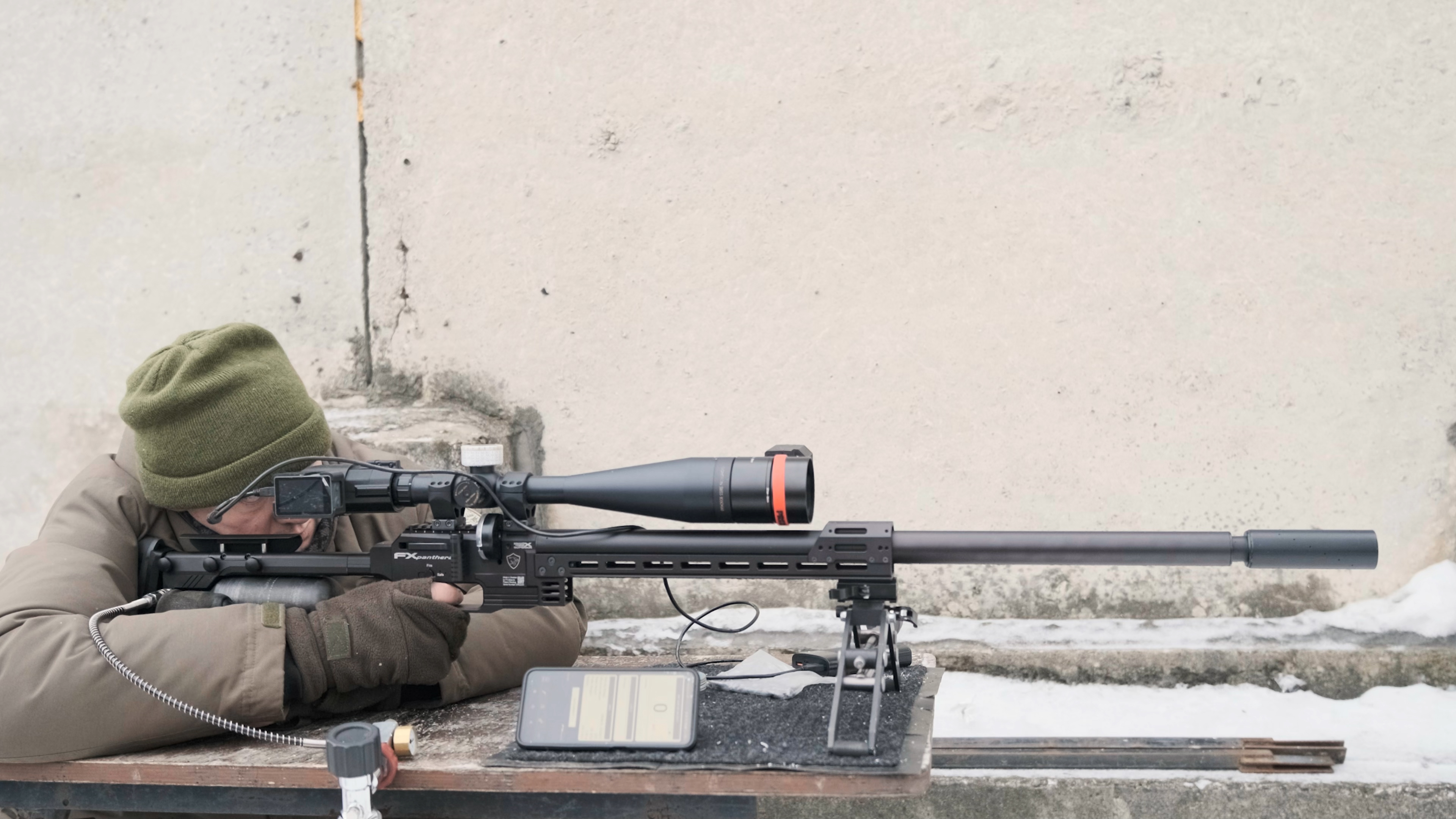

Past weekend was not the best to make accuracy tests outdoors, so I decided to have some tests and tuning indoors – in my workshop.
Is that a wise decision to use maximum hammer hit strike on lower reg pressures like 150 bar? Absolutely not. It will not increase the velocity of the projectile, but will raise your air consumption per shot to unreasonably high values. Here is what I’ve got during my test with reg pressure of 150 bar and 40gr .2185” slugs. 3 shots per every power settings were made and average result was put into the table.

So, as I got higher with micro wheel adjustment after 2.25 position, the sound of the shot became louder and the gun definitely vibrated much stronger every time. There is no need to go on higher hummer strike power – just the waste of air and destabilization of the projectile due to huge amount of useless air coming after it.
It is the simplest and obvious example of how it works. There is a curve of velocities going up, as we raise the hummer power from the lowest level, then you reach the maximum velocity and then stabilizing without any profits on velocity, but loss in air consumption. That is how it work with big plenums. Note: In case with low volume power plenum guns the curve will go down after the reached plateau of velocities if you will continue to increase hummer strike level.

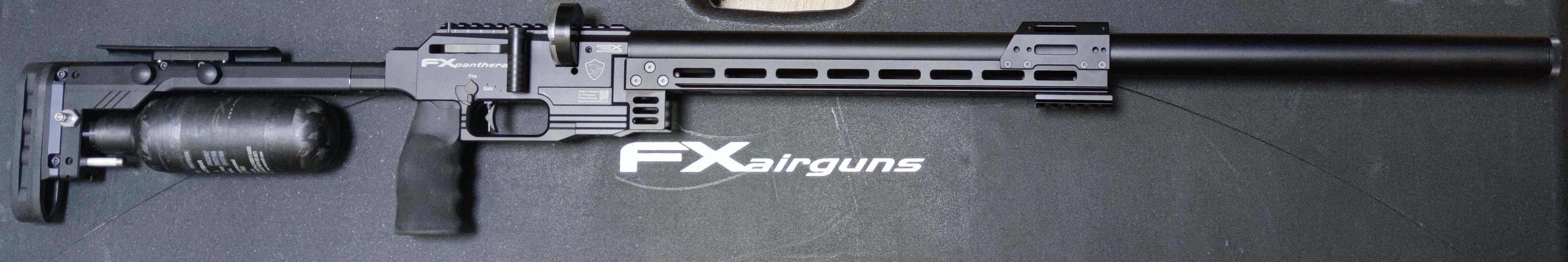

A little more perspective.....
FX Panthera 700mm OAL = 49 inches
Taipan Veteran Short OAL = 23.6 inches (x2 47.2 inches)
Well, I really do not like Bullpups for hunting there is really no advantage for me so I much rather take a longer gun with ton more power and a low profile .....anyday.
