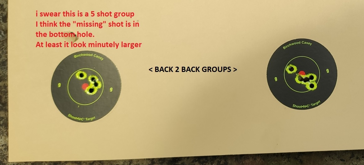

94 yards 700 mm Maverick - 13 gr Zan slugs
If we ignore both #5 shots ( that be the high and left hole ) not bad 4 shot groups.
That is 2" targets.
