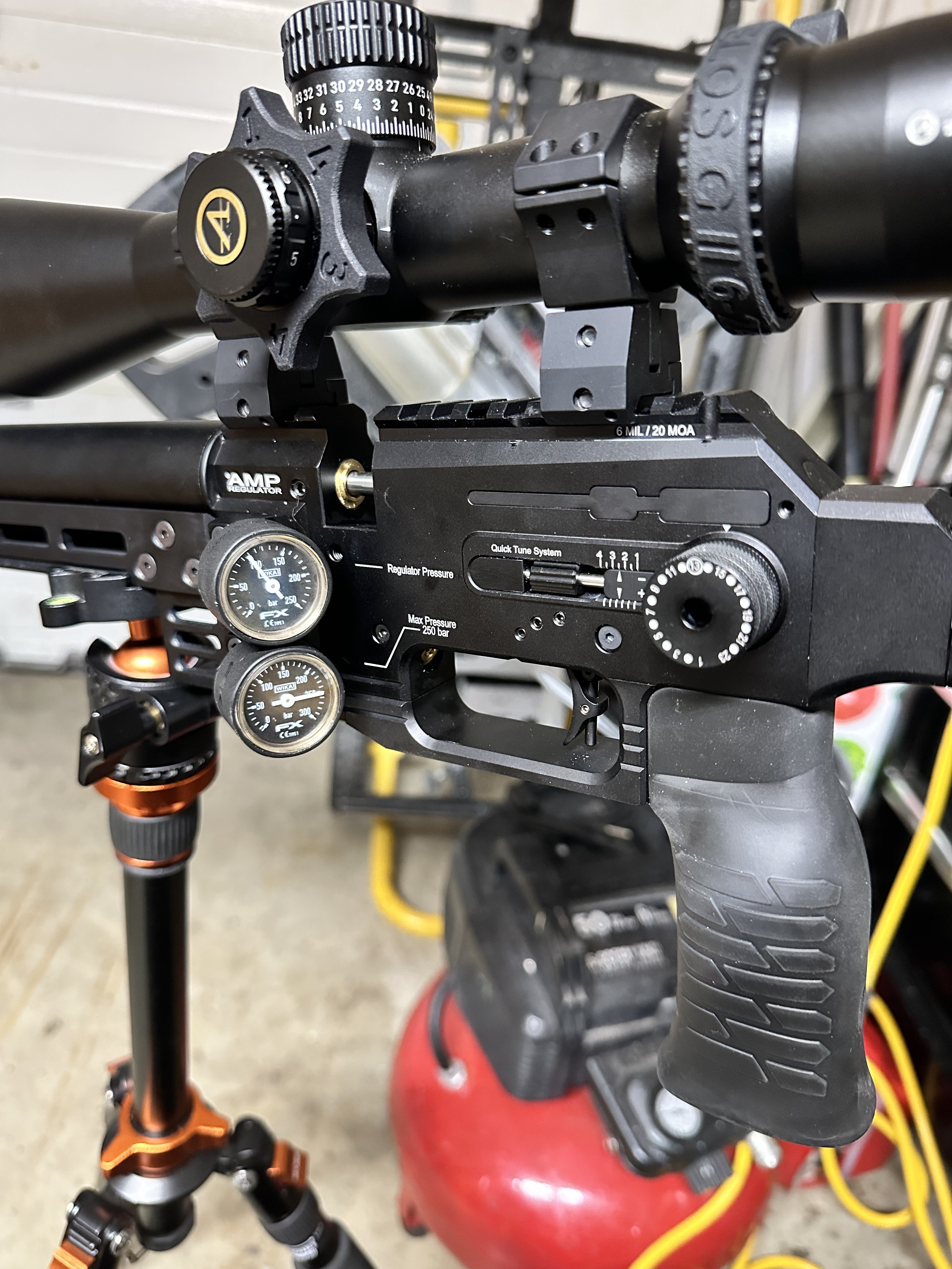

I haven’t got to shoot with it yet, but it is sure nice!! Weighs about 4 lb, but you talk about keeping the front end stable. As I set up the scope, the weight of it just made it so easy to hold perfectly still. It’s a little pricey, but so worth it as far as I can tell.

I would imagine the additional 4lbs on the front really adds to the stability of the rifle. I'm interested in your feedback after you shoot off of it.
