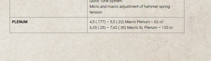

Someone suggested me to just buy the liner and the shroud to do the conversion since both the 500 and the hunter compact have a 62cc plenum. I did an online search to see if I could find the shroud for the 300mm but I haven't found it.
The Hunter Compact has a 120cc plenum while the 500 only has a 62cc plenum
I believe it's a 62cc plenum for the 22 cal on FX website and a 120 for the 25 and 30 cal.
