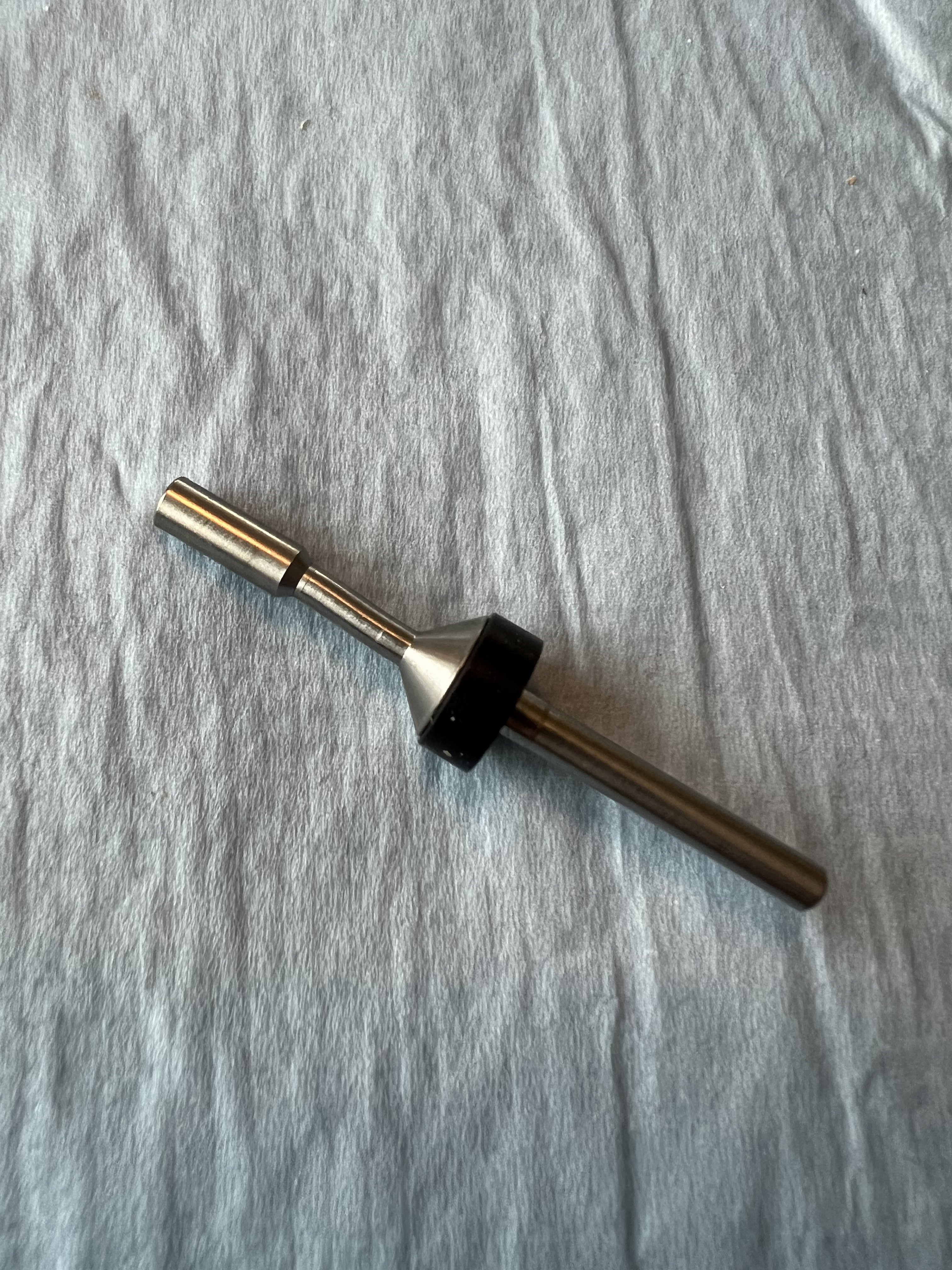

Looks like I found the reason . The valvepin is bent. Not sure why this happened. Now I have to get a replacement.

Sure looks like classic column buckling yield failure of the small diameter section, causing misalignment of the larger diameter bushing diameter section on the left end. I'm assuming the hammer impacts that left end. Either some overly heavy hammer impact, or possibly dry firing with too little air pressure in the plenum, or maybe the stem needs a different metal with higher yield stress? In case of overtavel of valve with insufficient air pressure, if the right hand end (return spring end) hits a hard stop, there could be big compressive shock forces in that small section.
I'm not completely familiar with this design, just generalizing. Would be interesting to learn the fix. It's a new design, sometimes stresses and failures don't follow what was imagined/chosen in the stress analysis during the design & prototype stage. Or, material supplied didn't have the specified yield strength and got substituted.

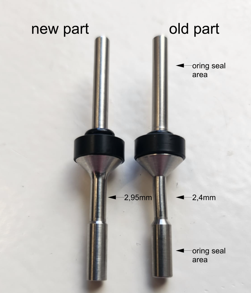

FX made a new valverod. Thicker in the middle. I got a new one yesterday and didn't even notice the difference at first.
I wanted to have a few made from stronger and thicker material. But now I will test these for a few thousand rounds and see how it will hold.
Be sure to polish that puppy slightly before installation ;)

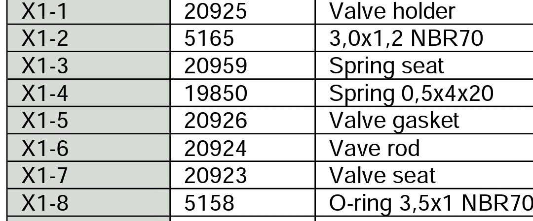

Do you have the exact part number?
They've just recently started selling valve pins over on Europe Airguns but the picture is a stock image of the older one, so I've held off for now in case.
It's the x1-6. If u want to order one, just use my picture with the new and the old one on it. They can measure the thickness.
