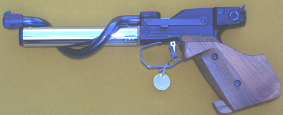

(This picture just come in my mind :D if this could shoot well I hope there will be no problem with the panthera.)
Reactions: Bernie7
