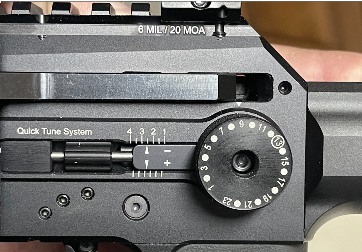

Hi. Only shot a few at 25yds and pretty much a 1/4" hole for four shots. Jammed so much I didn't shoot more. Just finished the magazine so I'll test some more today. Reg at 150bar, macro at 17, micro at 4. I'll get back to you after some 50yd targets. Too much wind now, usually calms down in the late afternoon. Hopping. Bill and Addi

Hi. Just ran FX Hybrids, Zan .217, Impulse. 217 and NSA 20.2 .216. At 30 yds. Not real impressed with results. About 1/2" group was the best. That was with the Zans and the Impulse. NSA @ 275mps all others in the 264mps range. My shot count is not close to the 60 Ted reported. My tuning may not be balanced, so I'll go back and returned tomorrow. How is your shot count? Reg pressure and macro hammer pre- load? Thanks, Bill and Addi

2" @30yds-yikes. My original tune was 145 reg, 13 macro and 3.2 micro, Ted's tune. That didnt make the 900fps he recommended, so I maxed the hammer and started bringing up the reg 10-15 bar at a time. At 150bar, I got a bit over 900fps. Then started backing off the hammer one step at a time. Ended up at 17 macro, 3.5 micro. I understand each rifle will be a bit different, but 2" @ 30yds and 1/2" @30yds is baffling. I'm going to retune tomorrow without the moderator. I have 2 other ones I'll try to compare. I'm hoping to get the Impulse slugs to 890fps. Not sure she can do that, but I'll find out. I think the 25.4gr pellets will have more fpe, so I may go that route. Anyway, I'll get back to you sooner than later. Bill and Addi
