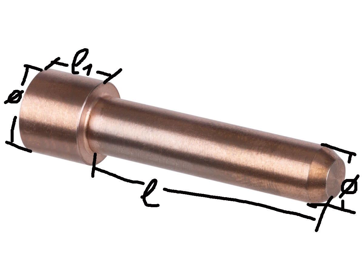

Hi all, please, could you tell me the measurements in mm and the weight of the Fx Panthera hammer
Thanks in advance
Did you ever get the measurements I could sure use em...
hammer weight original FX, i have Panthera 600mm cal .22
l1+l=37mm
l1 It depends, I have the 4mm version which weighs 11.47 grams
head dia 10mm, small dia 6.7mm
I purchased two hammer weights from Huma and they have a total length of 39mm, the diameters are the same
now I use the original hammer weight with two washers from the impact slug kit, I increased the weight to 12.32 grams, the power wheel is more modulable. With a reg pressure of 135 bar, wheel 17, HN 27 grains at 1010 FPS
