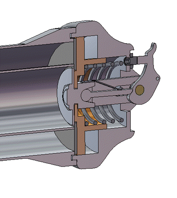

Also the shroud there is an air tube, super strong then you also have a barrel band,....win, win, win.

150 bar is 153 kg/cm2, and if its still 14mm barrel house that will be a 1,54 cm2 piston in each end, so the 153 kg/cm2 x 1,54 cm2 will be 235,6 kg of force on each piston in each end, so that x2 will be 471,2 kg of force, imagine that you cut the barrel in the middle of the plenum and it was massive, then you will have a piston in each end pushing 235,6 kg because there is only atmospheric on the outside of the plenum to work against that pressureHigh pressure air exerts a lot of force. I've not heard what reg pressures they're talking for the Panthera, but even 150bar is an immense amount of force. So I can sorta see their theory, the constant inputs and removal of that air, as well as what happens to a scope zero when degassed and then refilled, is where I begin to question the repeatability.
