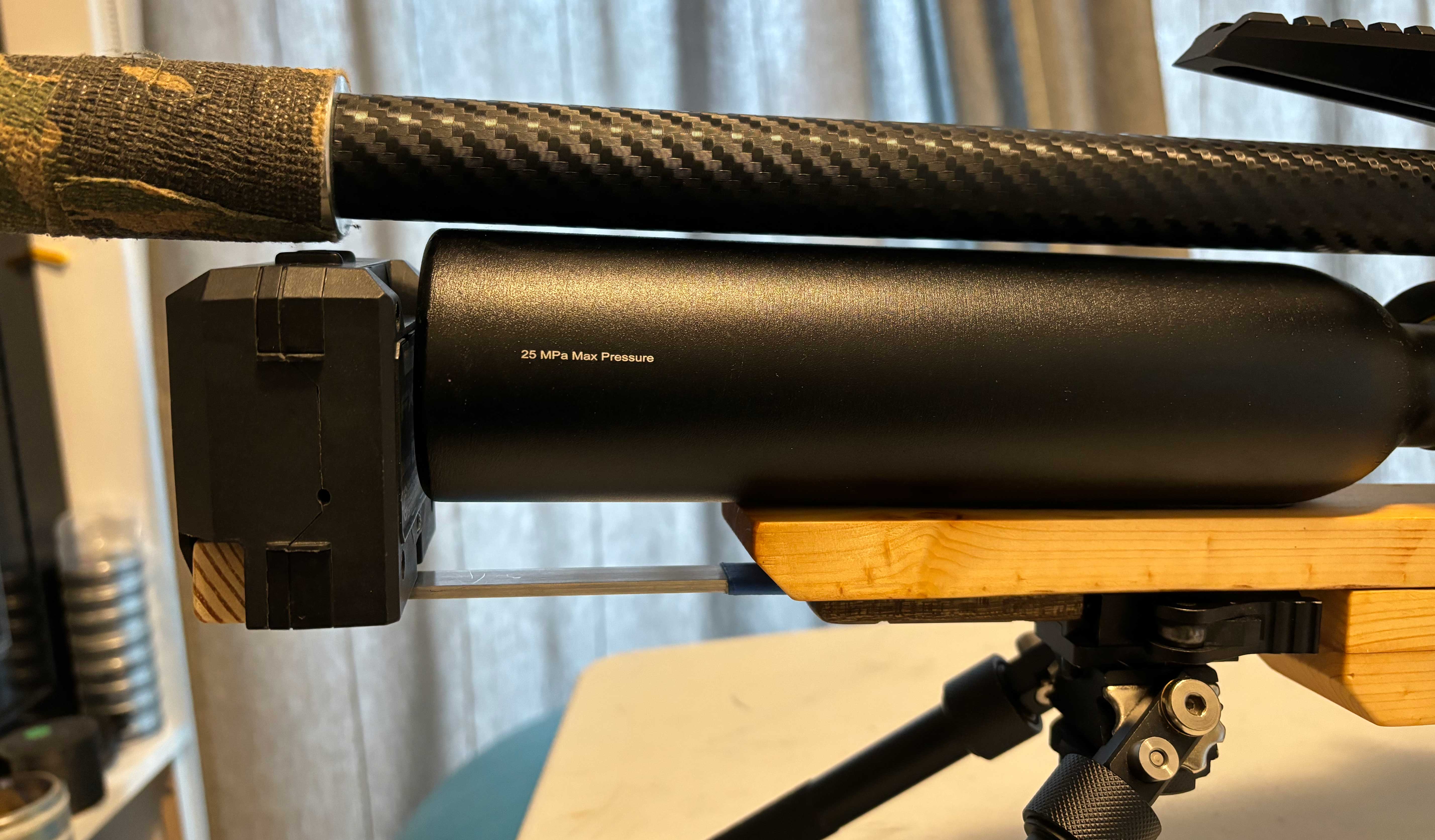

How are you positioning your FX Chrony? Are you attaching it to the barrel or bottle? I have tried in the past by placing the chrony on a mini tripod directly under the barrel. It worked but I still got some missed readings. I solved my problem by creating a mount directly under my bottle/barel where I can place the chrony in the same spot all the time. I haven't had any missed readings since.
Here is a picture of it. I have modified it to fit under the Snowpeak M60B.
