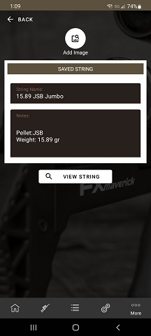

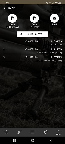

How are people getting readings over 1099 fps on these when fx states on their website:
https://fxairguns.com/accessories/pocket-chronograph/
"Keep in the mind the Pocket Chronograph is not just for high powered airgun use. Any projectile travelling under 1099 FPS can accurately be tracked. The Pocket Chronograph is perfect for archery, CO2 rifle and pistols, airsoft, slingshot, paintball and more."
I think i have seen speeds over 1100 FPS on the pocket chrono,,,,,, speeds i of course instantly backed off CUZ DAMN my moderator suddenly dident work right. :)

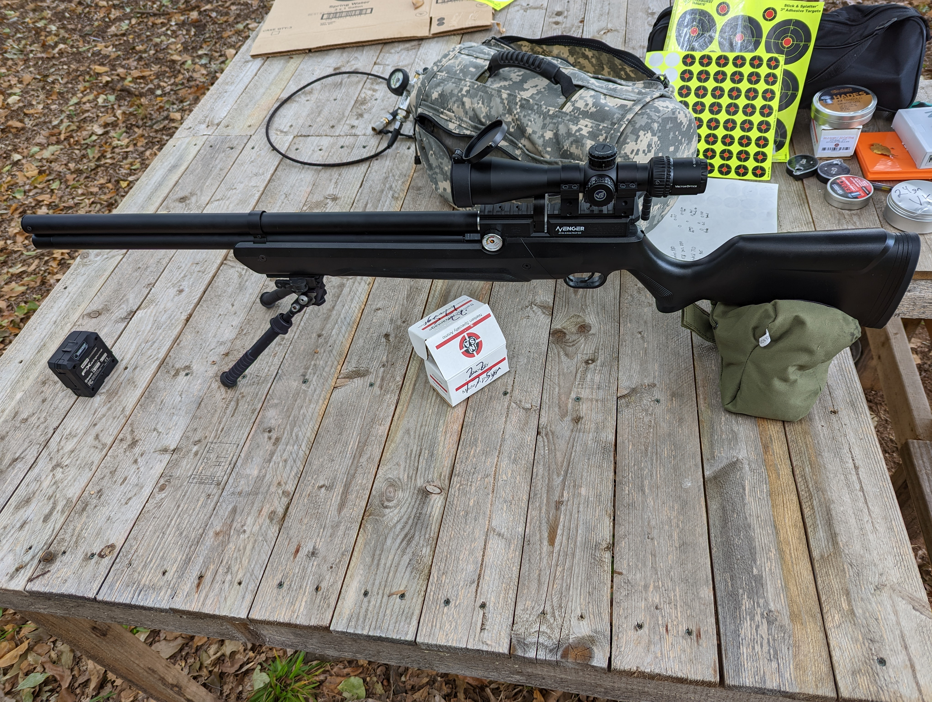

I generally put mine on the barrel, but i have also used it on a small tripod on the table below the barrel, on my vulcan 3 i need to have the chrono out to a side as there are no room for it below the barrel due to the air tank.
Tweaking in my living room some times i just put the chrono on the table, where my rifle then are propped up in a half hazard way, here i do some times get 0 reading but it is also only 10 feet to the pellet trap.
