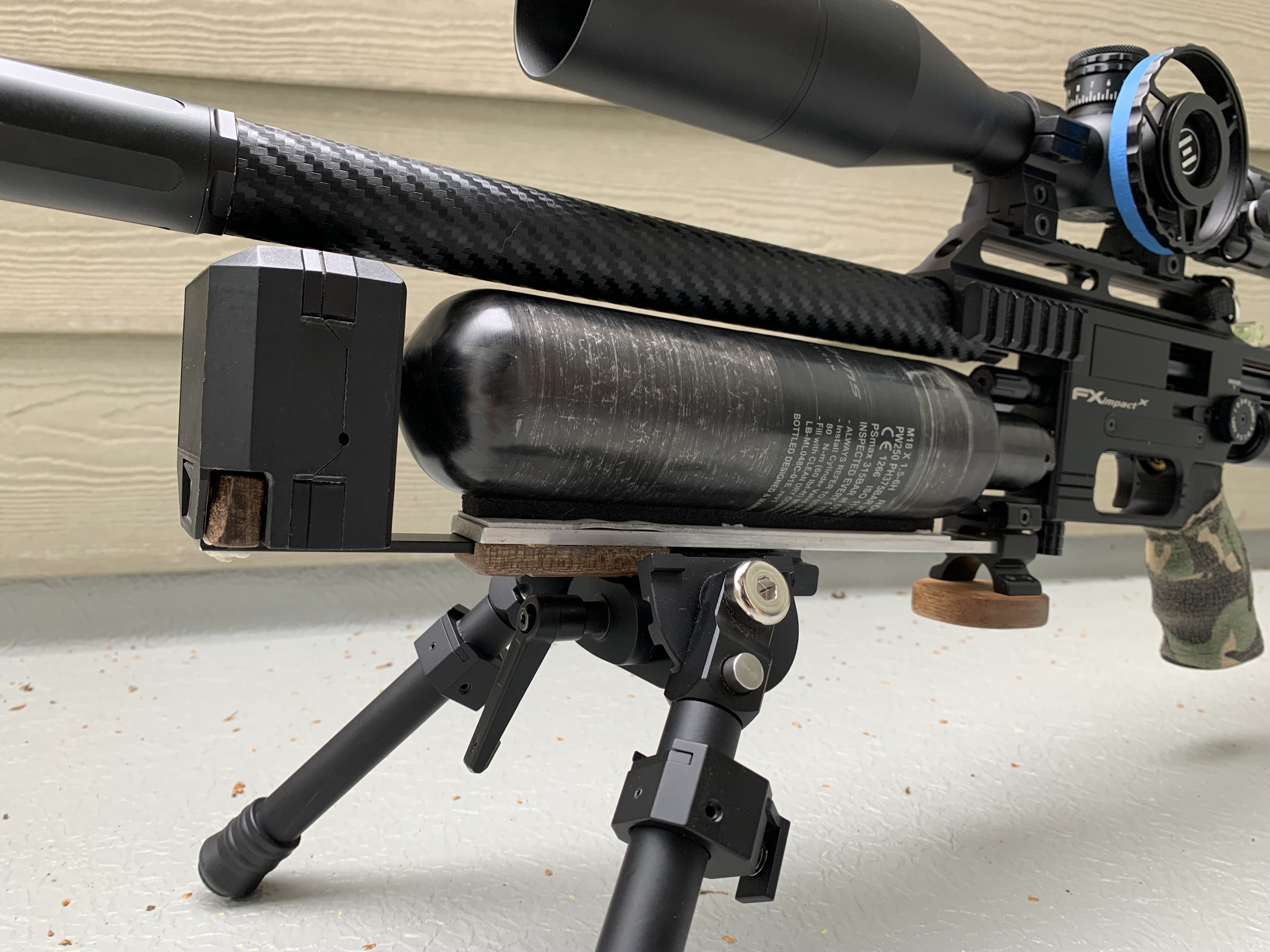

You can place the unit on a small tripod directly under the barrel but I find it cumbersome sometimes as you need to line it up perfectly each time. So I did a DIY system where I made a rail and have the unit (removable) mounted under the barrel.

So, how far is too far? I've noticed that it likes to be back a bit, 4" - 6" to enter the cone. Also being more on the same plane, or close to it, as the barrel seems to help.
According to the radar instrumentation guy I used to work with, the radar should be as close to the barrel as possible. He always had them alongside the barrel unless something else was in the way, in which case it would go below. He was always careful to line the radar up with the barrel. It was usually a few inches behind the muzzle.
As he was a recognized world-class expert on tracking gun projectiles with Doppler radars, I just followed what he said.
