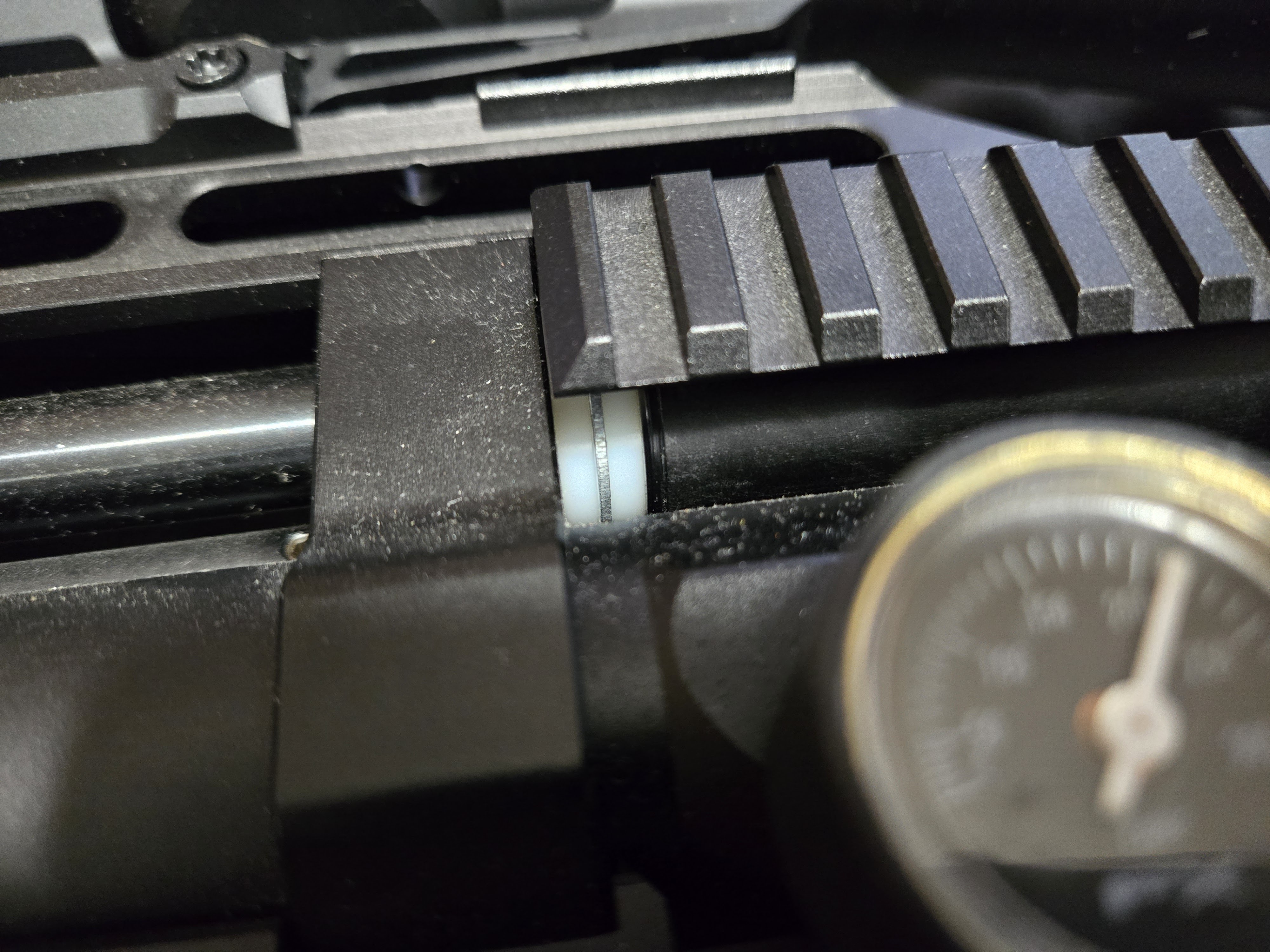

UPDATE: I tightened my jamb nut again, left the 10 o rings on the liner and decided to go a different route. I have the compact so I did not think "barrel bump" or shift was an issue, but turns out I may have been wrong. I added spacers (see pic) between my shroud and the block. 2 nylon with one steel one in the middle, but only because that's what I needed to achieve the desired thickness. Of course then I had to rezero, that made the poi much higher, like 5-6 inches higher at 40 yds. It seems to be working, no poi shift in 10 days now. Will update again if it fails but I think it's good now. And it only took me a year to figure it out, lol.
Unfortunately your nylon and steel spacers have a different expansion and contraction rate than the aluminum your gun is made out of. Not to mention the thickness of the aluminum on the block versus the thickness of aluminum on the shroud. Your gun probably will be more bump proof but if or when your gun sees temperature swings, don’t be surprised if you have POI swings.

The attached pictures were 859 fps AEA 45 gr pellets @ 40 yds, 5 shot groups. When I speak of POI shift, I'm not talking about shots being randomly scattered. I'm speaking about these groups as a whole shifting randomly and needing to rezero for this (see pics). In my case, my gun came shooting 840 fps and every once in awhile I would need to adjust the scope a couple of clicks and it was good for awhile. To be honest, I thought it was the cheap scope I had. Once I got a chrono, I started adjusting reg pressures for faster fps. After increasing speeds I needed to rezero much more often, just about every day. I replaced the scope, same issues. Then I started looking into this further and discovered other people were having the same problem. I pulled my barrel liner and it had 2 orings. I ordered additional orings from Utah Airguns and the cf sleeve. I put the cf sleeve on and lost my tight groups. I did not epoxy it, and it felt a little loose, not a tight play free fit. At that point I wasn't ready to glue my liner in, so I went back to the orings. I ended up using 10 orings evenly spaced with a double in the middle, using Teflon tape beside them to help keep them in place. Same result, good for a couple days and then off 1/2". I couldn't find a solution on the internet so I decided i needed to rethink this. Something has to be moving, but what.
Here's my theory I came up with. In a perfect world a perfectly straight barrel would be ideal. In this system the liner is between the jamb nut and the block. When tightening that jamb nut, if the distance between where the liner touches it and the block is less than the length of the liner by even a mm the liner has to arc. Under tension with an arc in it is force that could cause it to rotate slightly, or arc in the opposite direction. Either of these would change the poi. My jamb nut was fairly snug but not too tight. I loosened it to what I would describe as 1/4 snug. Finger tight then just barely tightened with a wrench.
It's only been a week now but it is shooting like a laser and I have had no need to rezero. I think the 10 orings is probably overkill, but i would use at least 3 or 4. I also think the cf liner may work if epoxied. I hope this helps someone, i know i spent countless hours trying to figure it out.
Full disclosure, I am not a certified technician, just a hillbilly striving for perfection.
