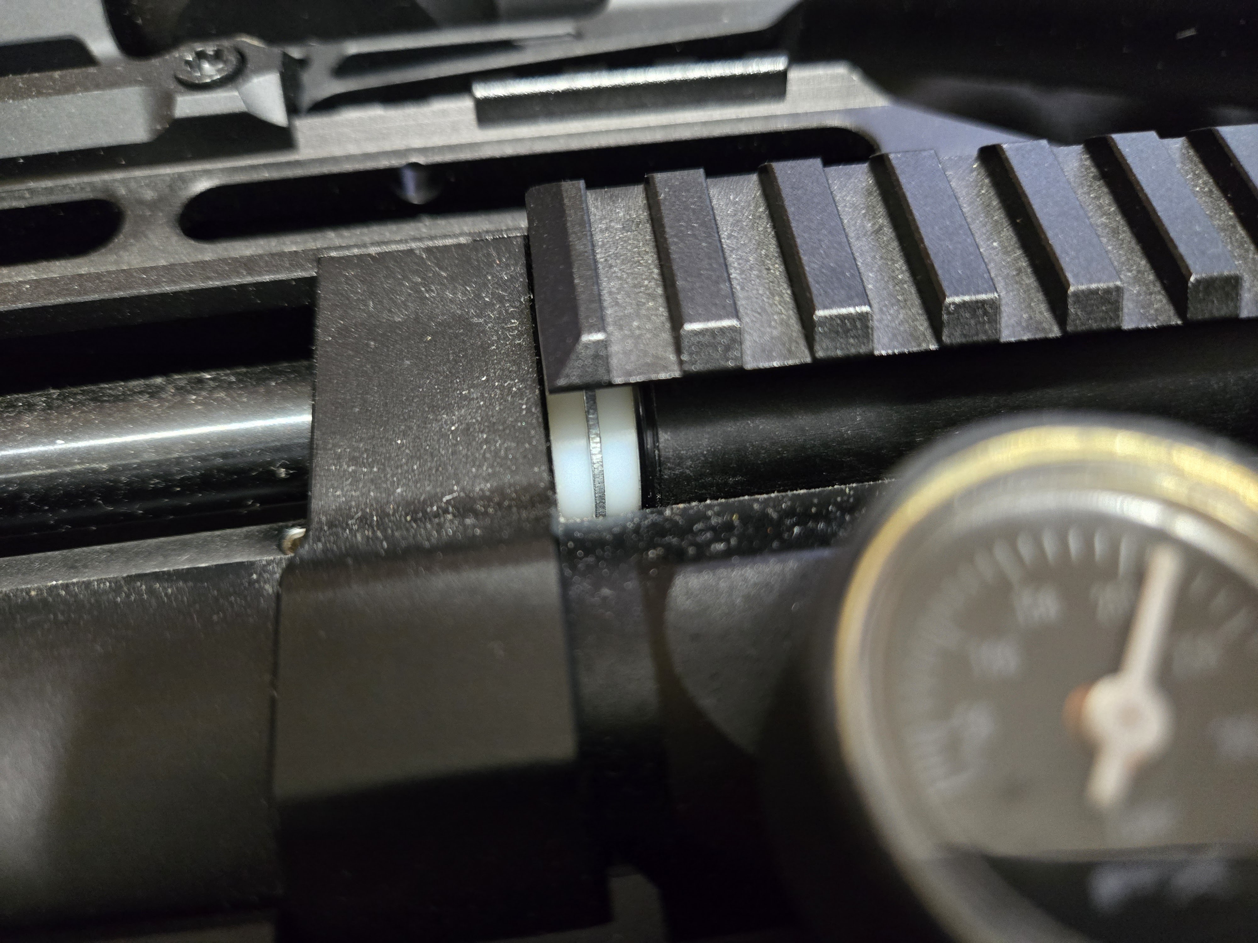

I'm not sure how the impact design compares to the Maverick design. But on the maverick , there is a small gap between the shroud and the block. I placed these washers in there to create tension when i'm tightening down the shroud and it solved my POI shift.
