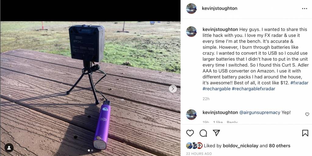

I shared this on Instagram the other day and thought some of you here might like it too.
I swapped out the AAA batteries in my FX radar for the Curt S Adler AAA to USB converter that I bought on Amazon for like $12. By doing so, I never have to change batteries again…Instead, I just use any of the many USB chargers or larger capacity batteries we have laying around. It works great, costs only $12 and the batteries I have been using last all day. It’s cheap and makes the FX Radar even more convenient.
Have a great weekend!

You know, Christian asked me about the voltage yesterday and I may have responded too quickly. The USB batteries I’ve been using are all 5v and work fine. I’ve got probably 16 hours of use so far without a problem. As far as stepping down to 4.5v, I don’t think so.
Really all this adapter is made of is three battery looking pieces that are the size of three AAA batteries, the three wires and the usb cord. It’s just a connection, very simple. It does work great though, especially for $12.
As Fx as overheating or whatever, I didn’t read the review but would assume it’s either a short or the battery. I taped the wires to make them more durable and don’t have a battery attached if I’m not using it. I unplug the battery, it’s too heavy to leave hanging from the wires hen I transport it. The other option would of course be standard rechargeable batteries but I don’t want to take the rear cover on and off every day.
As far as mounting it to my tripod, mine is threaded, so I just screws it on.

Oh, I forgot… I taped the wires to the leg of my little tripod so I don’t accidentally pull them out. Probably a good thing to do if you buy one.
