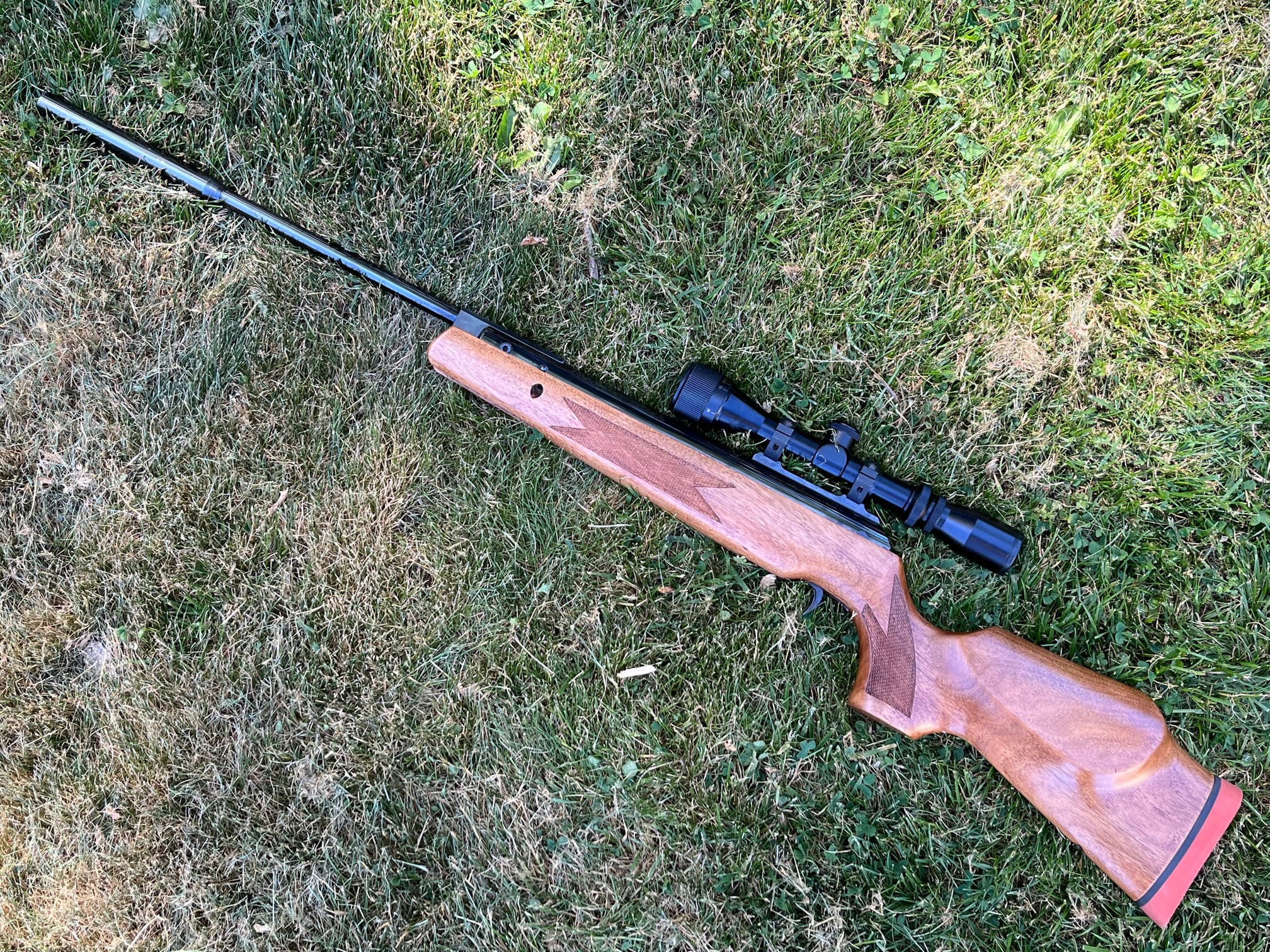

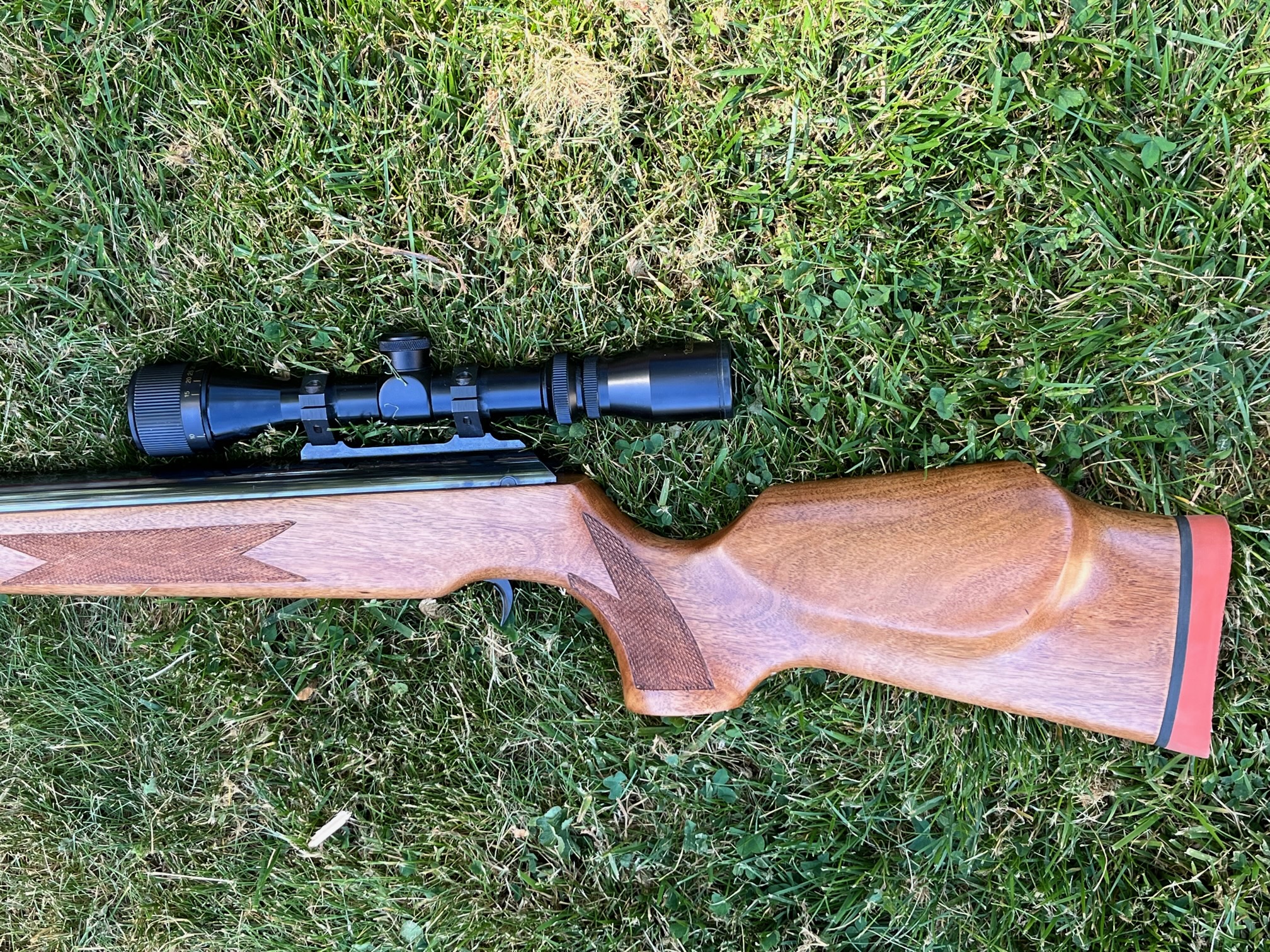

A couple weeks back, the summer was getting hotter and I decided to take on a 'project' with one of my air guns. I wanted to try to refinish the Walnut stock on my FX Royale 400 .22, which was virtually perfect, and there was absolutely no need to do this....I just wanted to try it and see if I liked it.
A friend of mine ( ELH ) had just finished a partial restore of his air gun stock and I got interested in the process. I watched a bunch of "True Oil" stock finishing YouTubes and read through some forums on the approach. I have never ventured into any type of wood re-finishing or restoring before, so I thought I would give it a twirl. Wow, what a lot of work! Between sanding, applying many coats of True Oil, using 0000 Steel wool, etc.....I realized this was a slow process.
However, I could not wait each day to get back out to the garage work bench and sand/apply another coat after 24 hours of drying time. I probably went a bit over board on the finish, but I do have a heavy hand. I read somewhere it is better to apply many very thin/sparing coats of True Oil then to try and glob it on. Anyway, I enjoyed the venture.
Have to say, I made a ton of mistakes along the way, but Ed coached me quite a bit and I hung in there to finish the Royale. Now that I finished one of my guns, I may do this again on one or both of the Anschutz .22 LRs at some point, but maybe not also.
Anyway, here are some pics, and for any of those who have not tried this, I would encourage you to give it a whirl.
Tom
