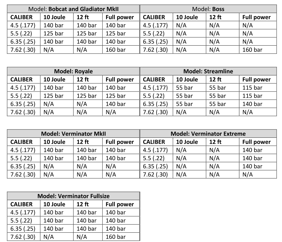

Here's FX recommended starting points, hope it helps.
Looks like 140 bar
Reactions: SilentSquirrel
