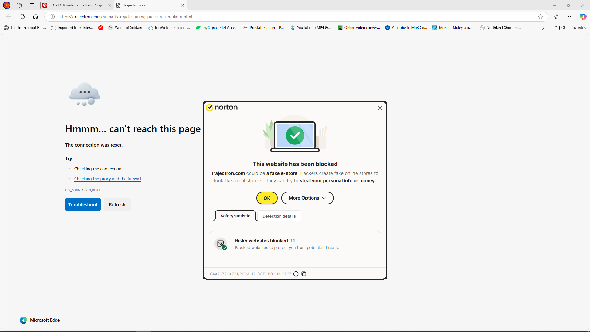

Run away Steve, run very far away. Maybe. This is what my computer security said about the link you posted.
