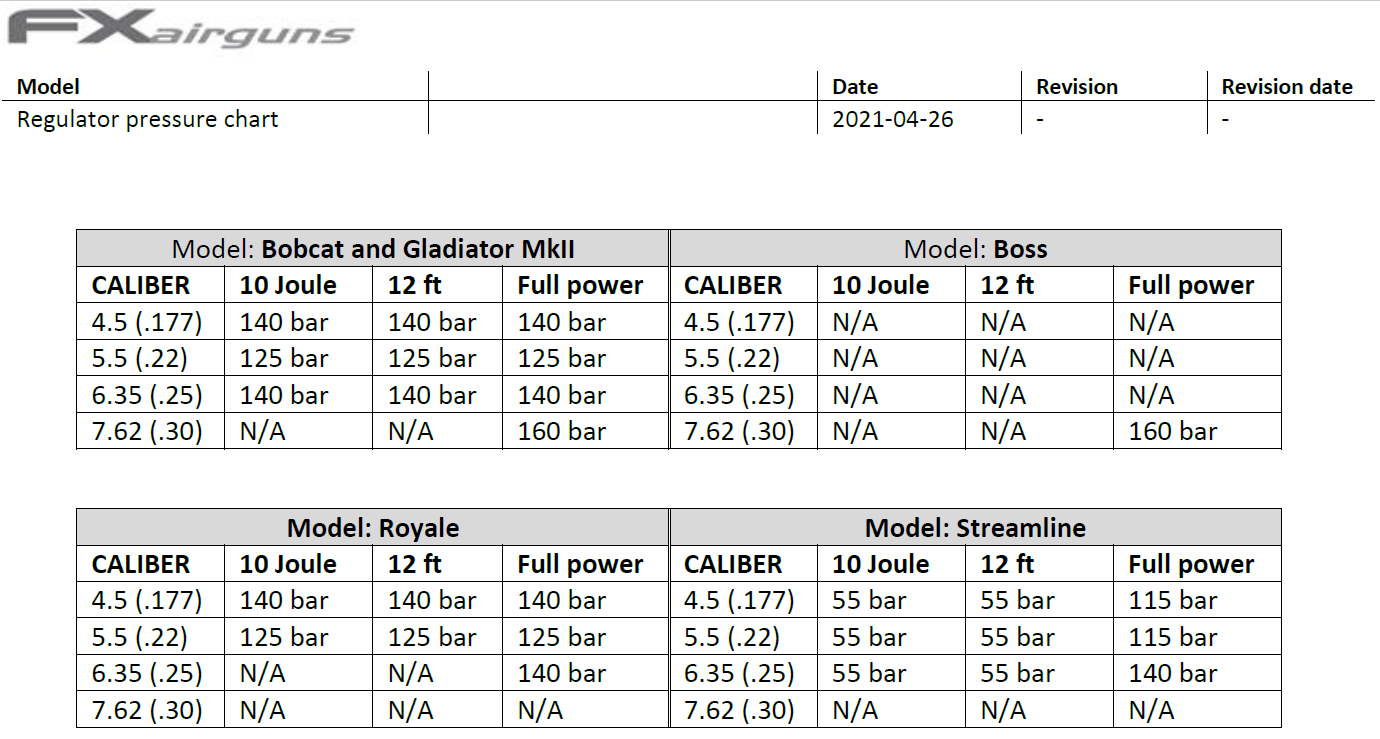

FX Royale question-what's the reg setting in .22 caliber?

I saw your reply-Thanks for that. I have no intent to mess with the factory setting, I'm just looking for a ballpark idea of when to refill. Once I get my tanks refilled I'll do a full string with a chrony and then I'll know for sure. How many shots do you get on a tank before needing to refill?

They aren't as consistent as you might think. You really have to shoot it down and see. My guess, around 140. The reg that came in mine was not good, and I replaced it with a Huma, but the table on the reg is not accurate, so I don't know where it is. It's shooting the 18 g JSB around 890, which is approximately 95% of the max at the current setting. I think I get at least 50-60 good shots, probably more, starting from a 250 fill.
Yeah I'd think 130-140
