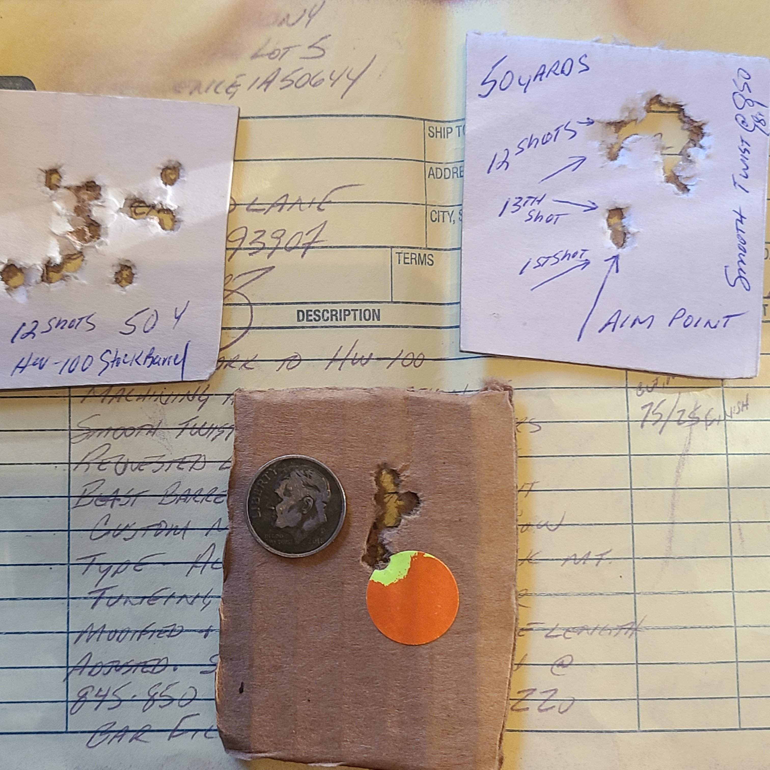

AZ put one on my HW100, I believe he sleeved it.
Here's an example , before and after, top targets were shot at 845-850 fps, the lower target at 910-915 fps at 57 yards. JSB, 18.1

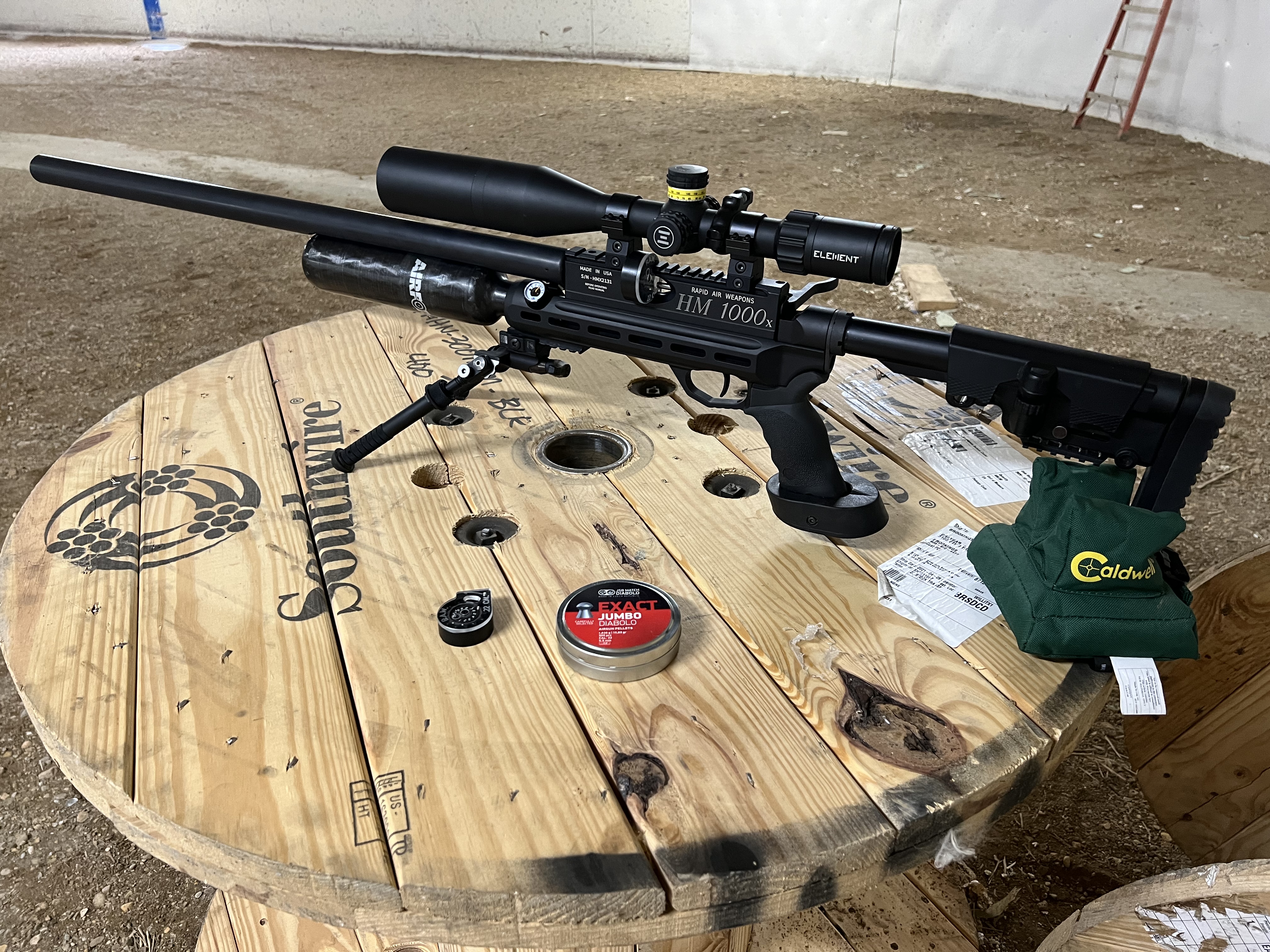

Yeah….I have a superior .22 liner in my hmx
Had AZ build it. He permanently bonds them into a 16mm thick walled steel tube.
Then I had him install his one piece alum shroud/ moderator.
This is the shroud this gun should be shipping with. Nothing compares.
I shoot 20.2gr nsa slugs…very happy with the overall results
