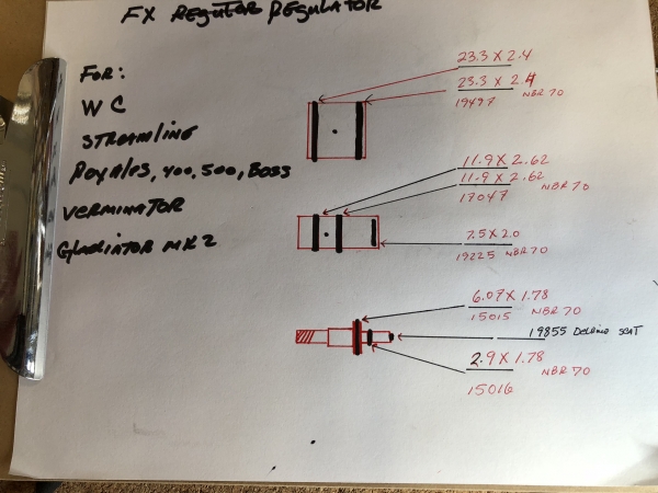

Hi can any one tell me the inside reg o'rings size for the streamline reg plaese
M Marcooliver Member Aug 24, 2018 6 0 5ta region Sep 23, 2018 Add bookmark #1 Sep 23, 2018 Add bookmark #1 Hi can any one tell me the inside reg o'rings size for the streamline reg plaese
C capefeargunr Member Feb 21, 2017 94 3 Oak Island, NC, United States Sep 24, 2018 Add bookmark #2 Sep 24, 2018 Add bookmark #2 Try this. Upvote 0
C capefeargunr Member Feb 21, 2017 94 3 Oak Island, NC, United States Sep 24, 2018 Add bookmark #3 Sep 24, 2018 Add bookmark #3 Oops. Didn’t post. Upvote 0
