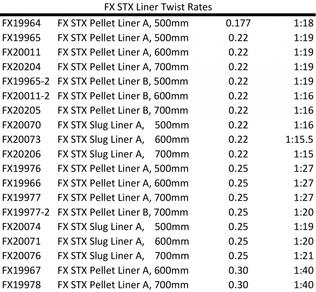

So the "old" STX I got with my .25 impact a month ago is listed as 1/30, slug liner is 1/20 and the new STX superior is 1/23?

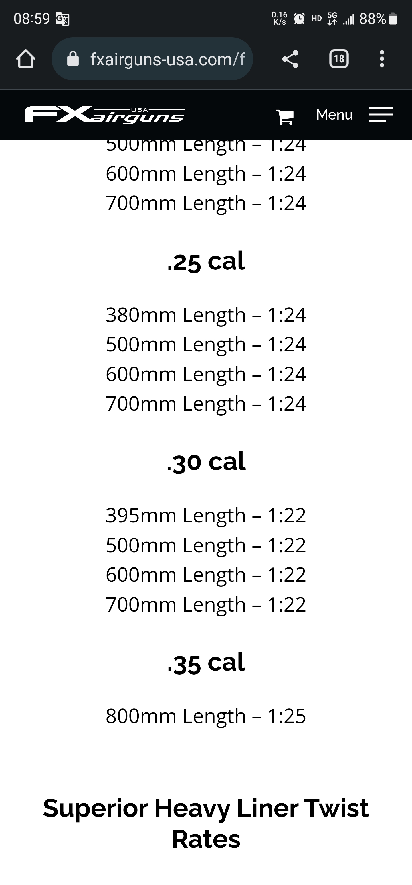

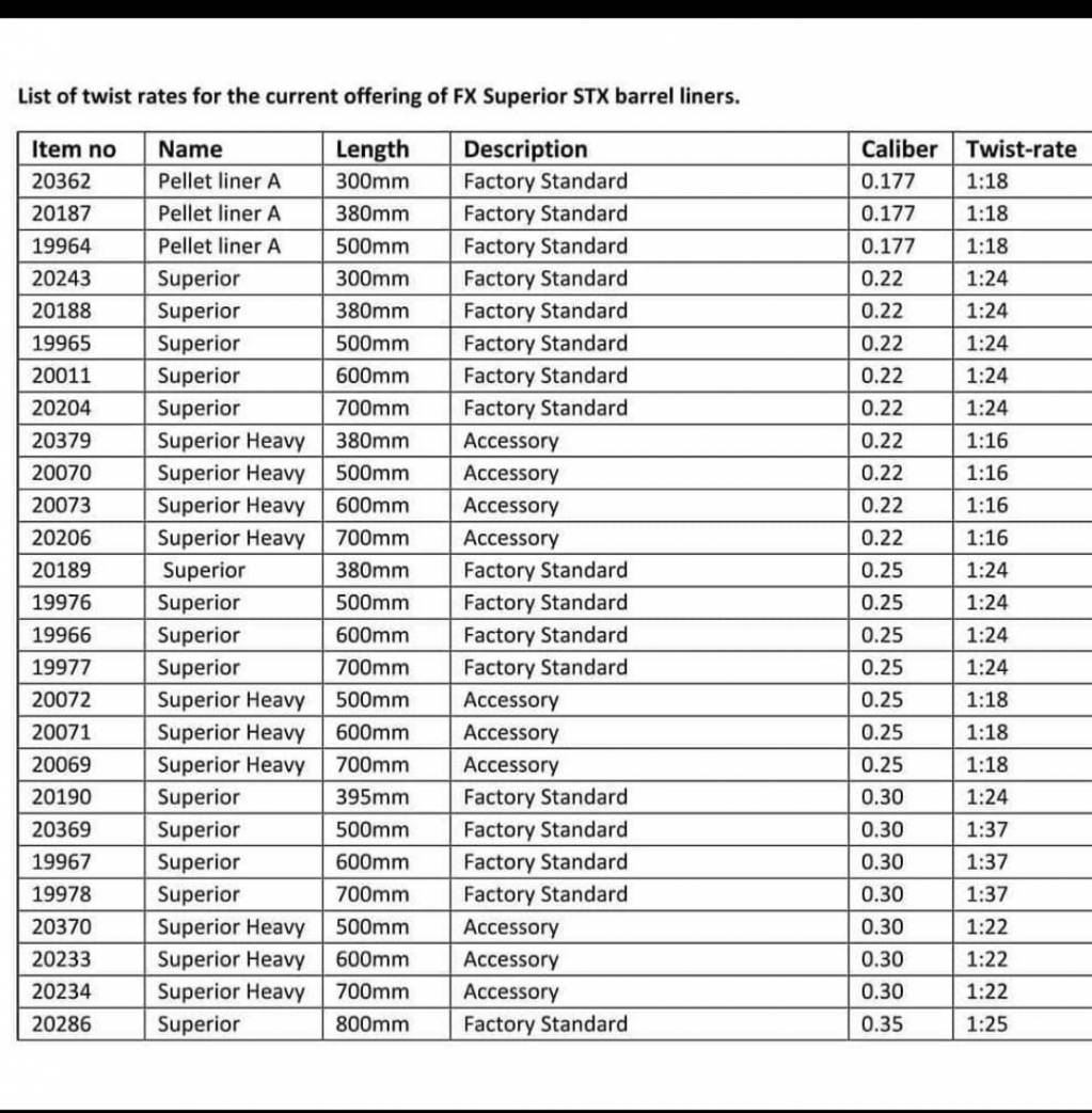

I have a FX STX .30 cal 700mm Slug Liner A. What is its twist rate? I don’t see it on any list. Also FX posted this on there Facebook page for the .30 Hybrid slugs.

To better tailor their barrels to shooting both the .30 Hybrid and standard .30 Cal pellets, FX Airguns has further advanced and adjusted the specification of their .30 Caliber Superior Standard STX liner. All .30 caliber rifles now being produced by FX Airguns will come with a Super Standard STX liner features a 1:26 twist rate. This liner will shoot both standard .30 Caliber pellets and .30 Cal FX Hybrid Slugs exceptionally well (as well as other light weight .30 Cal slugs).
The older Superior Liners shipped with previous .30 Caliber rifles are now called the FX .30 Cal Superior Slow Twist Liner. These feature a slower 1:37 twist rate ideally suited for long distance pellet shooting (particularly in windy conditions). Both liners serve their individual purposes and will be offered through FX dealers.

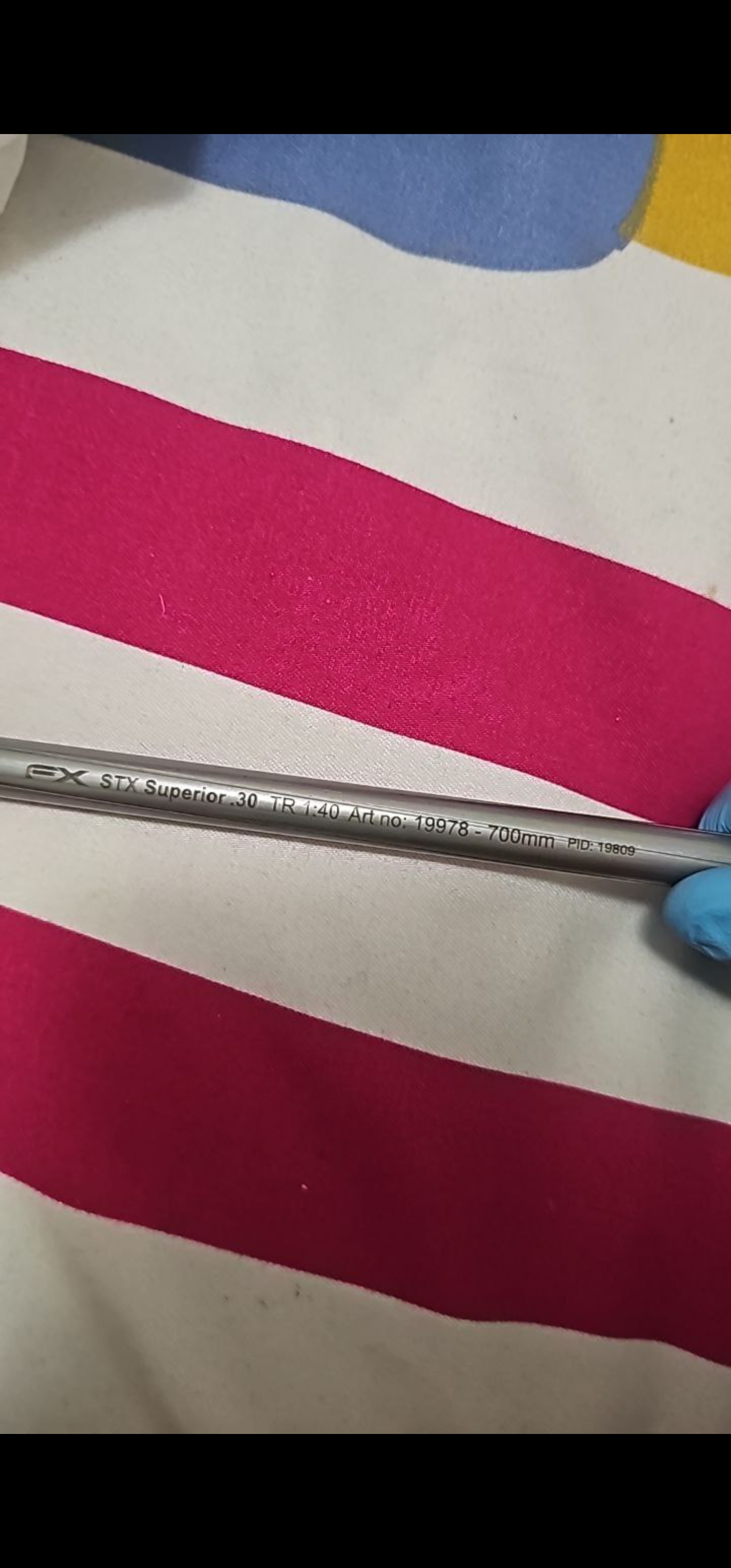

The .30 cal sniper version I bought, the factory barrel is the standard version of 700mm, but the twist rate is 1:40,
