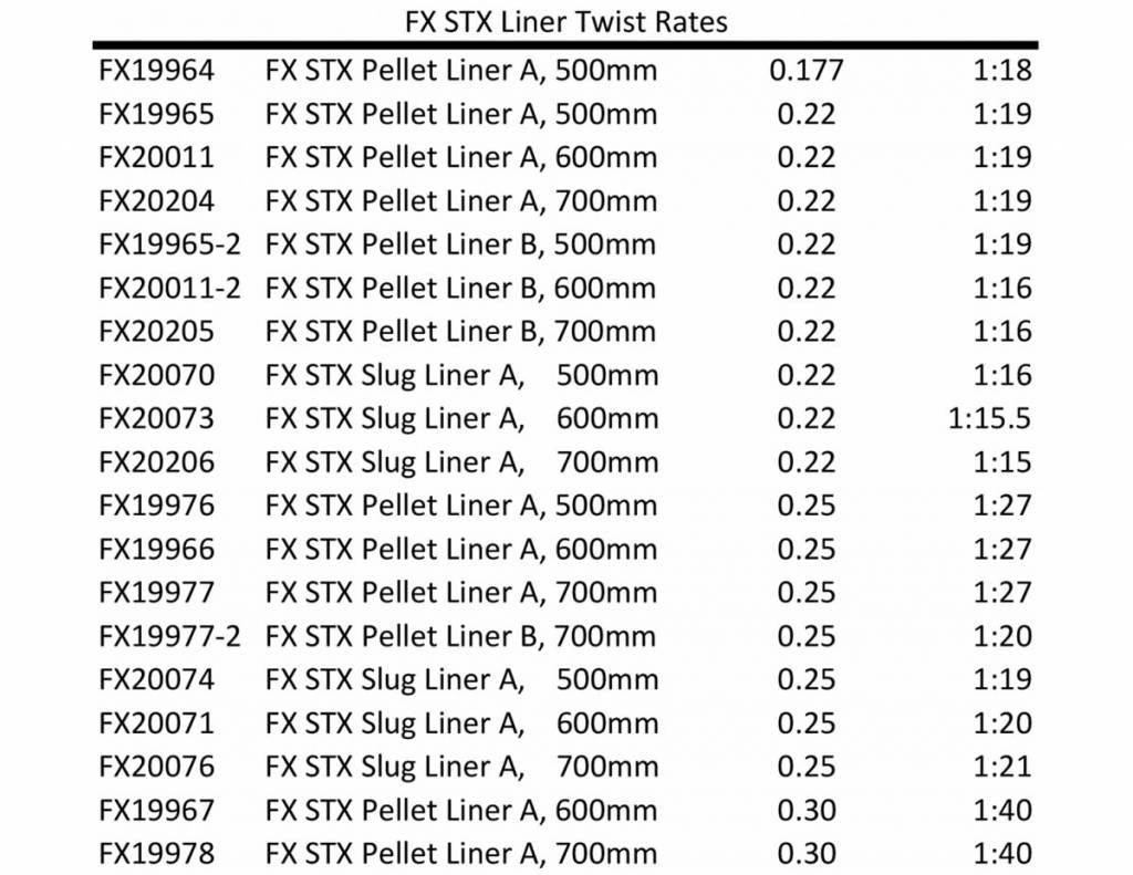

Correct me if I'm wrong but I thought the superior barrel in .25 caliber and 700mm length supposed to be 1:23? Is the liner I got just another STX pellet liner A? Did I get scammed or it is a superior liner but I am pretty sure it won't have the same twist rate as my old STX liner.

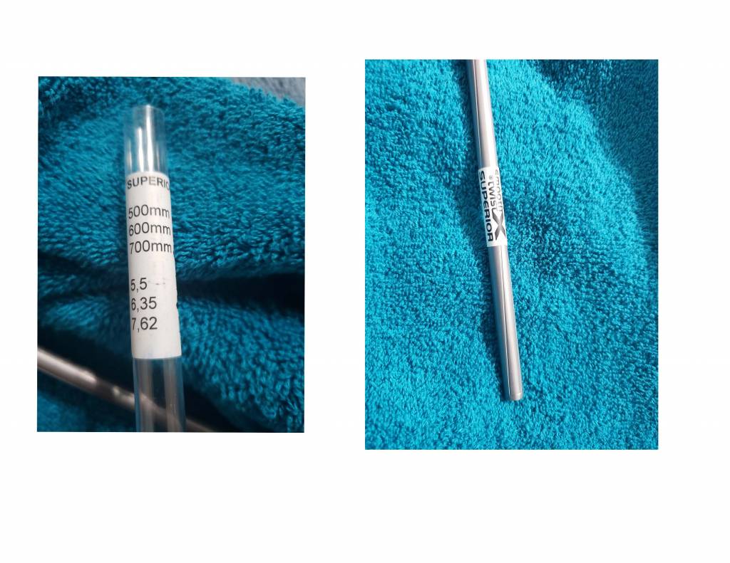

Does your sticker look like this?
Also, did the barrel come in a plastic sleeve to protect it from damage with a sticker that reads superior like this?
Thats how I received mine from a reputable dealer.
Yes sticker looks right and the tube is almost right except marked the wrong caliber.
Can someone with a real superior liner in .25 and 700mm confirm the twist rate?

So how much are each of these liners? Who has a FX20206 27.59906" 700mm .22 1:15 in stock? I wouldn't mind comparing that to my Condors 1:17.7 24" barrel. It's able to send 32 grain RBT Griffin slugs at 1040 quite easily. I just put a lighter factory hammer and weight in instead of the a Ginormous 115 gram no slap brass hammer.

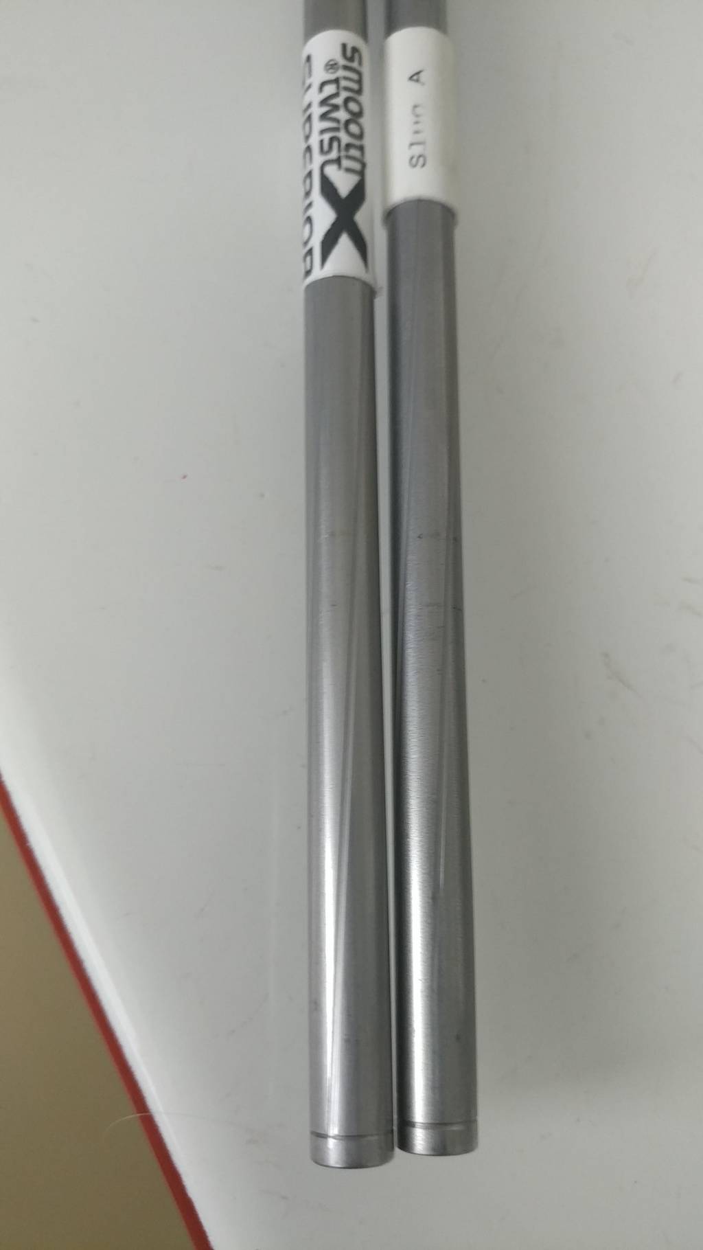

Measure the actual twist rate INSIDE the liner(use cleaning rod/wood dowel with tight-fitting patches). Sometimes the exterior twist lines aren't correct.
Always shoot the liners to judge them. 2 of the 4 STX liners I own didn't have the correct twist rate. One of them(not very accurate) was gladly and quickly replaced with liner which had the "listed" twist rate by company which advertise on AGN. The other was the best shooting pellet barrel I have ever owned, even though it is NOT the "listed" twist rate. All 3 of the Superior liners I own have the listed twist rate.
Below is a pic of the receiver end of a Superior STX next to a regular STX(slug A) liner. Notice how the exterior twist lines stop BEFORE reaching the breach end on the regular STX(slug A) liner. I don't know if all STX liners are like this or not, but it MAY be an indicator.
