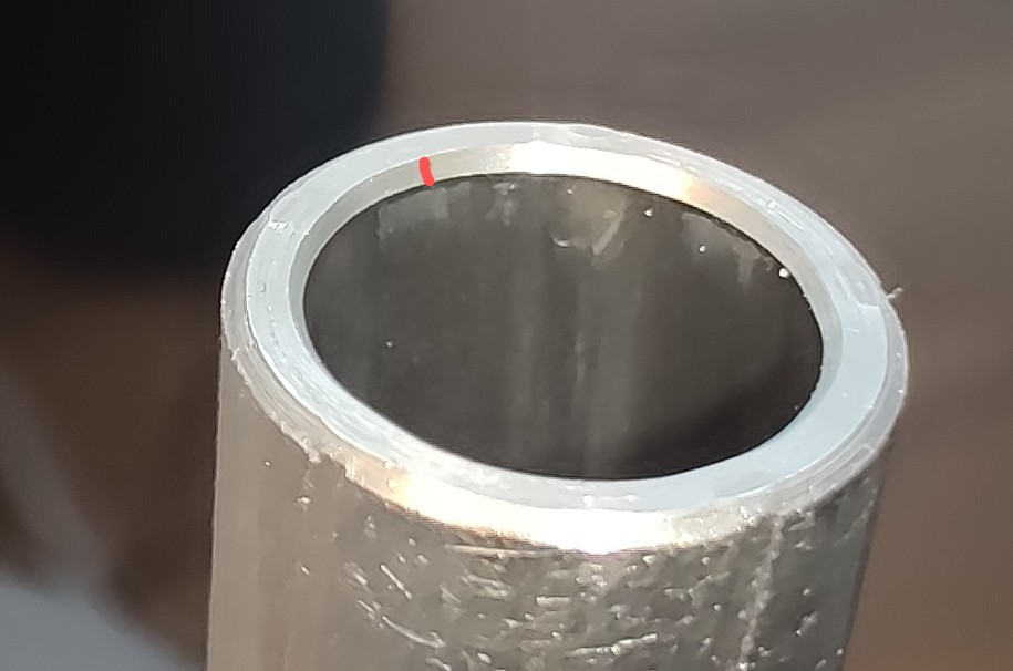

I also had the following liner:
This is the same liner rotated by 180 degrees. Look how uneven that crown was.

Another thing is bore consistency. I've never had a liner which had consistent diameter through the bore. The slug alwas goes tight, loose, then tight again and so on until it reaches the choke.
That's odd, too. Mine have been dead consistent. But I had pellet a, slug a, and a early superior.

I have 3 liners (2 Superior, 1 Heavy) and they all look like yours. I think what you are seeing is the lead in the "groove" not the lands. Although FX liners dont have traditional lands/grooves as you pointed out. At least thats how mine are, what looks like rifling is actually lead dust/residue. And they shoot well, so I guess Id say they are dont right. Are you having accuracy problems with yours?

I am positive the lead residue is on the lands. I have poor accuracy with them.

I have couple liners as well, last summer started crowning one by one, shoot each at 100 meters and I cannot confirm it was a difference in group sizes - crown or not to crown. This lead me to grab a jewellery lupe and look into the muzzzle end. All my liners - how they press in the rifling - the rifling ends before the end of the tube 3-4-5mm inside the hole...so the crown doesn't do nothing.
The lead-in I polished, I saw edges after the cutters and I blend them in with a hand drill and reshaped cowhide heads :) .
Firelapping or polishing makes a difference, crowning is not ... with my liners.
