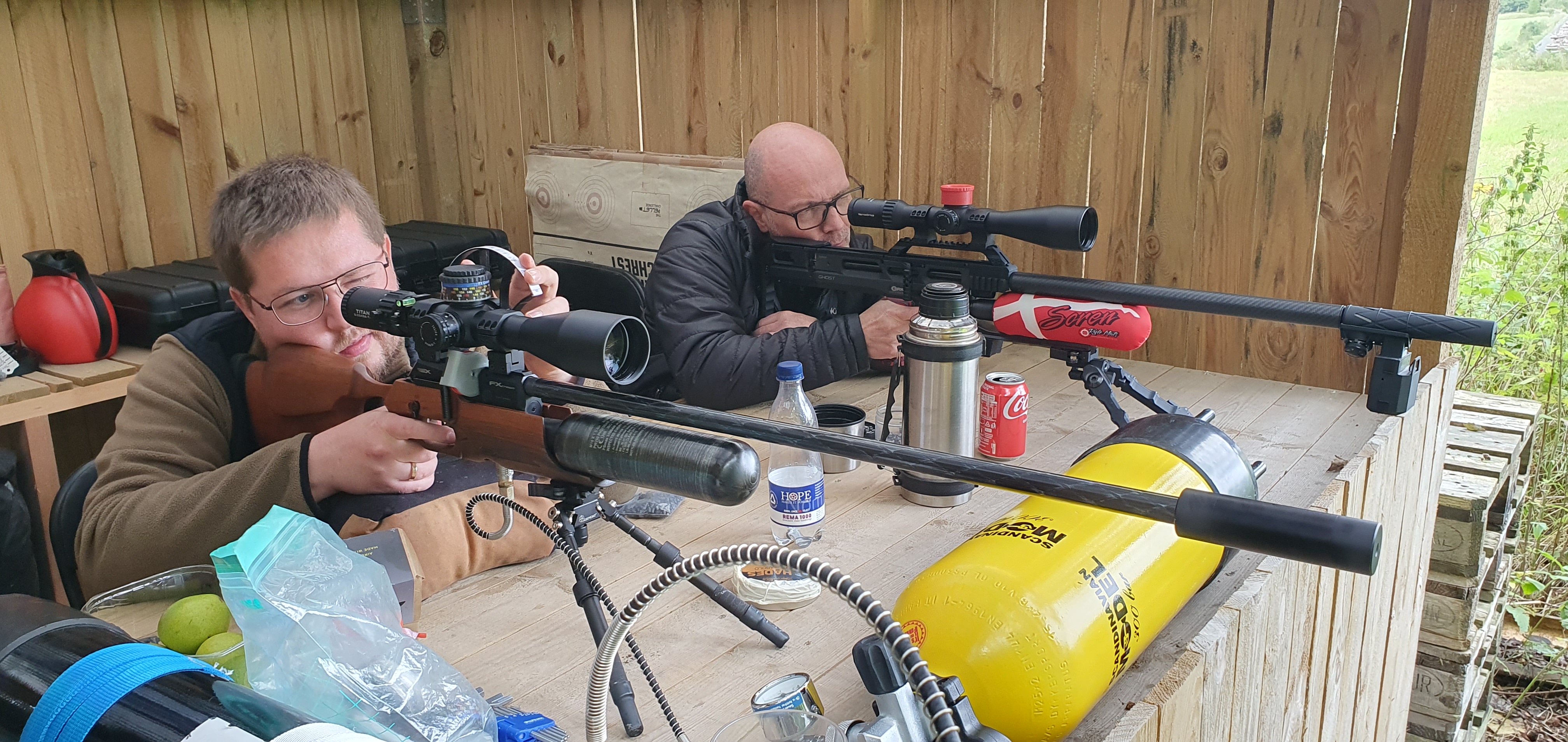

I have almost all Barrels from FX in 500, 600 and in 700 mm and the best compromise for me to my Crown is the 600 mm Superior Heavy.
The 700 mm Superior heavy DIY is long - very long but is needed to push Zan 16 gr. fast enough in my Crown.
Below foto: Here Is my friend Daniel enjoying my Crown with 700 Superior Heavy DIY barrel - Soren Drost in the background, is out shooting us (as always ;-)

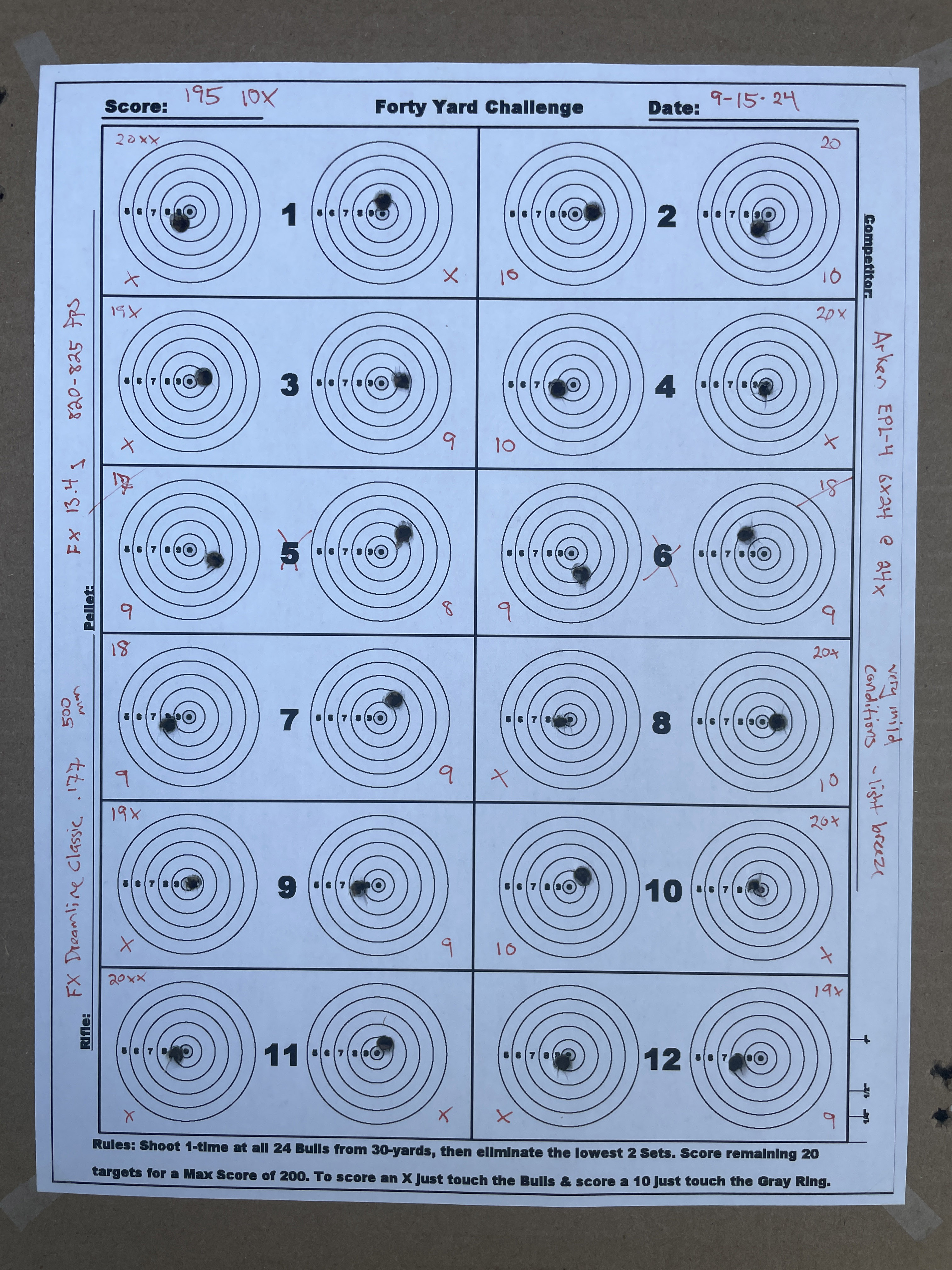

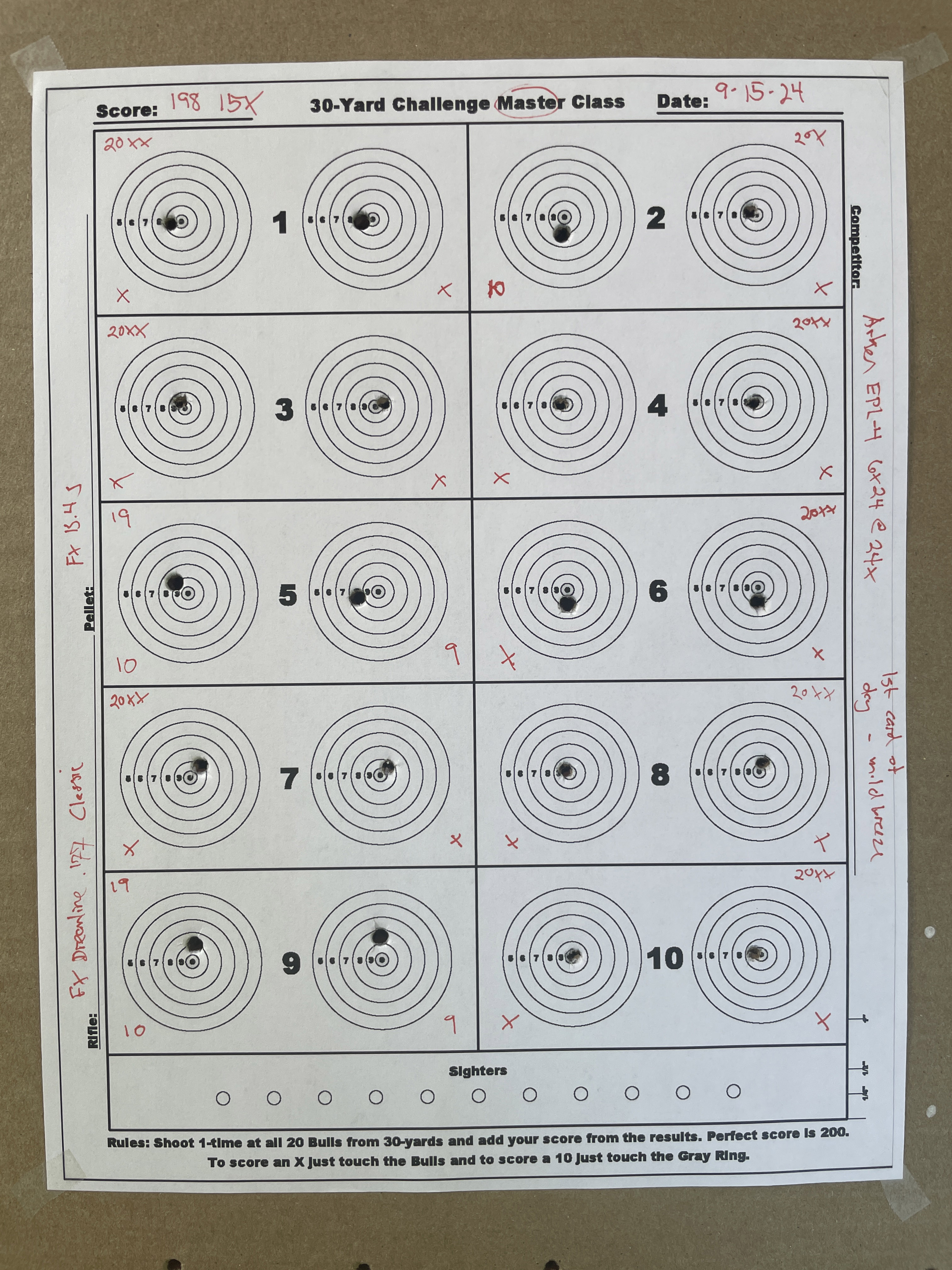

I’ve had great success with the standard STX superior liner in my Dreamline Classic.
It uses the 500mm superlight barrel configuration.
Attached are some precision target results at 30 and 40 yards with the 13.4g pellet.
The interesting thing about the 13.4g (as opposed to the 10.3g) is that it is most accurate at 780 to 840fps. It doesn’t do as well at higher speeds. It may have been developed for field target shooters that must stay below 20 ft/lbs - but that’s just a guess.
In any case, the data from the 30 and 40 yard Challenge here on AGN bears this out - shooters of a variety of different air rifles have found the sub 840fps gives best results. The 10.3g can deliver great accuracy even above 900fps.
Hope this helps regarding the 13.4g. I’ve never used the 16g. A fellow AGN target shooter tried the 16g at a variety of velocities in a RAW TM1000 - without much success - he eventually retuned the rifle for the 13.4g with much better results.
[edit: for reference, the 10-ring on these targets is .125 inches in diameter]
-Ed
