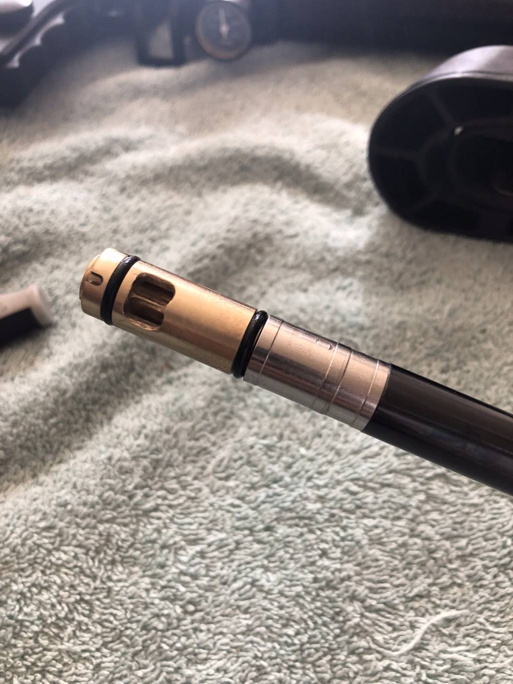

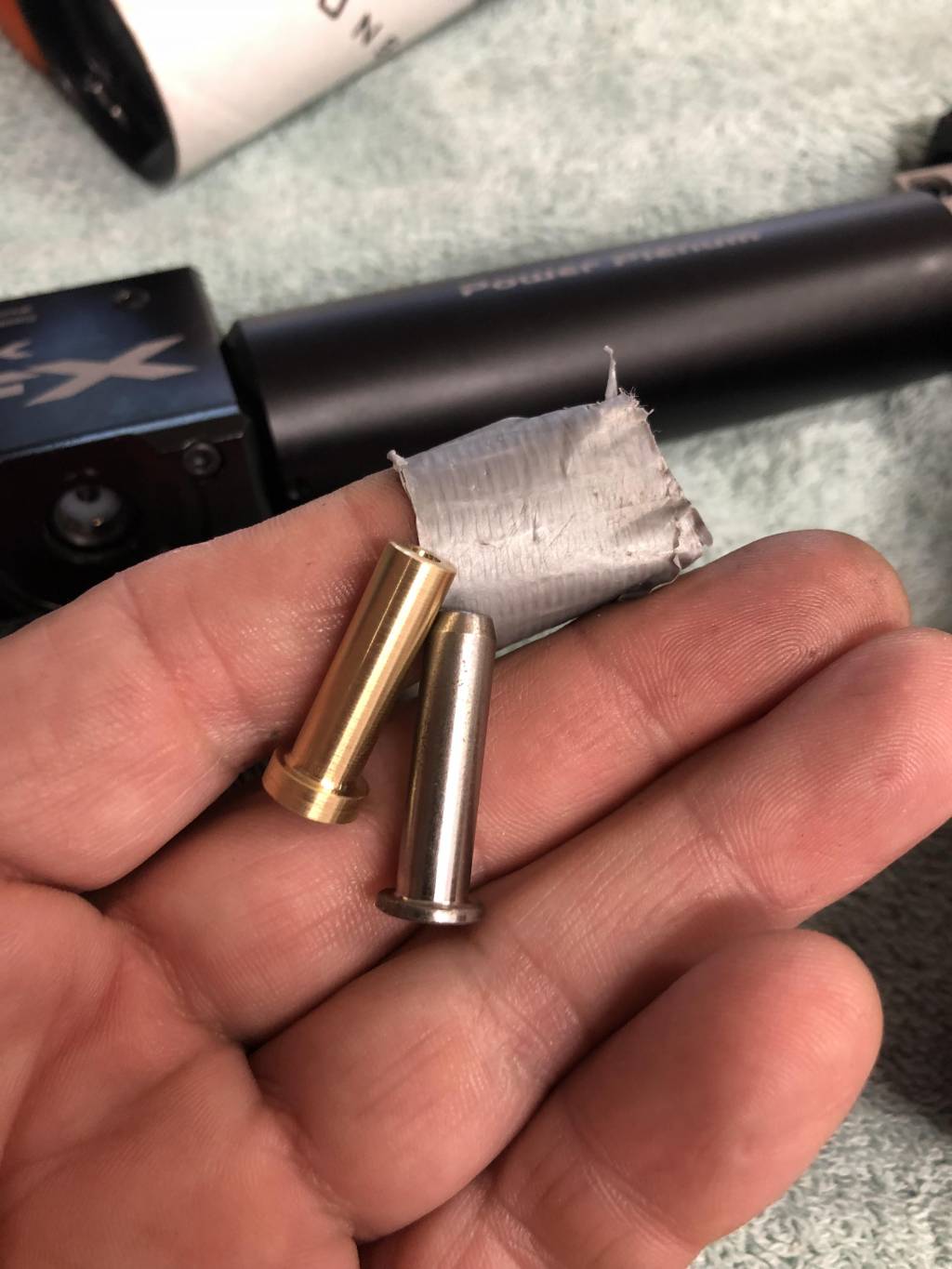

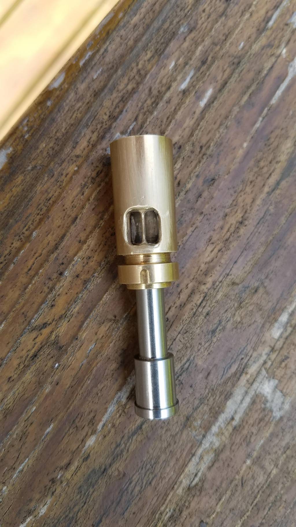

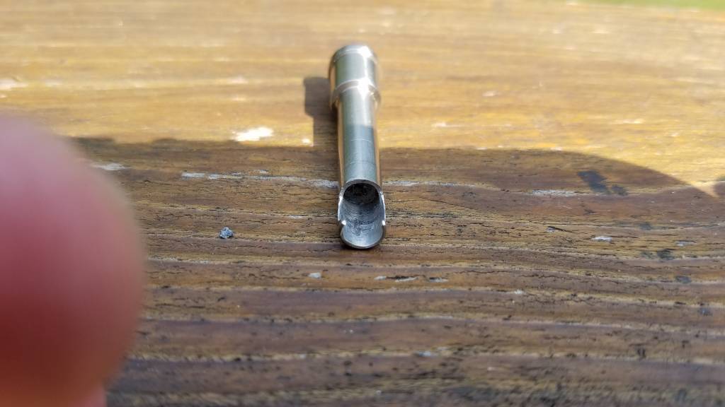

I got the .25 dual TP Huma modded along with the OEM probe. It looks good to me as far as flow path. I didn't like the air crashing in to the top of pellet ring, so I cut off a
part of that section. I believe this should get me a little more over stock. Will be testing this and the dual valve spring setup soon. I am planning on filling in the small recessed part of the probe as well
The Huma dual port by itself had no improvement on my 22 cal Dreamline Classic. The ones they are shipping now are wider than the one shown by spyde82. In fact, it looks more like his modified one.
I just received two Huma ports yesterday from Trenier Outdoors. They may be from old stock as they don't look as wide as the pictured mod or even close to that.
The one thing I do like about these Huma dual TP ports is that the O-ring groove must be shallower as the probe fits more snug. The OEM probe and port is very loose together. I just replaced the breech seal 100 shots back or so. I don't see now how air is not getting past the loose probe. It's been pushing 70 FPE in .25 cal, so not too terrible. I think the Huma will be better with the tighter tolerances.
Just be sure it's not too tight. I recall reading a few slipped by that were tight enough to deform the pellet skirts on chambering.

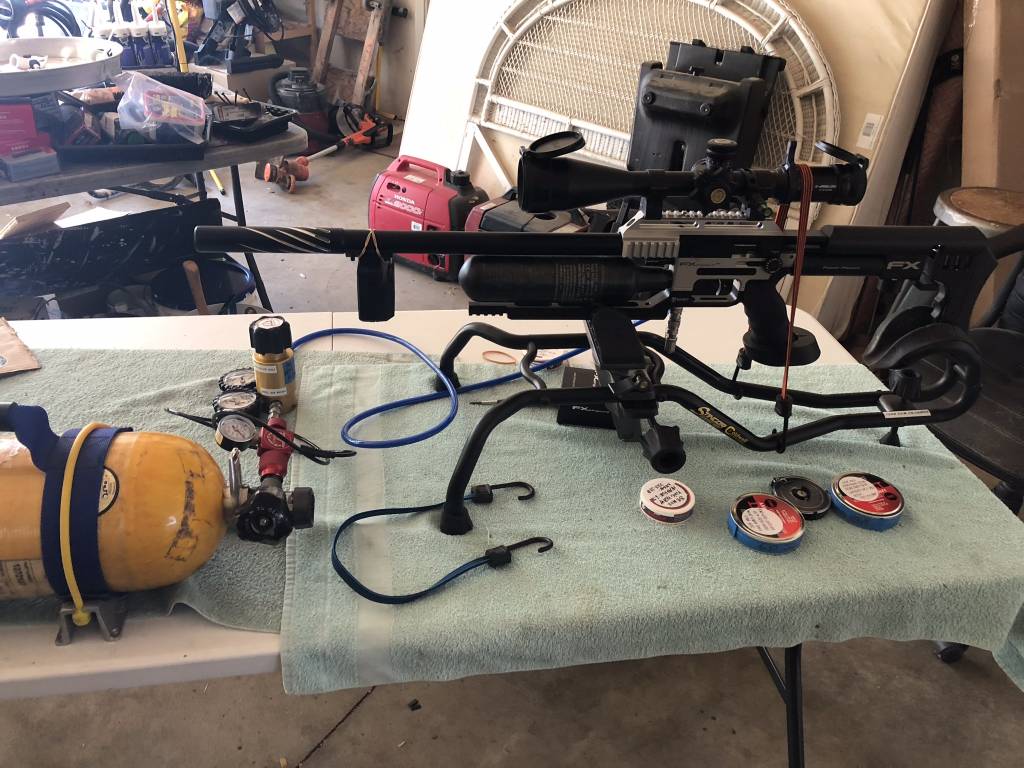

I have the Impact back together now. Can't tell much until I get it over the chrono, but it's still shooting very strong and on point.

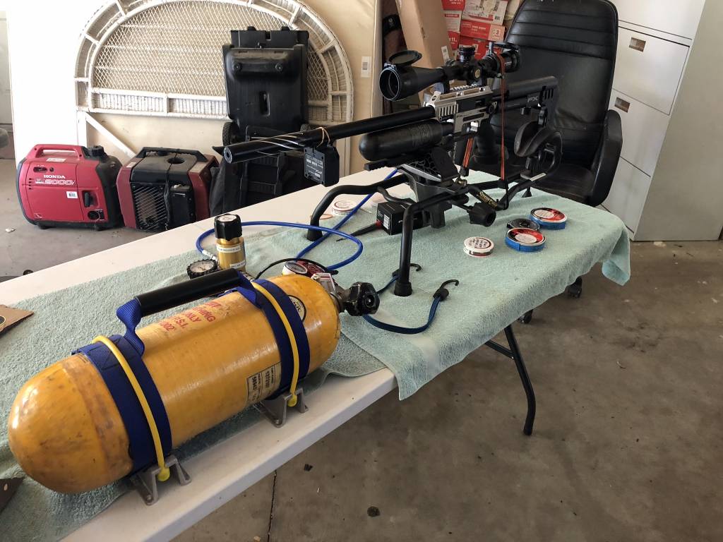

I just took eight shots over the chrono. Boy is is hot out there. I got a high of 950 and a low of 947 for the eight shots. I had it tuned to 900 FPS with the 34gr JSB MKIIs before these two mods and I didn't touch any tuning screws.
I would say the mods are a success so far. I have maintained the typical 3 FPS ES and gained 60 FPS with adding the power plenum and another 50 FPS with these two mods. I do have to fine tune it now. The PW is currently set on minimum.

This is with the reg set at 135 bar (1950 psi). I have no idea yet just how low I can go. It really likes the JSB MKIIs at 900 FPS.
All of this is in preparation for the .30 cal gun I actually bought. Working with the .25 cal gets me setup and familiar with the gun at a cheaper cost. I'll be switching back to .30 caliber and fine tuning eventually before hunting trips. I really don't know how much power I have just yet, but I can say it's a lot for an Impact.
