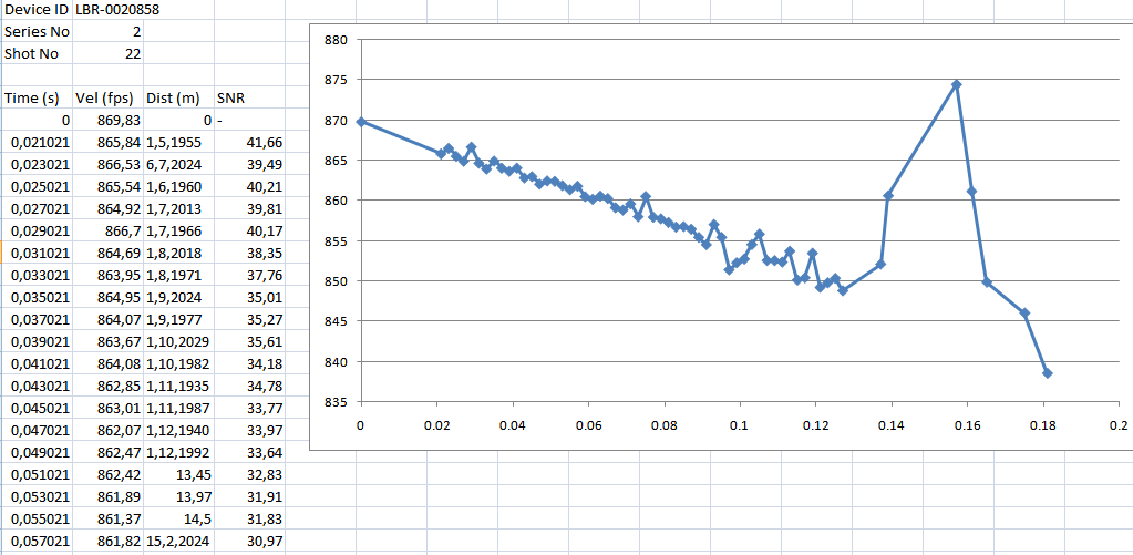

Thanks Michael, good data. I've been using mine for quite a while now, and always set it up when I'm shooting bench. I've found a few items from testing.I spoke with Johan about this. It is true that in your scenario much of the results you are seeing are calculated. Here's some more information to help everyone understand this:
Cheers
- When setup properly the doppler radar will take hundreds of readings throughout the flight of the projectile (the 1st reading is taken after 10-15 yards).
- Currently the most accurate readings are at 150y or less.
- If you notice at the top of the display you see 1/5, 2/5, 3/5. This refers to how well of a reading was taken. 1/5 and 2/5 are really bad and chances are you're getting more calculations than raw data. 3/5 is better, but obviously 4/5 and 5/5 would be best. The raw doppler data can be improved by minimizing interference and properly placing the chronograph in line with the path of the projectile.
- A new feature is in beta testing that will allow the end user to decipher between the actual doppler data and the calculated data. This will become available as a free firmware download in the near future.

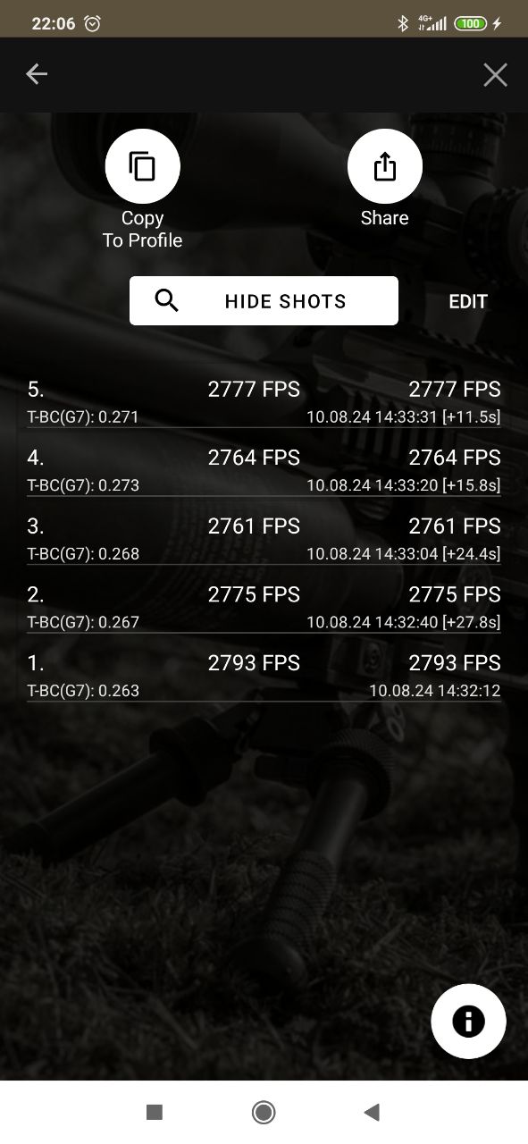

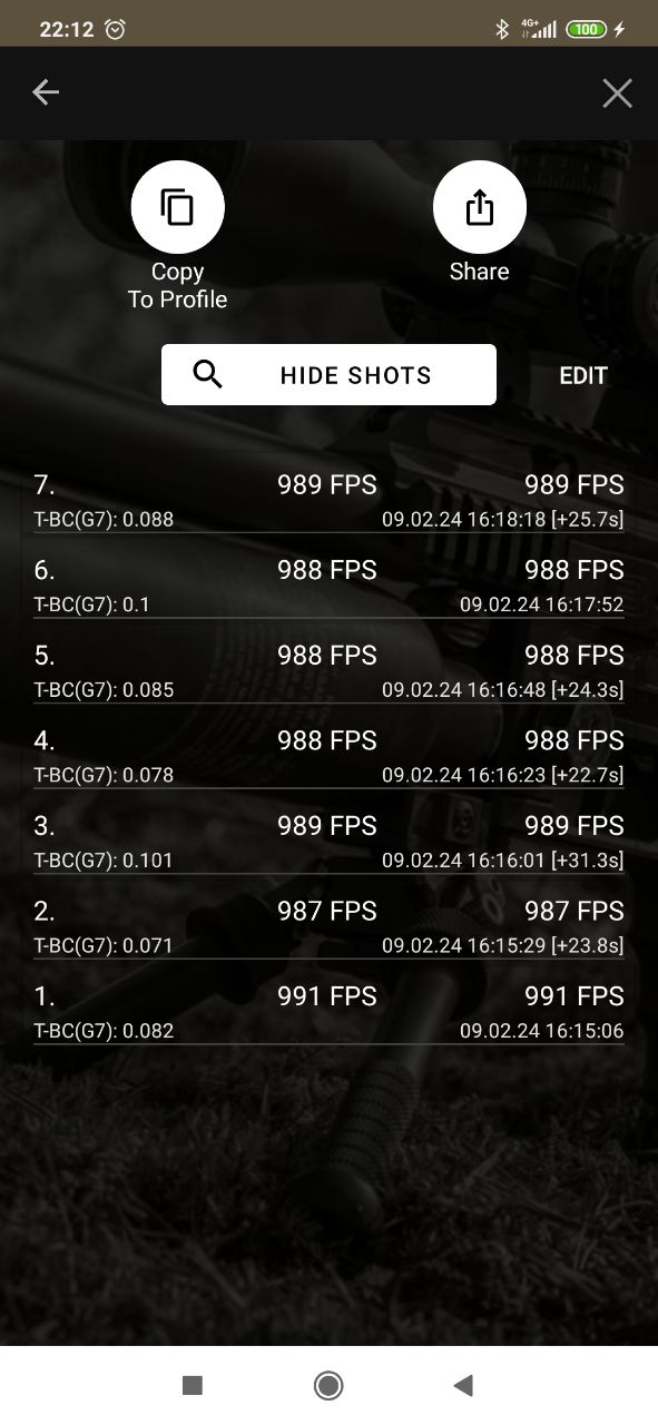

1. When shooting at "just" 50 yards, the BC will be different than when shooting at 100 yards. It is USUALLY higher when it gets to measure additional data points.
2. I set my distances to 20, 45, 70, and 95 yards. This way at 100 yards, I get the muzzle velocity plus 4 data points. Even when shooting 50 yards, the machine uses 2 data points plus muzzle. If its set like some of the above at 100, 150, 200, and 300, you're not getting the benefit of using multiple data points and only getting muzzle and maybe 100 yards. It's pointless to set it up at farther than 100 yards.
3. MOST of the standard slugs will benefit from using the RA4 profile vice the G1. For boat tails, using the G7 profile will get your most accurate data. Don't let your ego affect your choice, since G1 will give you a higher number!
I appreciate the information of x/5 at the top, I always wondered what that was for...
